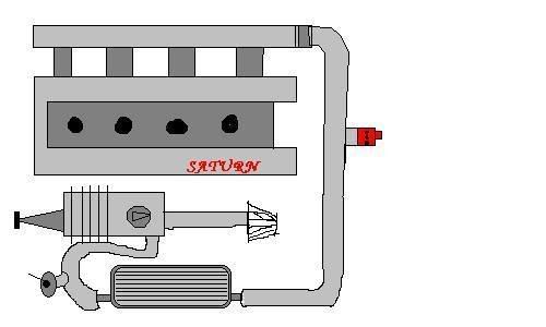

      Concept Drawing

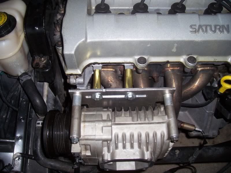

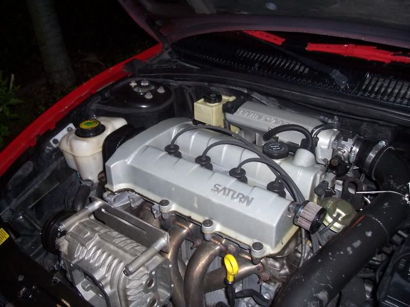

      mounting the supercharger for the first time to check for clearance

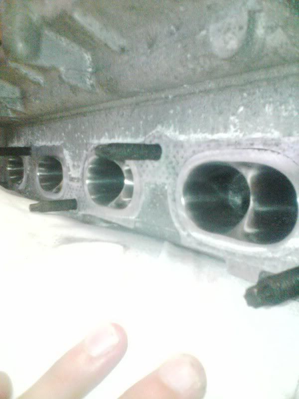

      Cylinder Head done

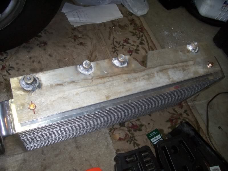

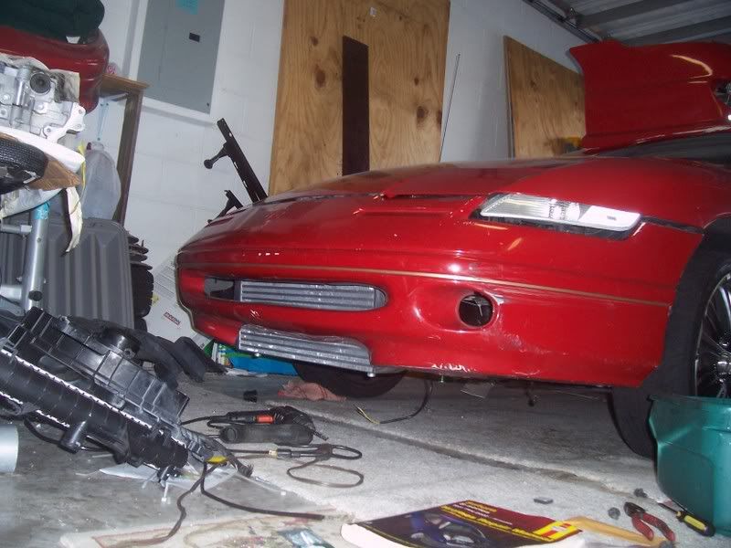

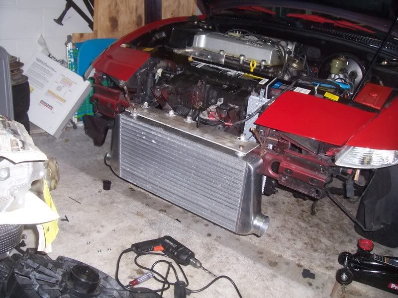

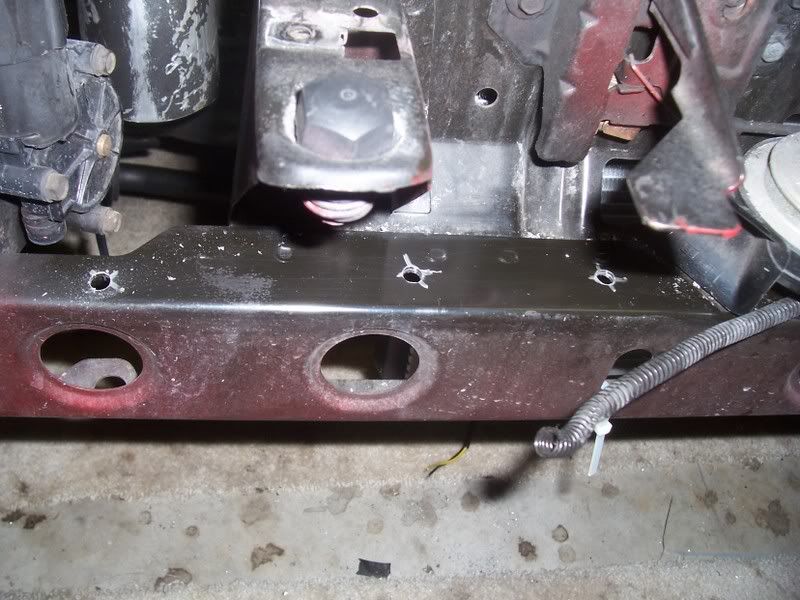

        Well yesterday i got some progress out of my saturn. A few days ago i made a fake braket out of cardbaord for the intercooler. so i can take it to a machine shop and have them make it out of metal. This is what i got and it worked out perfect.
        I had to drill holes on my frame where the holes on the metal bracket was.
        nice, it bolted on perfectly (thanks to the nice people of ACE hardware store for being so helpful and helping me find all the bolts.)

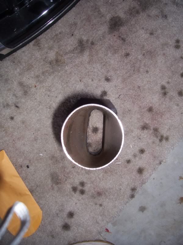

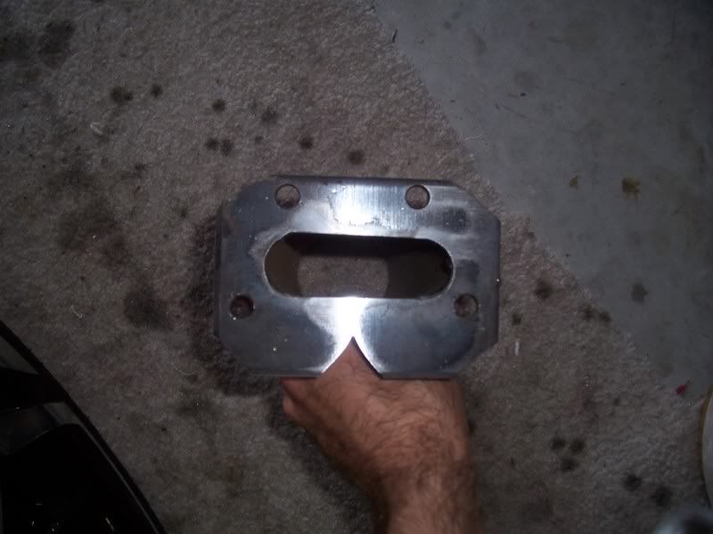

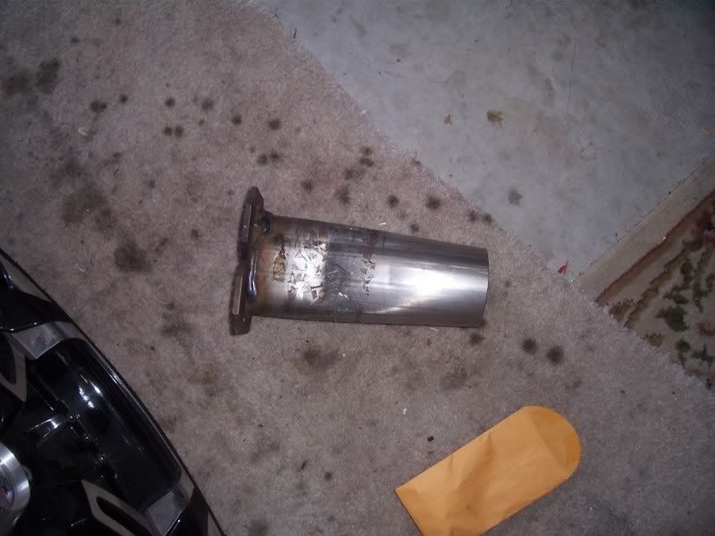

        I also Redid the flanges fot the inlet. Really ugly but the best for flowing i could of gotten made.
        Its a pipe bent at the tip so that i can run regular pipes instead of looking for oval pipes. the inlet on the supercharger is a wierd oval shape so this was the best route to go with. (took the idea from the sixthsphere members.)

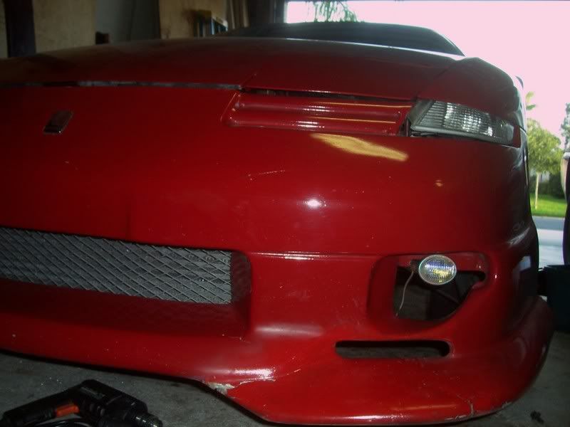

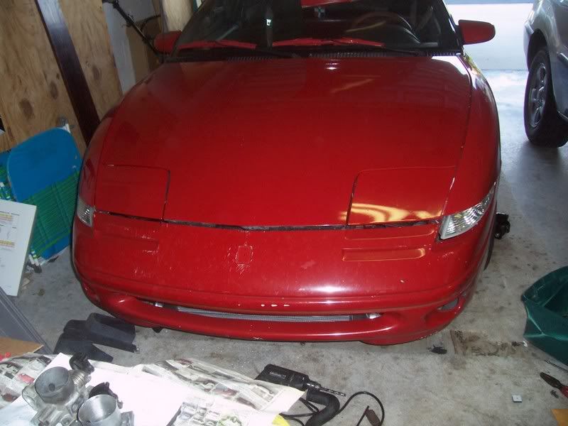

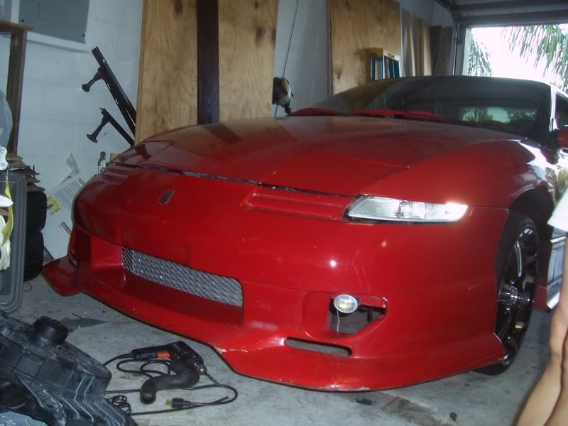

        so putting the bumpers back on was pretty easy (not completly bolted on)
        Preped for Track

          Yay got the header after getting rained on by floridas stupid weather at the junkyard.
          also wrapped it. going to get painted tomorrow when it dries up.
          will edit post instead of reposting
          <br />tool:
            I know have the intake manifold ported, turbo cams, clevite lifters, 98 valve springs, ported head, wrapped headers, and supercharger mounted.

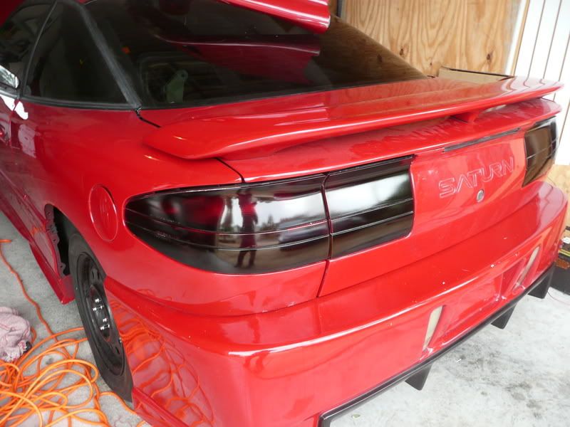

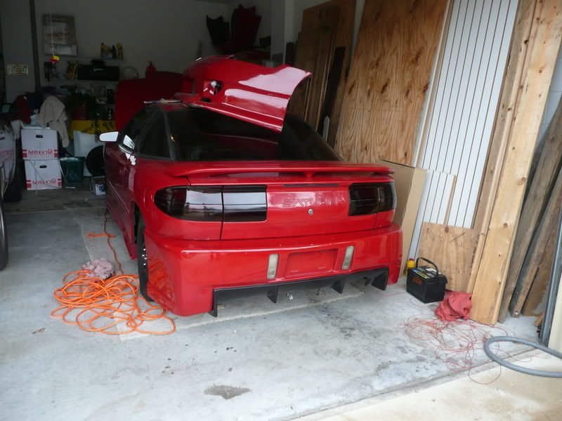

              Re: Geo's Hot Wheel

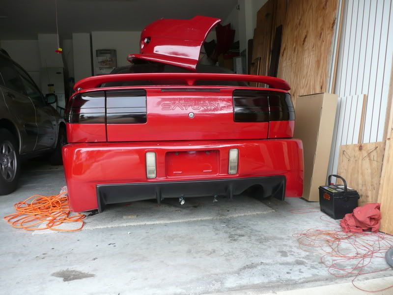

              diy tinted taillights and black diffuser lol.

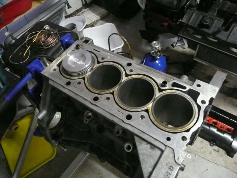

              block bored 20 over with rings and pistons

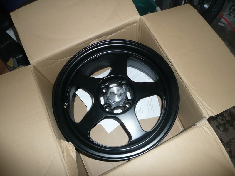

              New rims
              <br />tool:
                Re: Geo's Hot Wheel
                i like alot! looks good! dig what you did with the black and red on the back bumper.
