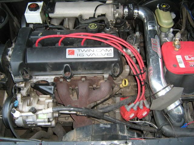

    Current Mods on car:
    99 DOHC (I only consider this a mod because it runs alot better than the 98 engine ever did)
    MSD DIS 2 Ignition w/ cam sync generator
    MSD Coils w/ interface modules
    MSD 8.5 mm Plug wires
    AEM Cold Air Intake
    Centerforce Dual Friction clutch

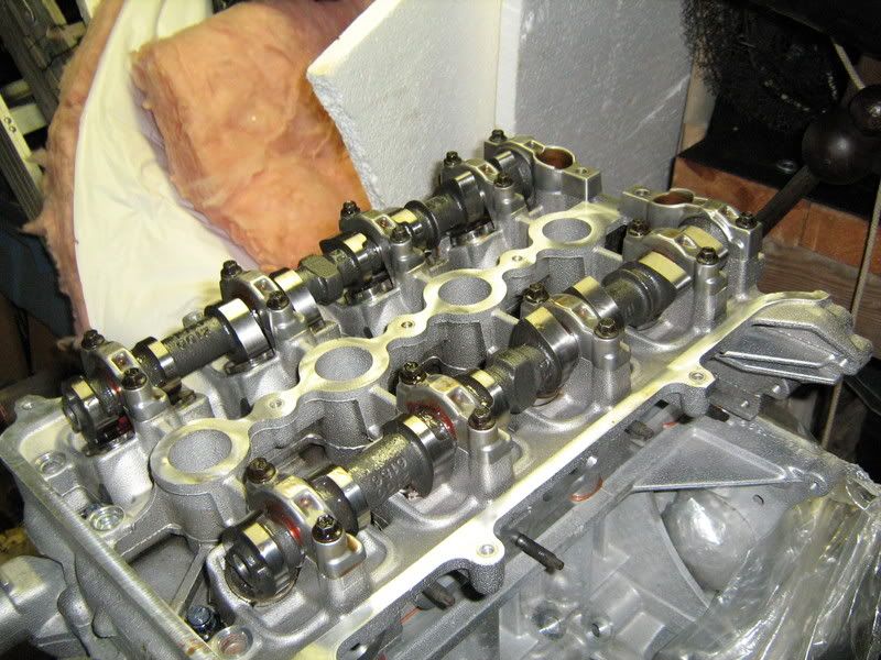

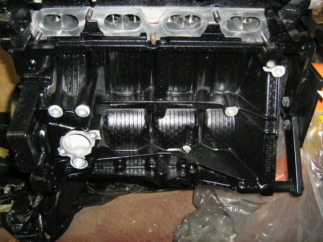

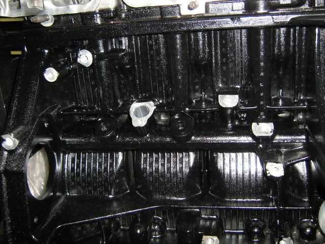

    Well I've had the motor back for a couple weeks now but have been busy working on the vehicles, all three were down at one point (how the fuck does that happen?!?!) so I haven't had much time to work on it. Heres a few pics:
    I still need to get a timing kit for it before I do anything else to it. The Stealership is crazy if they expect me to pay $380.00 for a fucking kit when I can buy the parts individually for not even half that price, dumb asses. I might paint the block while I'm waiting for funds to finish it.

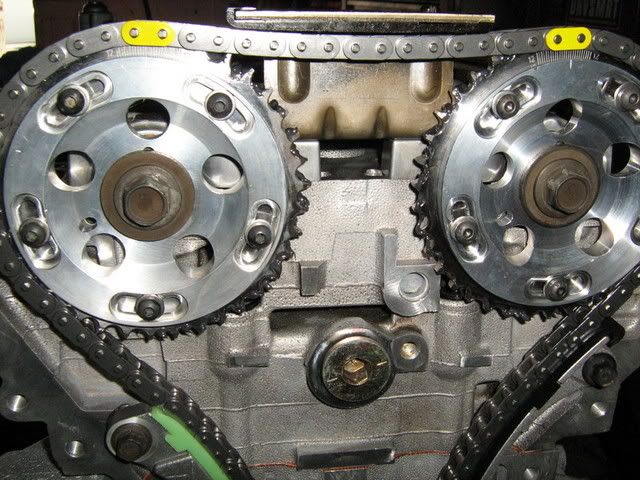

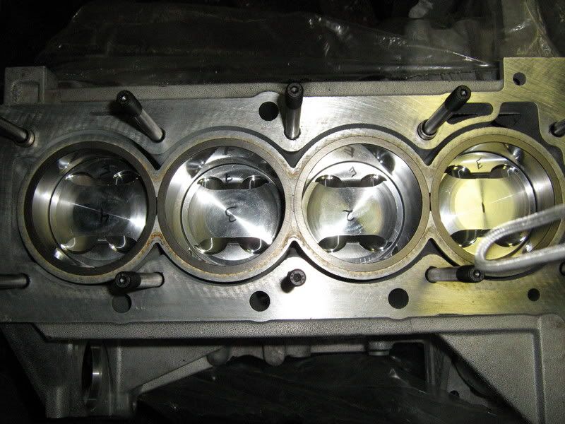

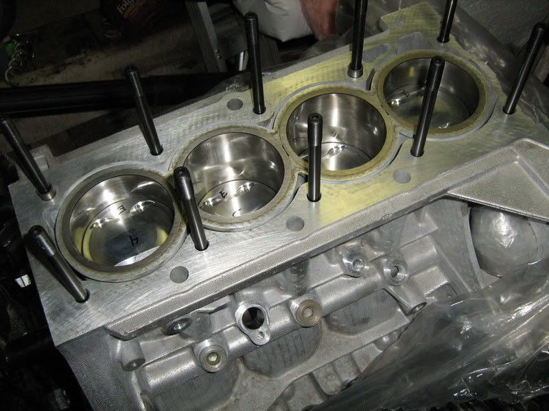

      well it's coming along great. At the last minute I decided to go with adjustable cam gears. Here's some pics.
      I wanted to paint it Flat black but the parts store was out and I didn't feel like waiting. It'll probably dull out alittle once it gets hot.
