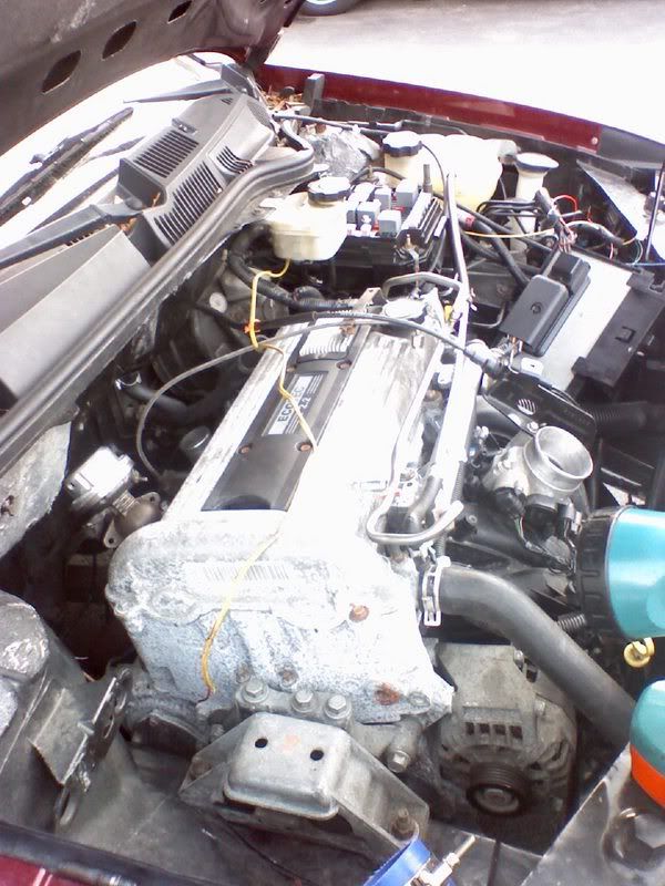

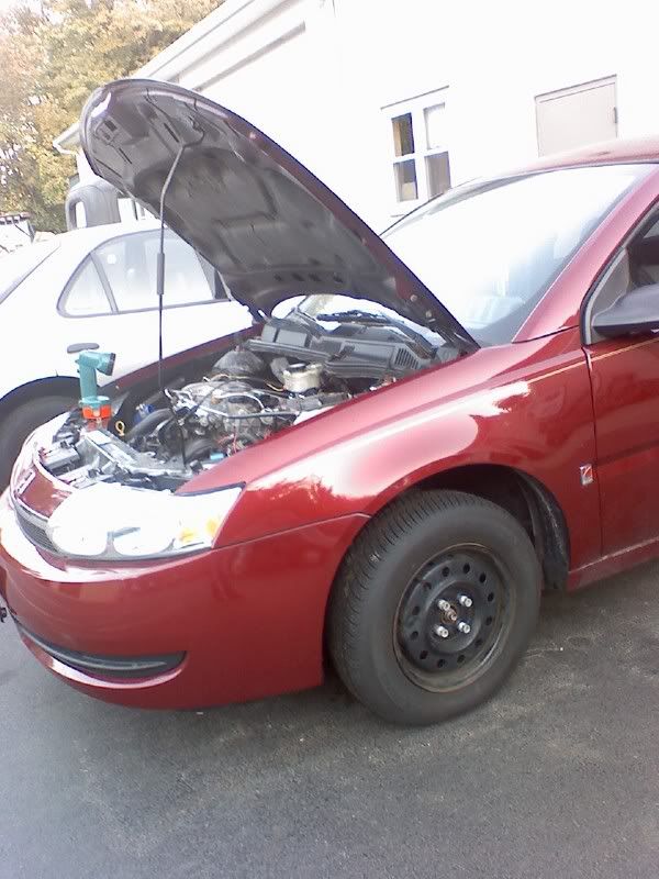

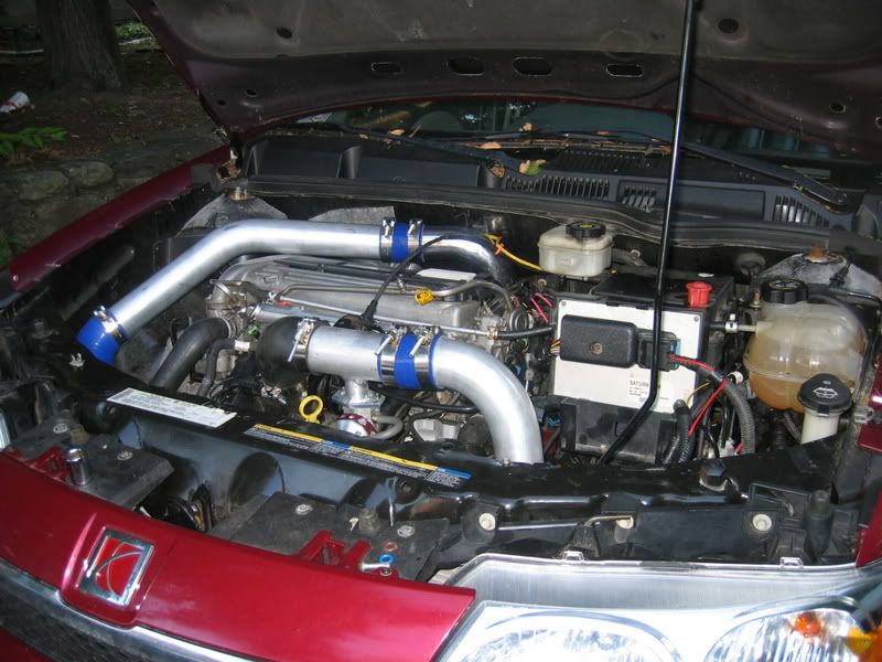

    First Turbo Build with SixthSphere Member Jeremy (Summer 2006)
    Details:

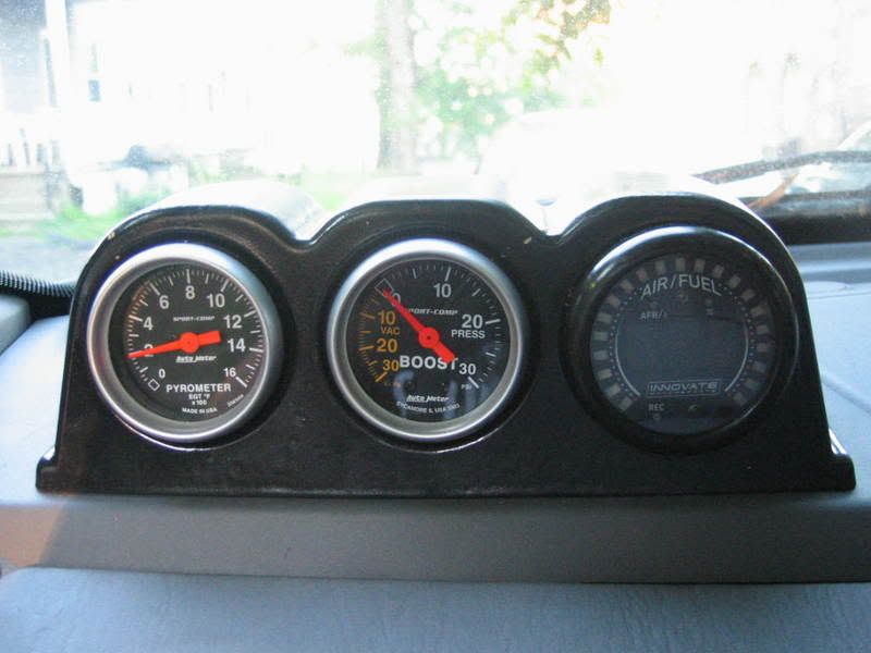

    • MegaSquirt 1 V3.0 Used as an Extra Injector Controller
      WRX Turbo with 5psi Spring
      Turbonetics Wastegate (Evolution)
      1g DSM Blow Off Valve

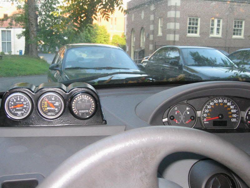

      Mechanical Boost / Vac Gauge
      Innovative LC-1 Wideband O2.

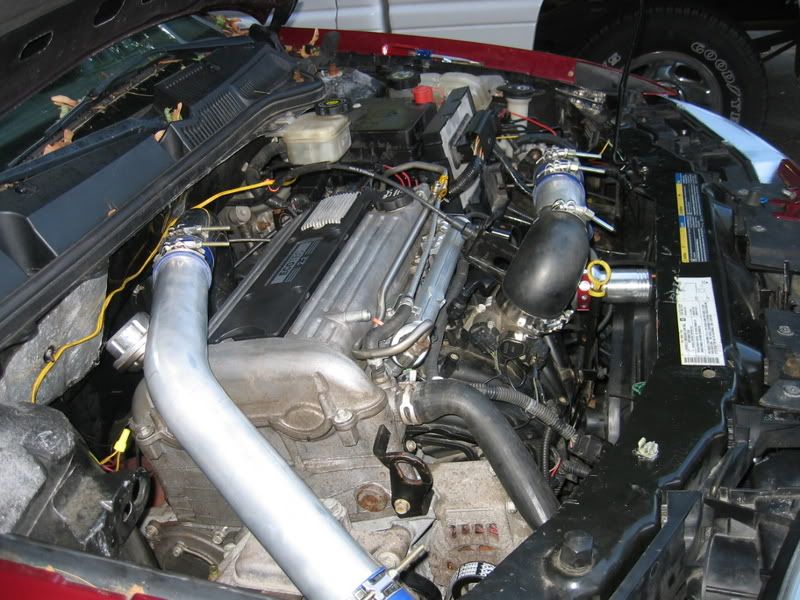

    Winter 2007 Forged Engine Build with d3ad1yspork
    ..lol lens cap
    Details:
    • Wiseco 8.9:1 c/r .020 Overbore Pistons
      Eagle Rods
      Clevite Main + Rod Bearings
      Block Bored out
      Crank + Flywheel Balaced

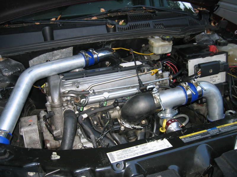

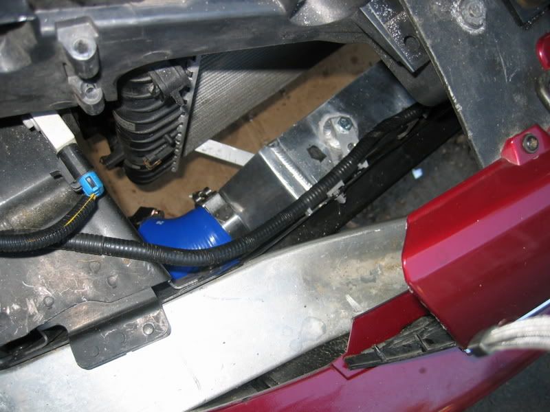

      Complete 2.5" I/c Piping with beaded pipes and T-Bolt Clamps

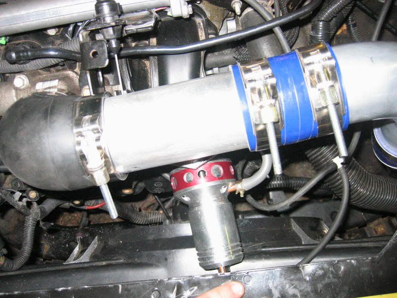

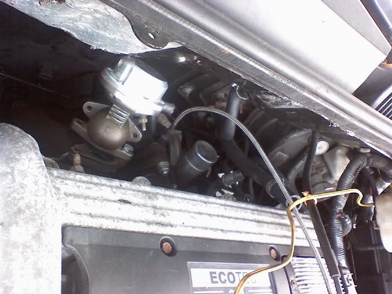

      Legit Apexi Twin Chamber Blow off Valve (Straight from japan lol)
      MegaSquirt II PCB v3.0
      Ford EDIS-4 (Need to get trigger wheel)
      Innovative LC-1 w/ XD-16 Wideband O2
      Autometer EGT Gauge

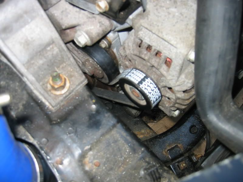

      Removed A/C (Complete Assembly)

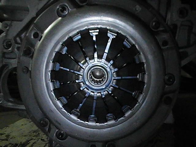

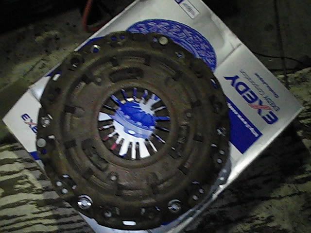

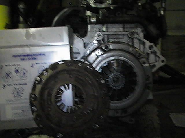

      Exedy Organic Clutch w/ Pressure Plate

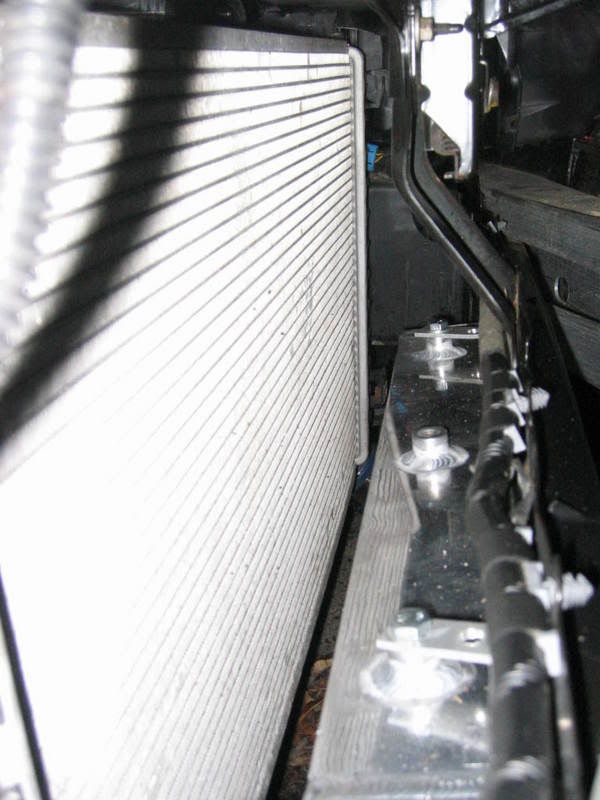

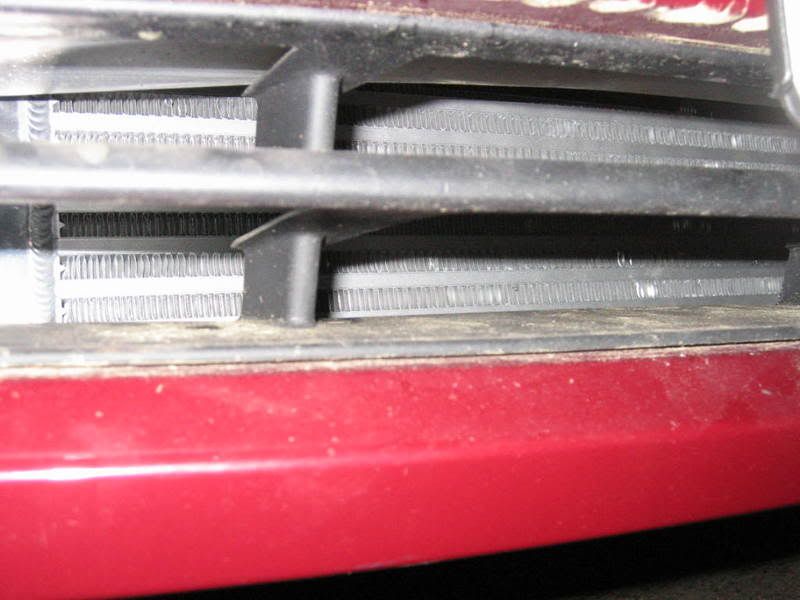

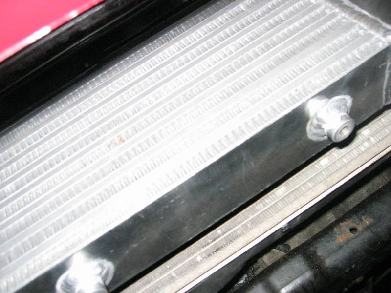

      2.5" Cxracing.com Bar and Plate Intercooler
      Cxracing.com 2.5" Pipes w/ Beads
      2.5-2.75" T-Bolt Clamps
      WRX Turbo
      9 PSI Spring (Turbonetics Evolution)

      Updates
        Update
        it runs [img]{SMILIES_PATH}/biggrin.gif[/img]
        pulls -20 in/hg of vacuum
          Update:

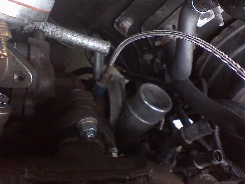

          New engine is in... shop is still doing minor things
          had to rethread the wastegate holes @ 8mm..need 1 more bolt
            car runs and drives now.
            the BOV is LOUD [img]{SMILIES_PATH}/biggrin.gif[/img]
