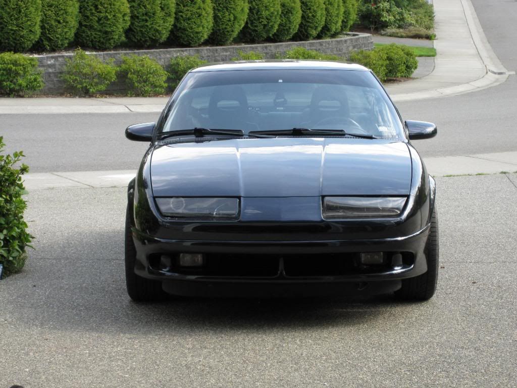

    ok wow i cant beleive i havent done this yet. lol/ ill start as long ago as i cann.
    i didnt get many pics of it when i first got it because i didnt like the car at all. basically got it for $200 blown motor did a rebuild on it and i then had a running car. yay. it had 102,500 miles on it and has some steelies and had been sitting for 2 years in a field.
    first mod lmao!
    next wheels
    better

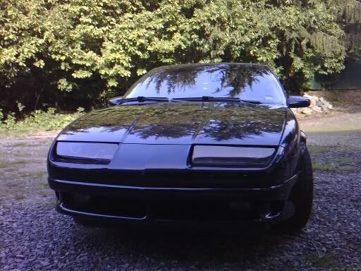

    tinted windows
    ebay cai and sda tam

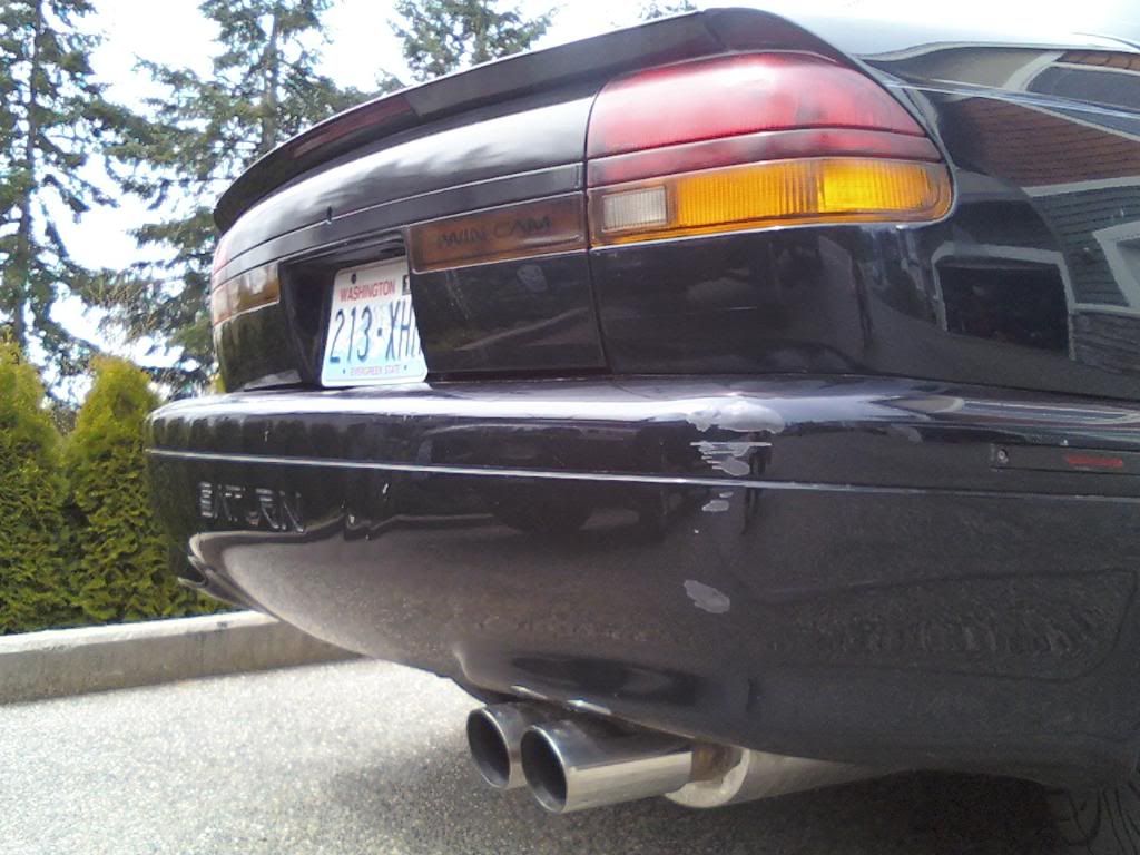

    photoshoot new exhaust and tinted tails
    blew the diff pin out so time for new trranny
    took it apart and welded the diff pin this time.

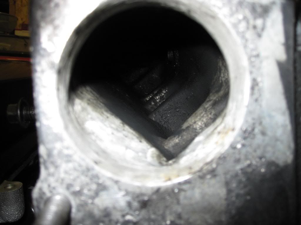

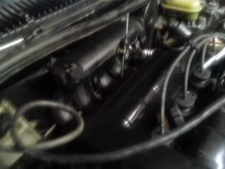

    Ported and Polished intake manifold matched with GSI tb install.
    All finished and cleaned up
    Just some pics right after i got those things done.

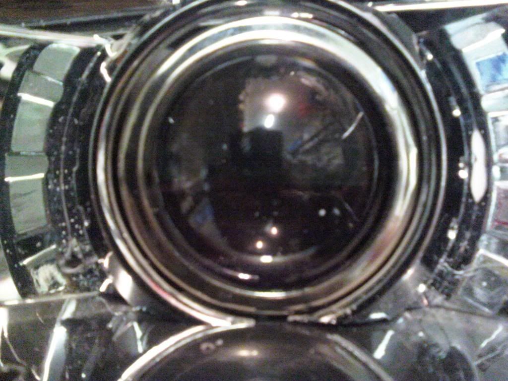

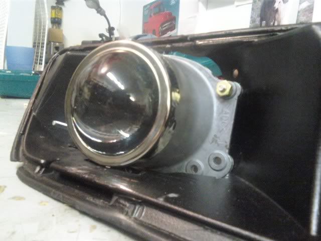

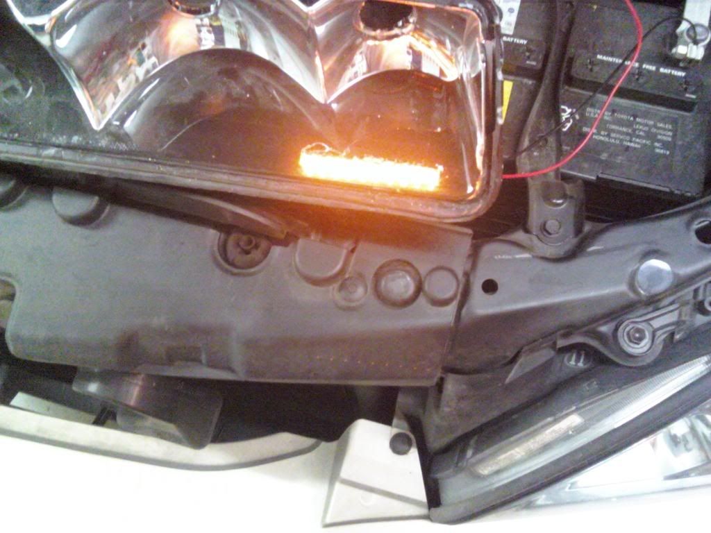

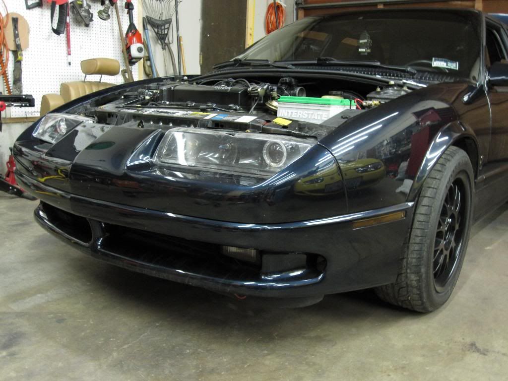

    Started on the headlights.
    Suspension

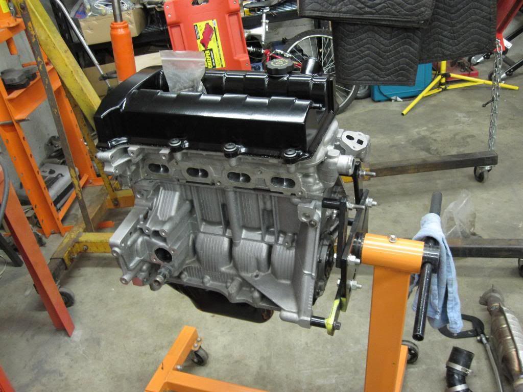

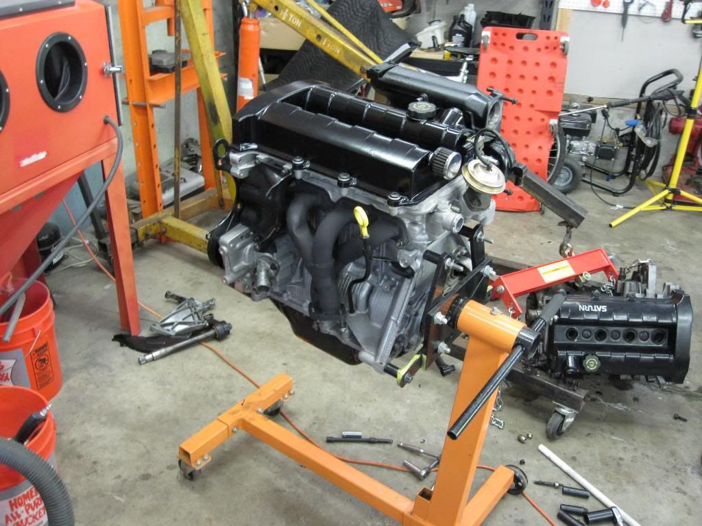

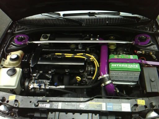

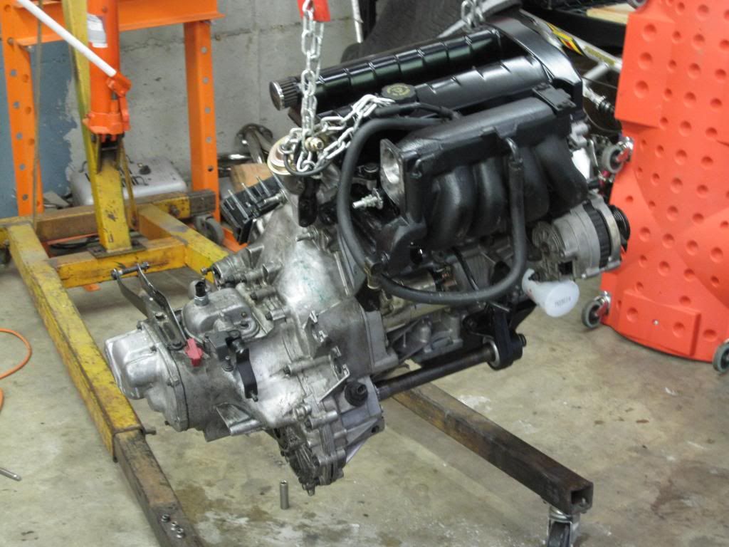

          Re: Sean's 1994 sl2 build... update5/19, new motor

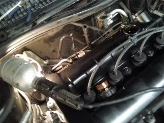

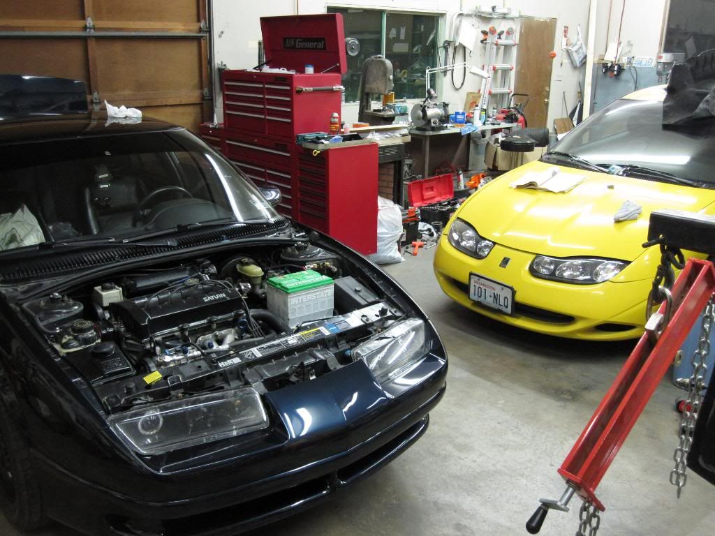

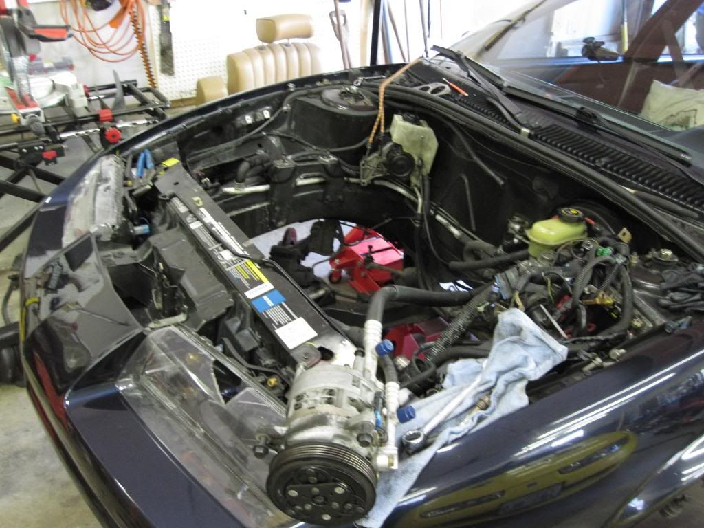

          So i got the new motor put in this weekend, ran into a few slight problems but for the extent of modifications to the motor the car is taking it quite well.
          List of mods to new engine:
          93 block
          93 head P&P
          Flat faced valves
          95 crank -.010 undersize
          99+ rods,
          Sealed power soch pistons
          Ngk v-power bkr7e plugs
          98 valve springs
          SDA Power cams
          11:1 compression.
          P&P intake maniflod
          GSI throttle body

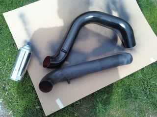

          Ebay cai powder coated
          custom valve cover powder coated
          92 header
          PICS!!!!!
          a picture of kieth who helped me along the way.
          and a video to see how it idles, and just testing the video quality on my camera...
          enjoy guys, feel free to post comments

                    Were can i get some of those lenses. I really want a pair
                    SEE POST http://www.sixthsphere.com/forum/showthread.php/22537-Custom-intake-manifold?p=400598&viewfull=1#post400598
