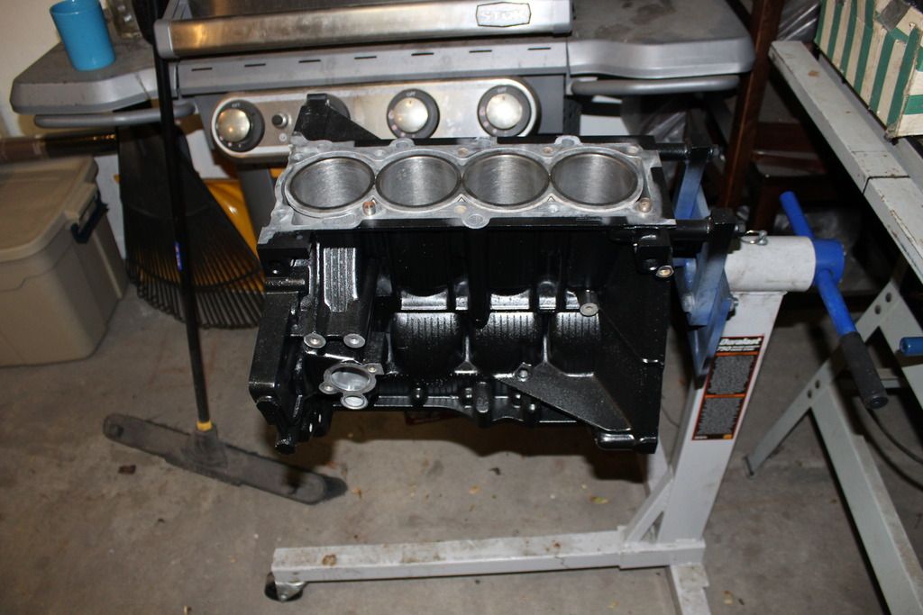

    And here's the block up on the stand

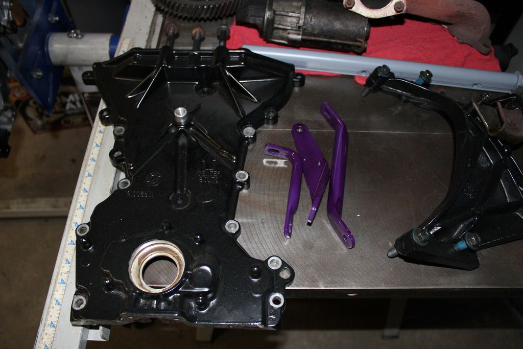

    Here are all the goodies

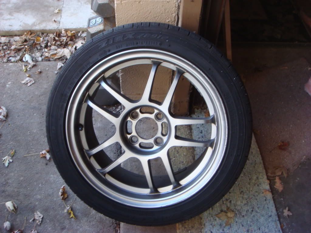

        also, just found a pretty sweet deal on some rota sub-zeros that i am going to be picking up tomorrow. two have slight curb rash and two have half tread, but dummy didn't have his car aligned so two of the tires wore improperly. not all is bad though, they are falken ze912s so i cant be sad. going to be respraying these wheels either a matte black or gunmetal. bronze crossed my mind but not sure how it'd look with the saturn gold. anyway here is a picture of the wheels

          I think those wheels would look good in gunmetal. I'm a 1st gen fan and the 1st gen wagons are definitely the best looking wagon that Saturn made IMO. Looking good

              i was thinking the same thing. gunmetal wheels seem to look good on gold 1st gens. so i will be starting to refinish these when i get the time. i only like the first gen wagons though, i think the second gen when they switched the rear doors to a rounded edge made the thing look like a bubble. box-car FTW.

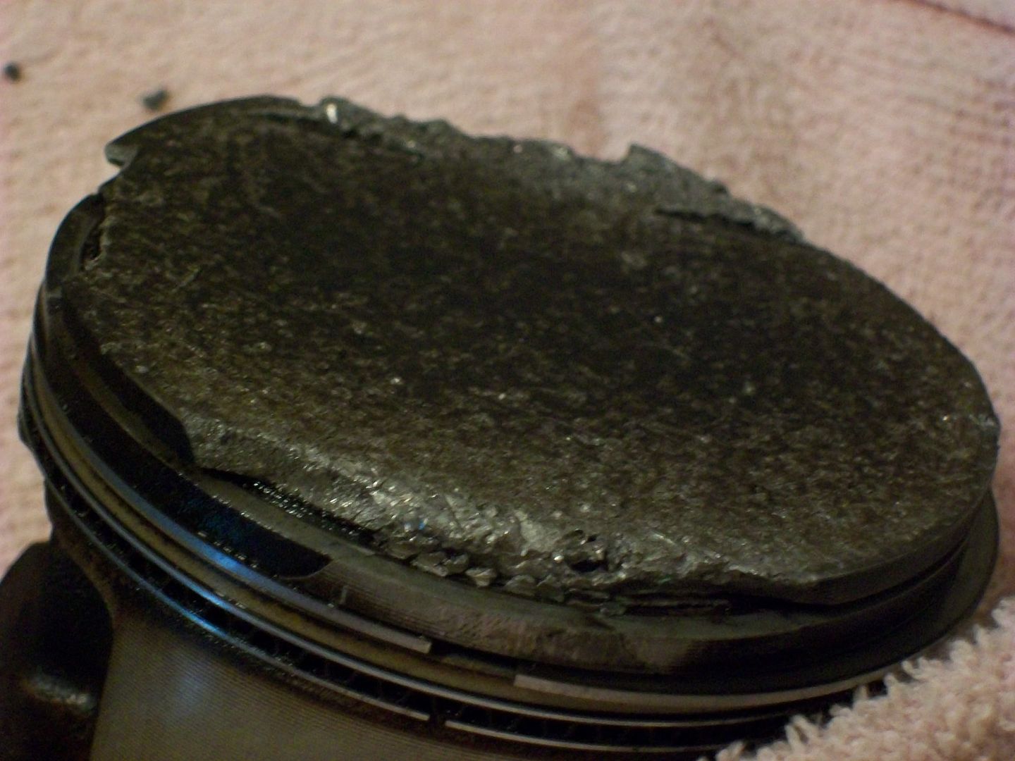

                  Can you post a pic of the damage to the head?
                  http://www.sixthsphere.com/smf/index.php?topic=62687.0
                    Re: Jubagel's 94 SW2
                    yeah i'll try to remember to snap a picture next time i go over to my grandma's where the coupe is. probably will be going over there tomorrow

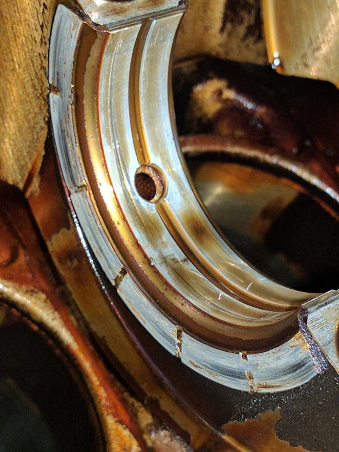

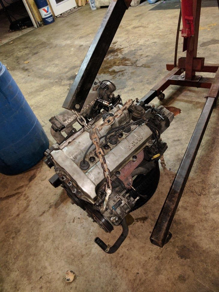

                      So we tore the tired 300k mile engine out and tore it apart.
                      Thrust bearing was massively worn

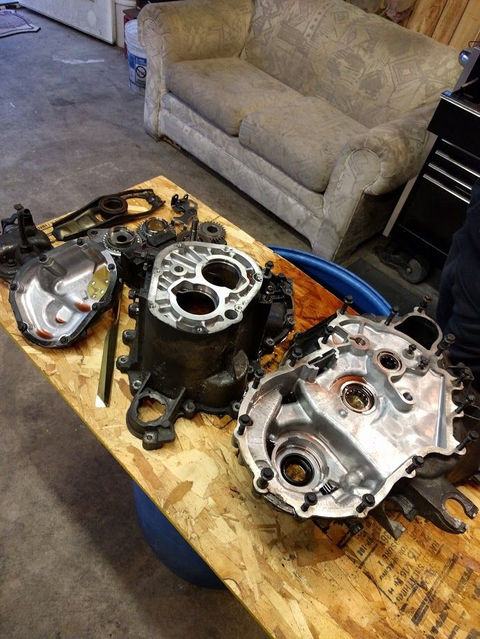

                      Sent out to machine shop for cleaning and inspection. In the meantime we disassembled the trans to get the differential out so the pin could be welded.

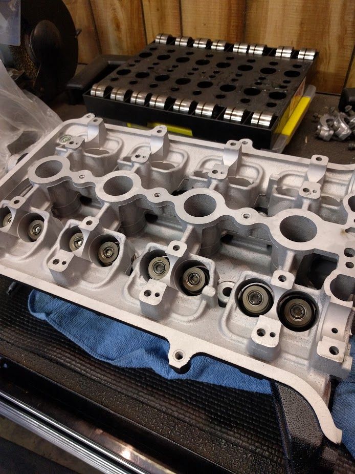

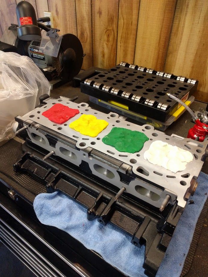

                      As of today, machine work is done, just waiting on internals to ship and keeping myself busy with other issues. Had the intake bead blasted. The head got a valve job and new exhaust guides. Everything is clean and ready for forged internals. Heres a few quick snaps of the engine.

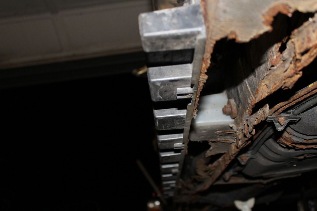

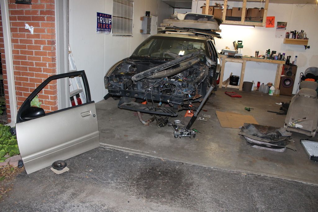

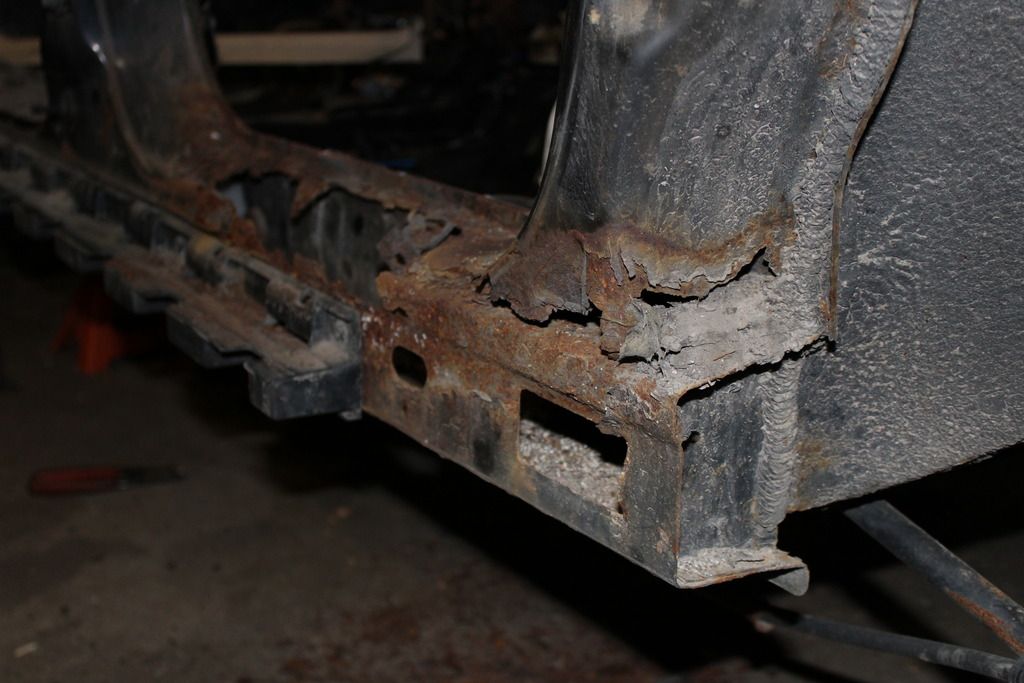

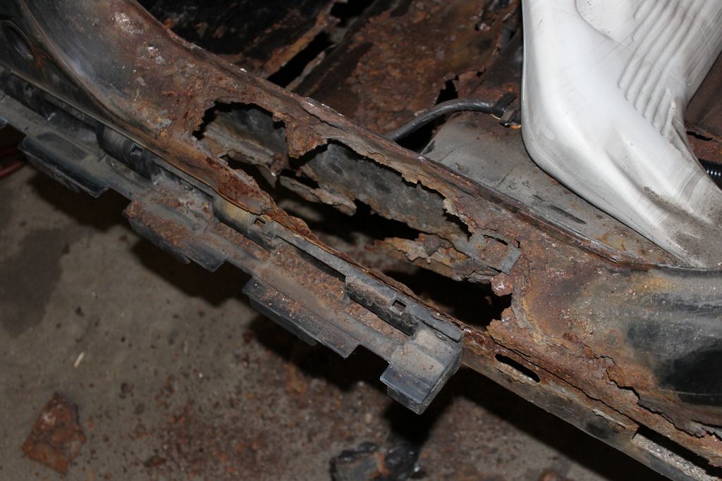

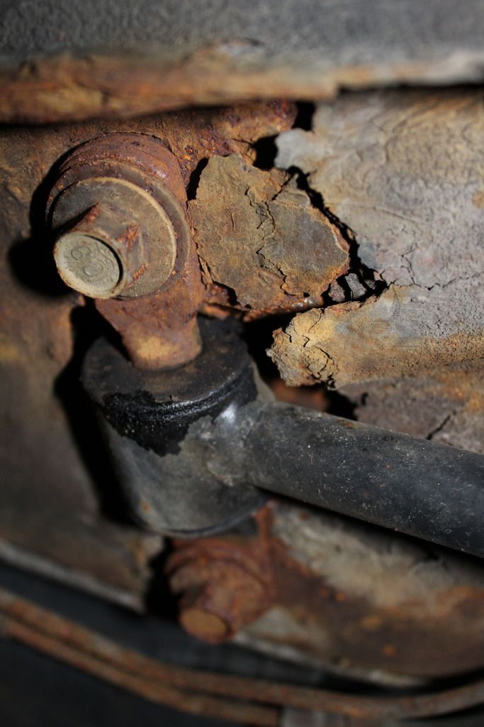

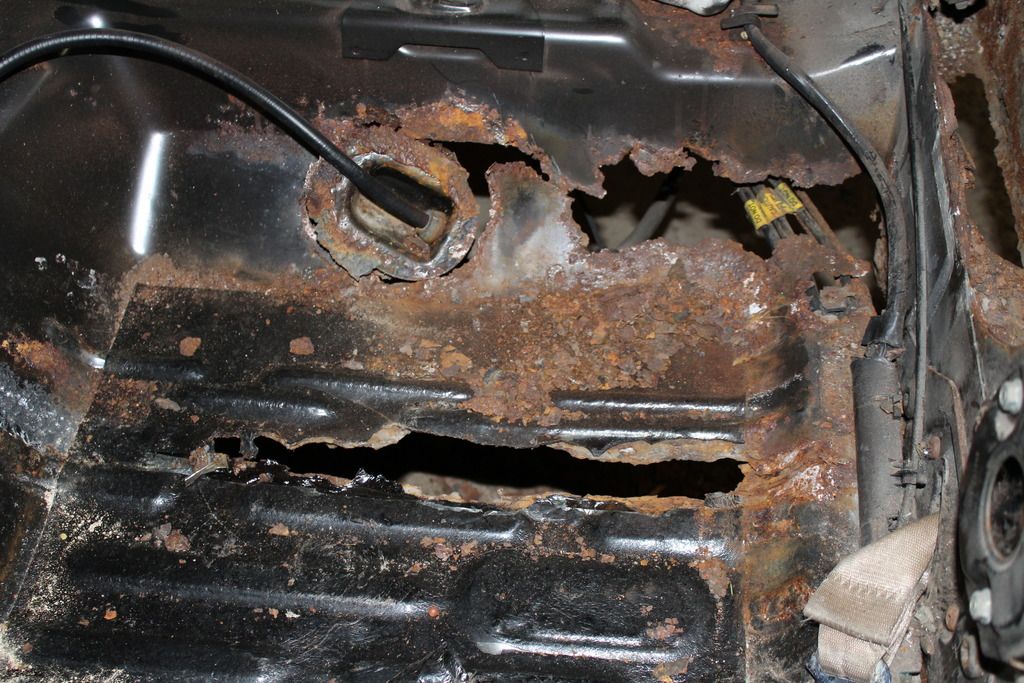

                      Well everything seemed to be going smooth until I really started digging in. I gutted the interior since it smelled like various sorts of cheese and found some pretty serious rust problems.
                      Most people would say scrap it. I can't let this car go, I've tried. I have no idea what it is about this thing but I can't walk away. Lol anyway this is where it sits now. All drivers side panels pulled off to access rust. Will be starting that project on my next day off. In the evenings until then, I need to strip everything from underneath the car (fuel tank, rear subframe, lines, exhaust)
                      Anyway, I will keep this thread updated with progress pics as I hope many can gain something from my rust repair project (assuming it doesn't kick my ass into submission). A lot of these cars are dying out due to rot like this and I want to see 1gens, especially wagons on the road for long as possible.

                        But dam that rust is bad. Good luck rebuilding it. It Would Be great to see it saved. I was lucky enough to get mine before the rust was too bad. I just bedlined the entire floor pan and rubber coated the underside.
                          Originally posted by toka100 View Post
                          Really nice looking wagon.
                          Yeah, I wish I hadn't ignored the rust all these years. Fortunately the door frames are still available NOS so should be a piece of cake for those. As for the floorboards, I'll make those custom most likely
