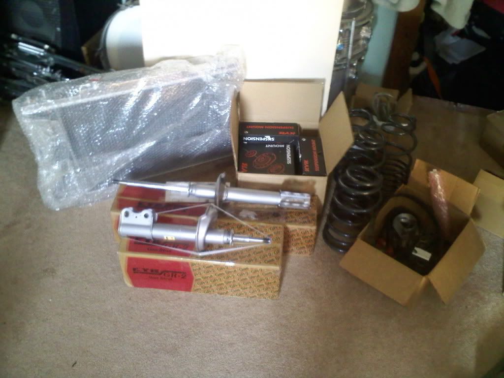

    The Parts Collection:
    Shown here are Progress Sport springs 1.8" 200 lb/in Front, 170 lb/in Rear.
    KYB GR-2 struts front: 30% stiffer than stock. Rear: same as stock and KYB mounts.
    All aluminum RSX radiator.

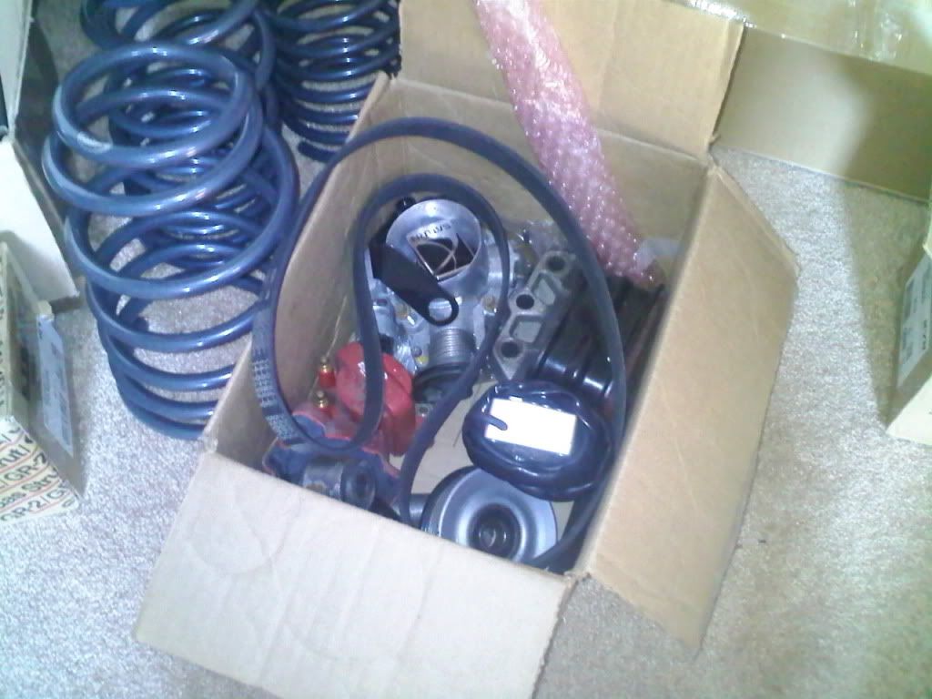

    Box of goodies (details to follow)
    Box of goodies contains:
    SDA mount set (dog bones and tam with insert).
    AC/PS delete belt and idler.
    MSD coils (and wires not shown).
    Zombie TB bracket and ported Geo TB.
    Apexi SAFC.

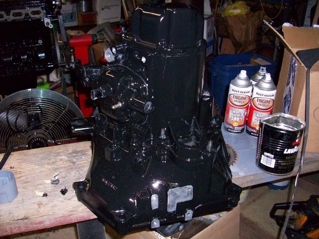

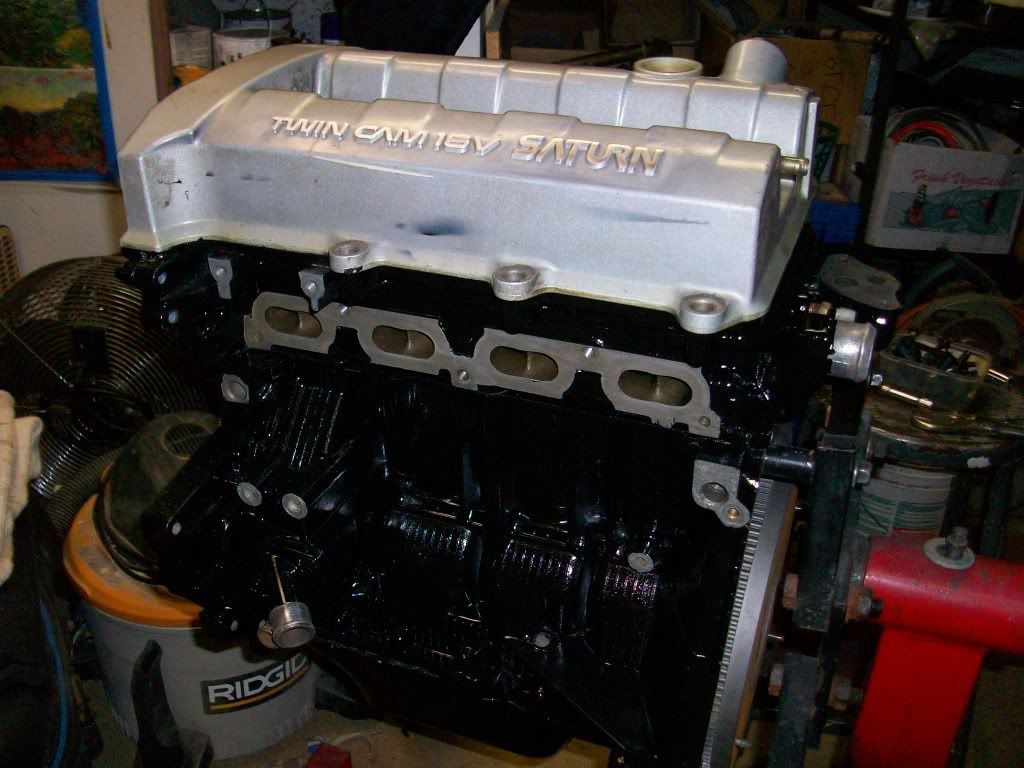

    The Engine and Trans Axle:
    Engine specs:
    • '99+ rods and pistons .030 over bore (hyper's with drain holes)
    • '93-'98 crank
    • '92 flat faced valves
    • Minor decking for straightness
    Trans:
    Welded Diff MP3
    I'll be reusing the exhaust that I put on my current dd when the time comes. Its a 92 oem header 2.25 inch mandrel bends with a 32inch glass pack and a magnaflow straight through oval muffler.

      your engine and tranny look sexy!

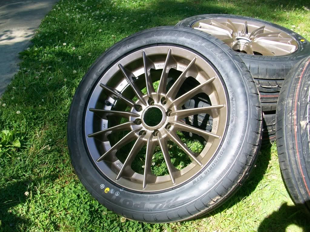

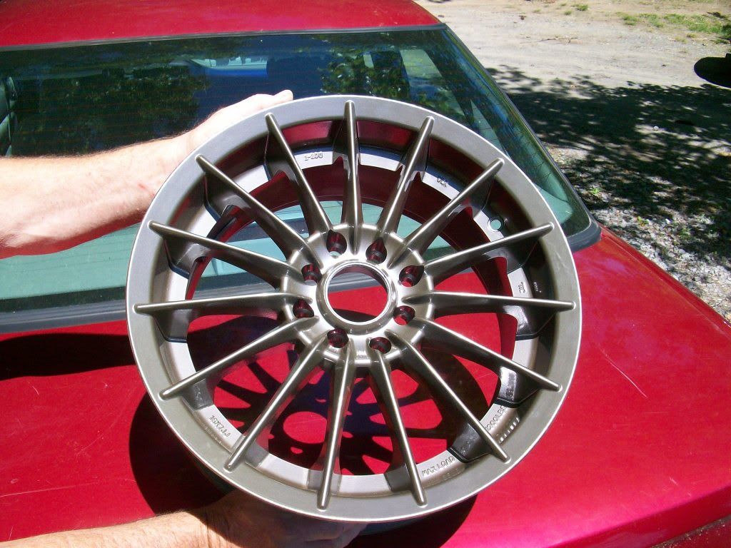

        I have a set of these wheels 16x7: (never mind that the pic is 5 lug)
        The silver is flaking and they are in need of a new coating, I'm pretty sure that I will be going with a gloss black but any suggestions are much appreciated.
        I grabbed up a set of hein's rear hub spacers in 1/2 inch, should bring the wheels out nice and flush with the fenders.
        I have not really come up with an engine bay scheme quite yet, the header is wrapped and coated with the silver coating for the wrap, and the block is black, so I could incorporate another color if I wanted to, but I am undecided as of yet. Again suggestions are appreciated.
          Thanks! I put a good amount of time into them.

            it def shows!
            what are you going to be tuning with?

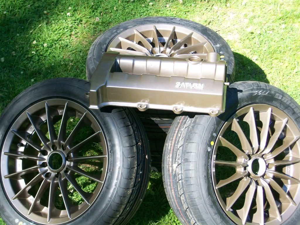

                  well heres my rims back from PCing:
                  And with the matching VC:
                  -Walker - 2006 Volvo V70R
                  1995 SC2 - Killing me slowly -
