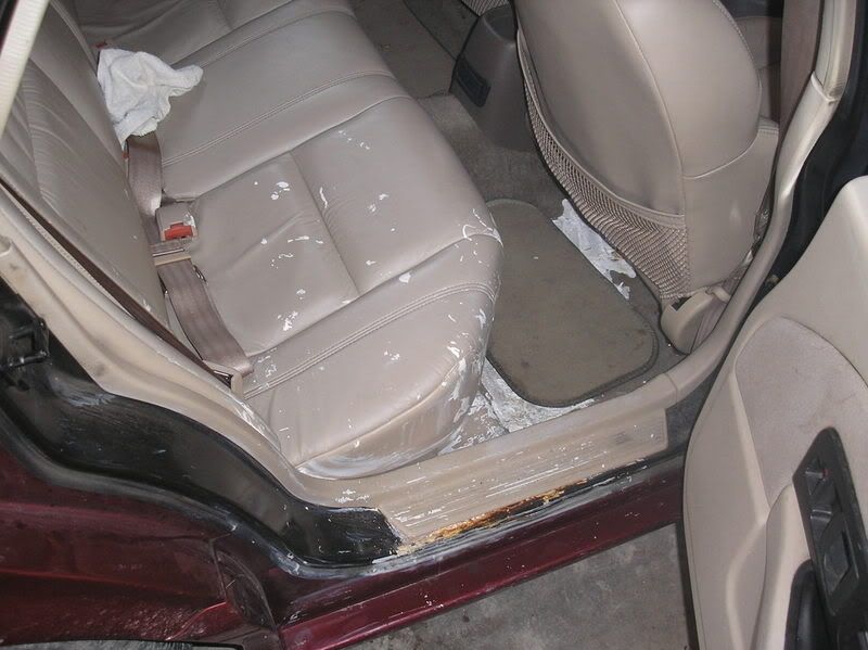

    Interior is wrecked. Seats are comfortable, dash is all there and operational. Driver's side door panel is destroyed, driver's seat has a tear, rear seat and carpet have paint spilled on them. Rear door sill look rusty, I'll have to weld in the replacement pieces when I have the carpet out. Lots of cigarette ash that I spent a lot of time vacuuming up.

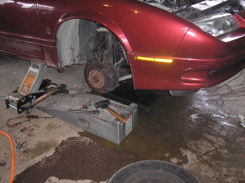

    Picked it up on Friday... it needed a thermostat (weaksauce heat). I decided to give it an oil change at the same time. I pulled a thermostat and housing off a spare motor I had in the shed. Seemed to be in working condition, despite a little corrosion.
    Radiator petcock wouldn't open, so I was forced to drain via the lower radiator hose. This made an ungodly mess, but I was able to save about 1/2 the coolant for re-use.

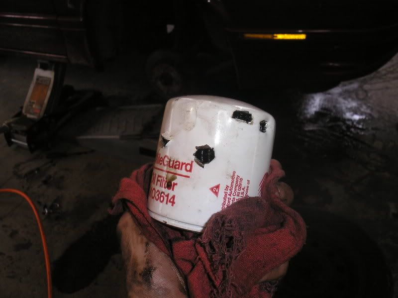

    What do you do when the incredible hulk put your oil filter on and you don't have a filter wrench? Pull off the fender liner and stab it with a screw driver. This didn't help my already messy garage.

    why is it that people think you need to reef those oil filters on?? Hand tight people, hand tight. I've been lucky, never had to stab the filter before.

      Lol @ Jiffy Lube Filter

        If you need the part numbers for those parts I have them and LOL at the oil filter, very creative removal tool.

            i small hammer works well on the trans filter (for autos) and the oil filter. couple smacks and it'll pop right off it its stuck on tight
              yikes! I don;t know about beating on it with a hammer. lol. Seems like you might tweak something you wouldnt necessarily want to... I have heard of the stabbing trick, never had to put it to use though

                yea when i went to pull the engine from the JY we didnt have anything to pull the filters out with and i had never heard of the stab trick, so we said fuck it. You hit it with a hammer a few times and it puts a nice big indention in the side and you just twist from there, or just keep hitting and it'll twist it self. We didn't do any visual damage to the filter where it attaches so I don't see any harm in it.

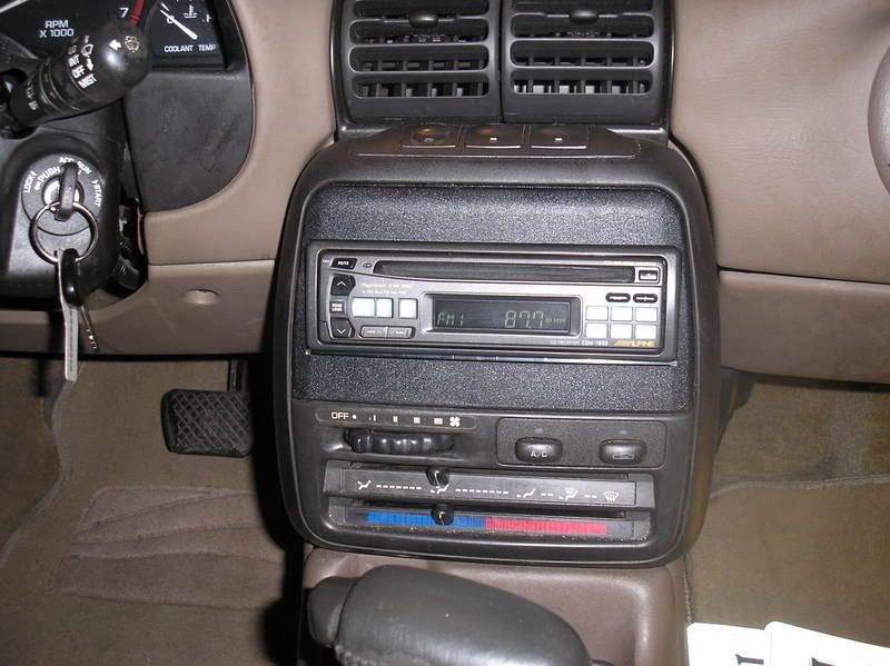

                  Replaced the crap stock head unit with an aftermarket one I had laying around. It was the shittier of the two (non-mp3), because apparently I forgot to remove the bezel with the unit that was in the dragon bitten SL2. FAIL
                  Install went well, at least it looks clean. Can't find the antenna adapter, so no radio for now. FAIL
                  Time to burn a couple CDs [img]{SMILIES_PATH}/rolleyes.gif[/img]
