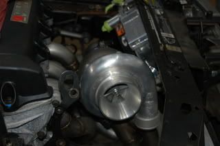

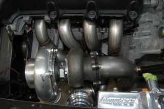

    Precision 62/62 billet turbo .63 hot side polished compressor housing
    custom exhaust manifold

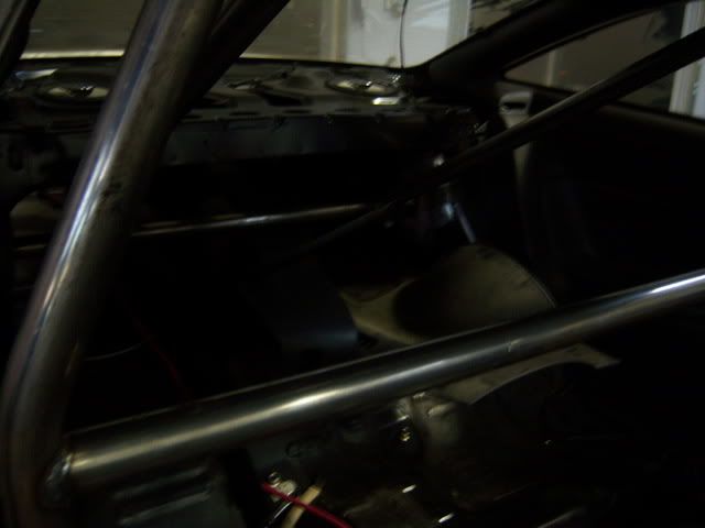

    Custom 4 point roll cage

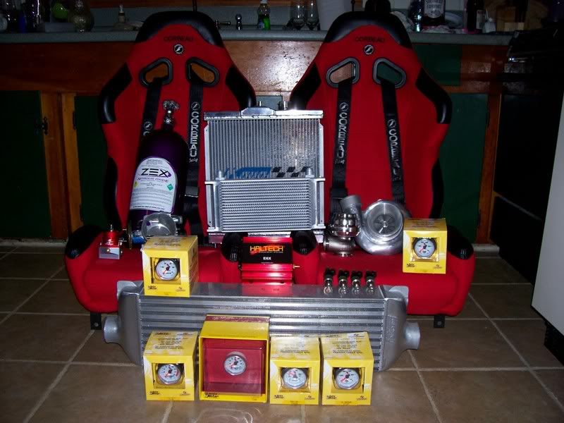

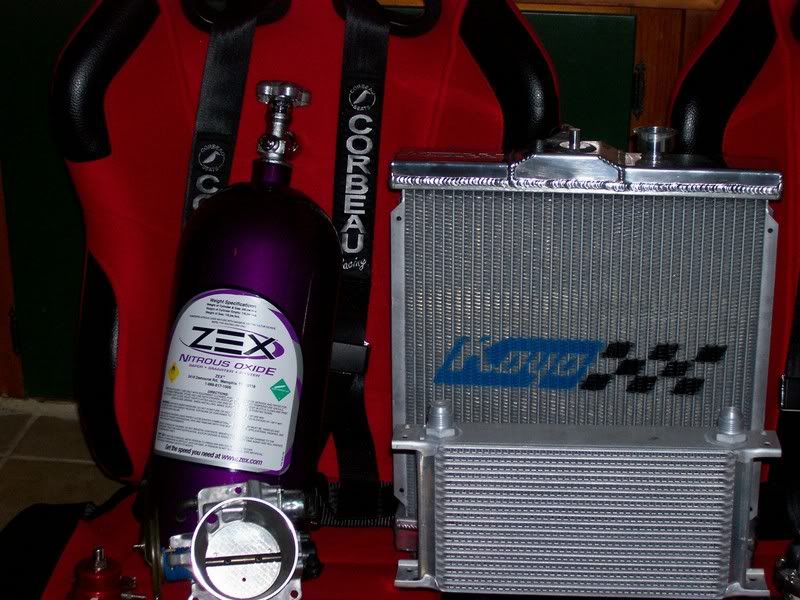

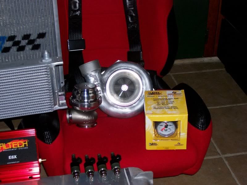

    some of the parts

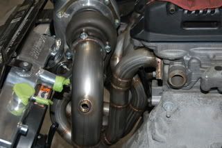

    Exhaust manifold
    Turbo setup complete
    Wheels
    Interior

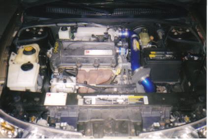

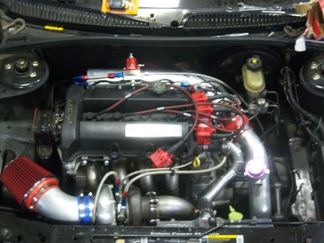

    nice bay. got alotta shit going on. props. i like your plug wires and coils(?)
    --Devin<br />91 S-10 *IRON DUKE*<br />2.5L 5 spd. rust? thats my weigh reduction method<br />94 SC2 *KILLED BY DRUNK DRIVER*&nbsp; &nbsp; &nbsp; &nbsp; &nbsp; &nbsp; &nbsp; &nbsp; &nbsp; &nbsp; &nbsp; &nbsp; &nbsp; &nbsp;&nbsp; <br />daily driven autocrosser-soon to be a booster.<br />94 SL1 *KILLED FOR PARTS*<br />parts car, no title, no registration, &lt;--7 tickets, sent to junk yard<br />does this taste like ghb? cuz if not...good. and if so...good<br />[img width=600 height=149]http://www.sixthsphere.com/storage2/images/fdyz1xjje8ogt081lmj3.jpg[/img]

        the coils are mounted that is an older picture

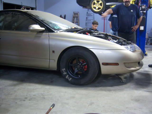

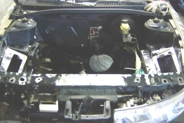

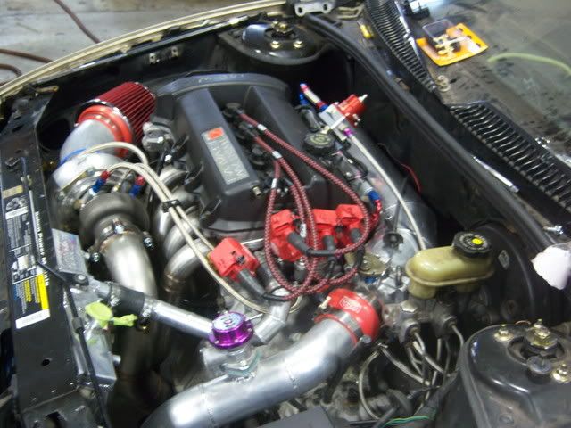

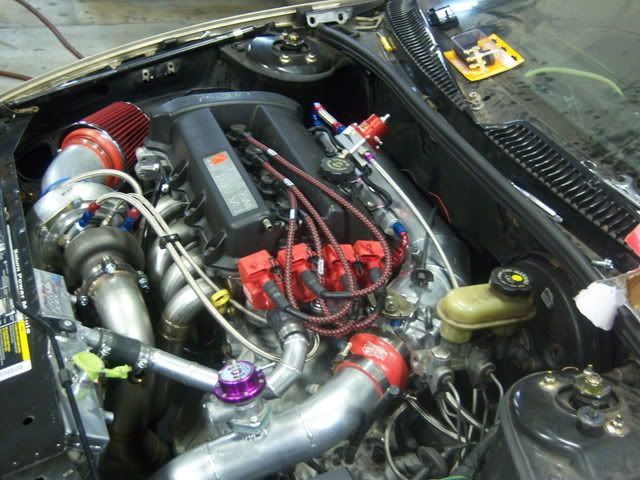

            its like im starting all overr again though, while starting it spun a rod bearing for reason which were never discovered to date. So motor is out of the car and i decided to tidy up the engine bay quite a bit here are some pics
              Re: slammed's never ending turbo build
              Wow that looks amazing. So it never actually ran like that? or was the spun bearing on start up a different time?
                it ran on 2 cylinders like that for 5 mins then spun a rod bearing. It ran on 2 cylinders because we had to change the way we had the ignition was wired up but hope to have it up and running this spring
                  Looks like it was and will be a BEAST!!! Good luck with it.
                    Nice. I want to see it run.

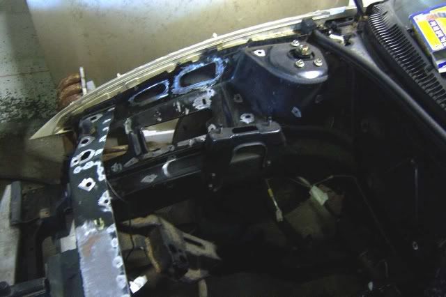

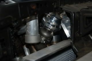

                    Who made the custom exhaust and intake manifolds? The exhaust looks like the one Alpha Tuning offers. Their site says that modification to the cradle is needed to make it fit though.
                      i thought the same thing when i saw that. either way, nice build

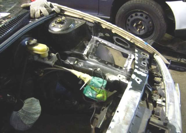

                        Well he appears to already have the front crossmember removed, so might be possible.
                        Anyways, awesome car!
                          yes i cut the crossmemeber when i had the first turbo set up. I'm going to put something in its place when everything is back and running
                            wow, that's pretty nuts! that upper rad "pipe" though, aren't you worried about engine rocking and cracking that thing? I'd put a bit more hose in there to allow some flex, no engine mount is 100% solid.
