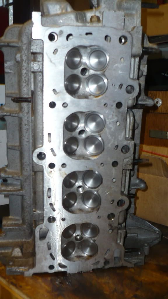

    Over the summer i bought most of the parts I need to do the swap. I just got my head back from the shop, where they did a valve job, mild port and polish and mild port and polish on my intake manifold. I will be updating this thread as i do my swap, which will be soon. Here is what i have so far for the swap:

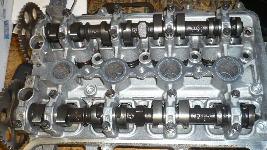

    Decked and mild port and polished head

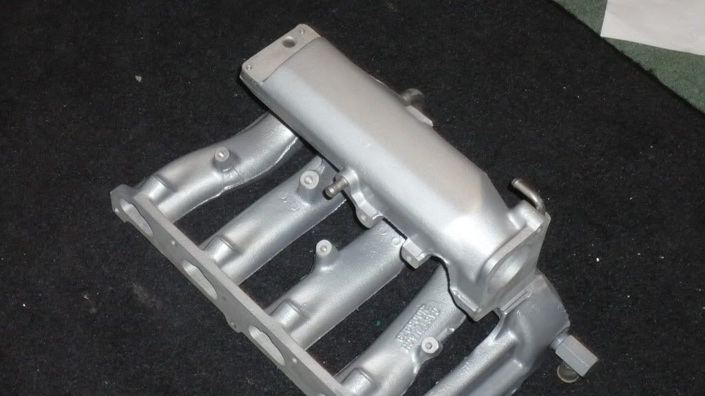

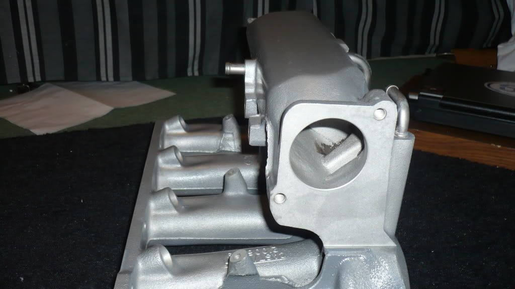

    Painted mild port and polished intake manifold

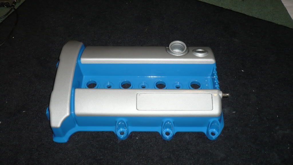

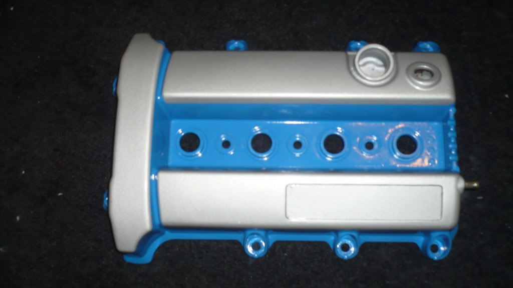

    painted valve cover

    i will add some pics of the head over the weekend and possibly more

      Otherwise the build sounds pretty good. Valve cover looks nice even though it's not my thing.
        Re: 98 sc1 to sc2 plus performance mods
        not a big fan of that light of a blue there but that color scheme could look wicked with the right colors
            ya i realized after that it was ford racing blue, it will look good because everything will match in the end.

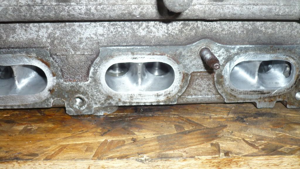

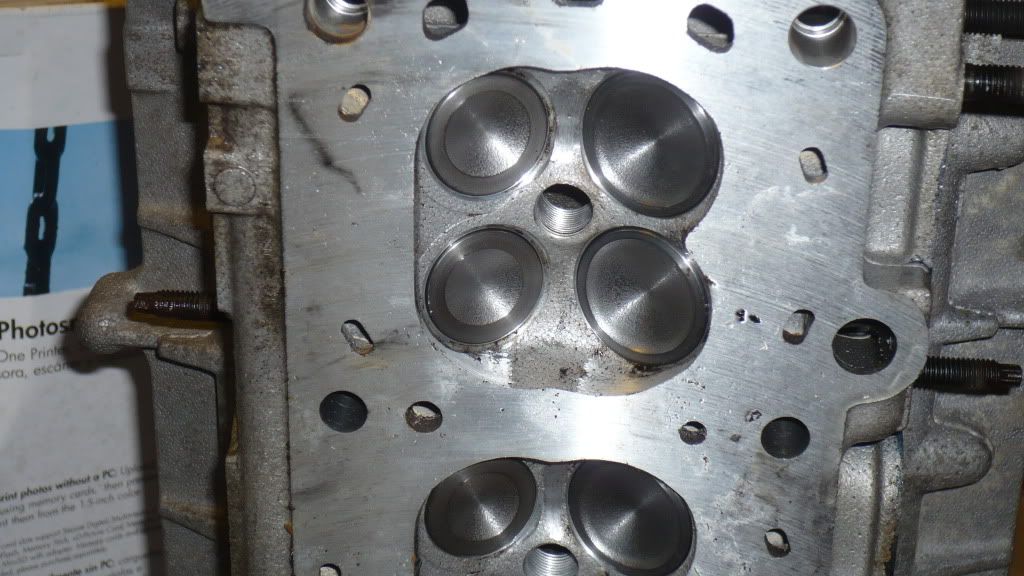

              got some more pics of the head and the port and polish

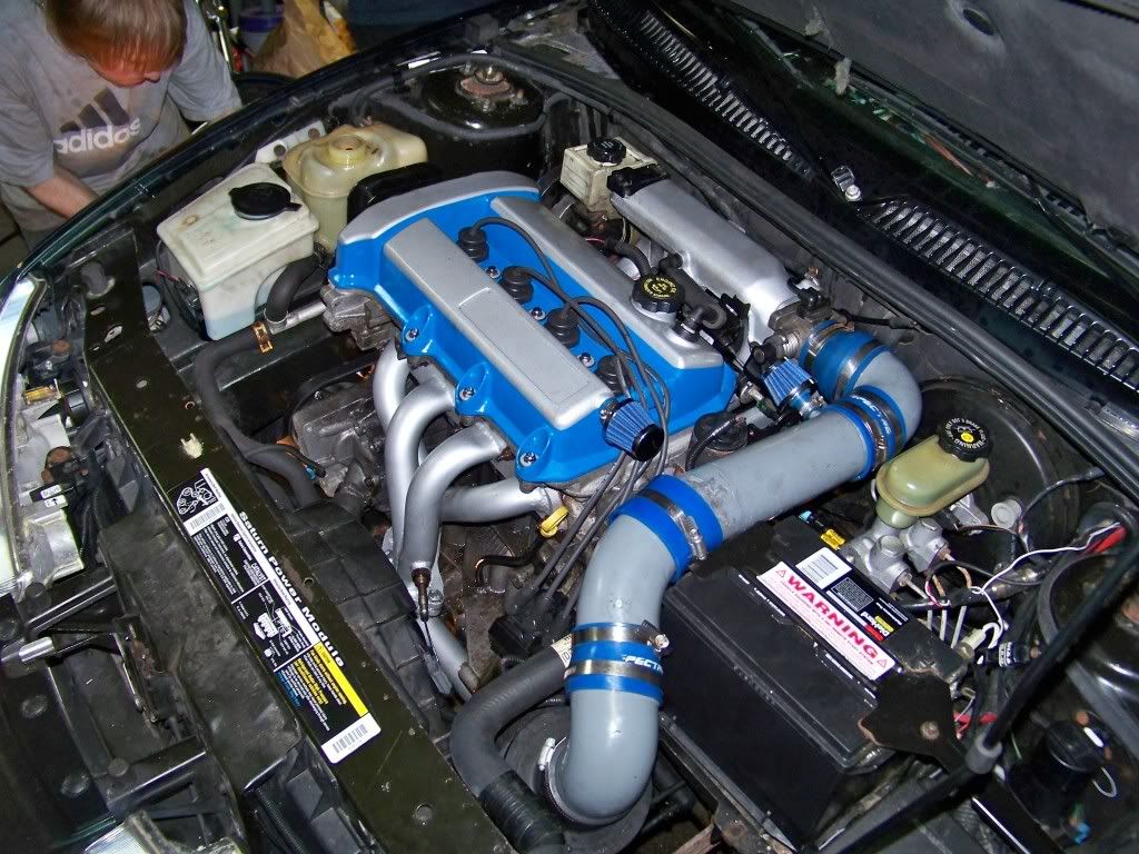

                          so I did the head swap over the weekend and everything worked well. I also bought ARP head studs, Apexi Neo and a AEM wideband o2 sensor for my car.
                          all get more pics up tonight

                            I'd go darker blue and all one color on the valve cover, but I'm glad everything worked out!

                              You've still got dished pistons in there, right?
                              That port looks pretty big for an N/A.
