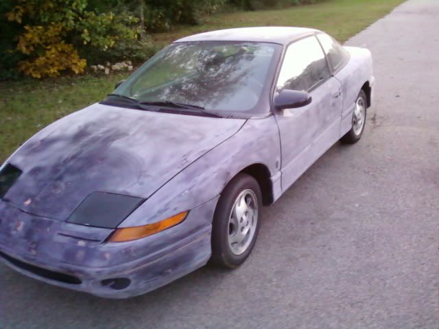

    drivers door:
    Headlight covers i repainted black because they were chipping and rusting. (you can see the outline of the rusted section)
    passengers fender:
    Painted mirrors:
    Primer'd Fender:
    Painted fender:
    All the rough sanding is done. Wet sanding it with 220 when I get the time.
    car is all Primered up.

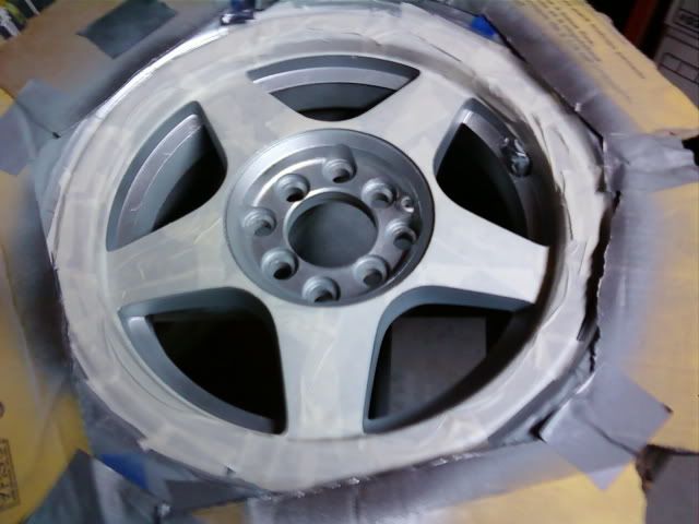

    New wheels before paint:
    Primer:
    All silver:
    Silver masked off:

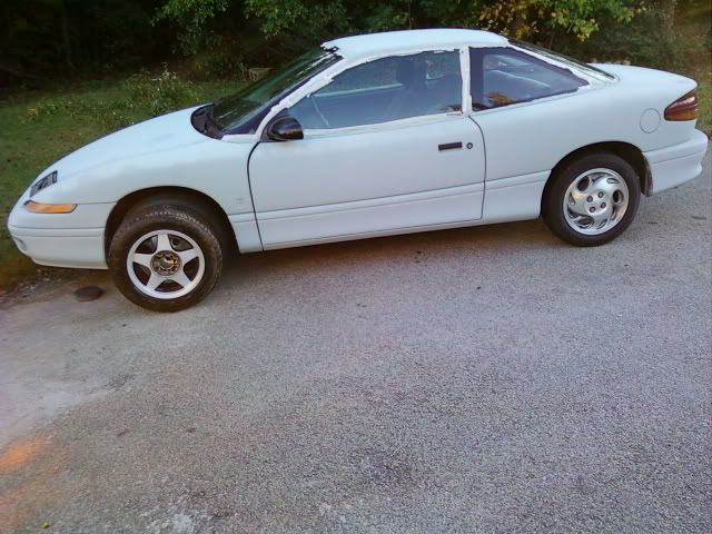

    Done:

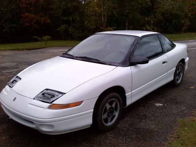

    First coat of paint and the new wheels on the car:
    Paint is finally on:
    With the reflector still masked:
    With it off:
    The rest of the pics from today:

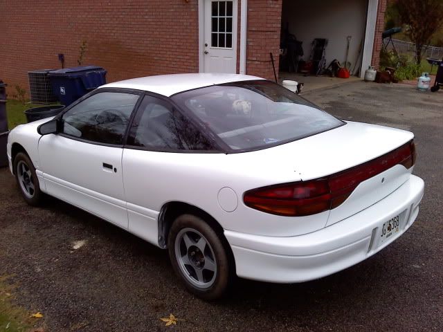

    With the headlight covers and wing on:
    Put the sub in:
    Tailight tint:
    Reflector:
    Gauges:

                        Rough sanding and bondo-ing is done. Pics in first post. Got the passengers side and trunk wet sanded with 220 and ran out of daylight. More sanding when I get the time.

                          Can't tell much from blurry cell pics, but that fender looks pretty great. I'm guessing it's really rough up close though.
                            Re: Project Crown Royal. Pimpin on a budget.
                            it really isnt. its no show car paint job but its a hell of a lot better than you would expect from a rattle can. my dad called me a liar when i told him i used spray paint. 1000 grit works wonders.
