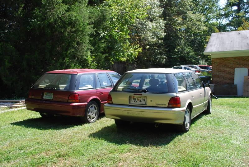

    Picked this up 09/19/2009
    Carfax shows it as totally clean.

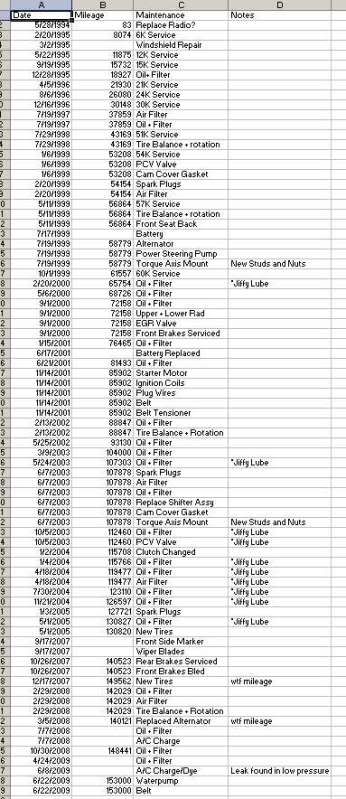

    Original owner saved all receipts for service. Second owner saved most. I logged them all, and holy service history batman:

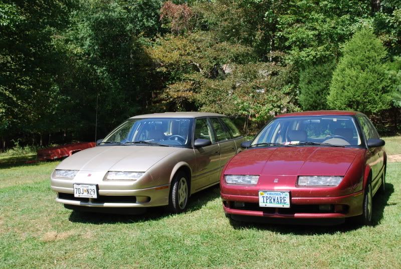

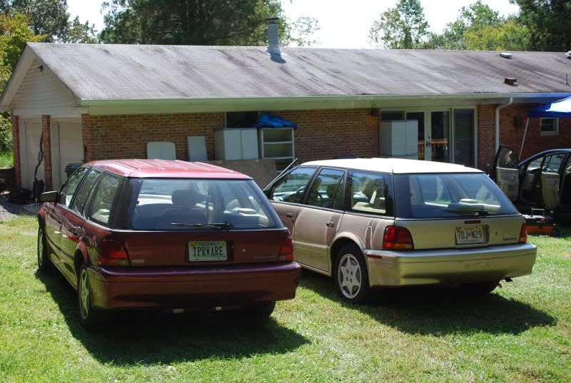

        sorry, but which one is the new one? the gold one i assume since it looks to be in better shape?
          Re: ProDarwin's Not-As-Shitty DD
          Gold is the new one.

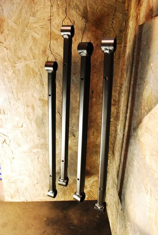

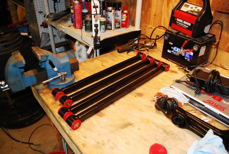

                      -I also hit the lateral links (donor set) with a wire wheel and scrubbed any surface rust off and hit them with a coat of anti-rust semi-gloss black. Tonight I pushed some poly bushings in.

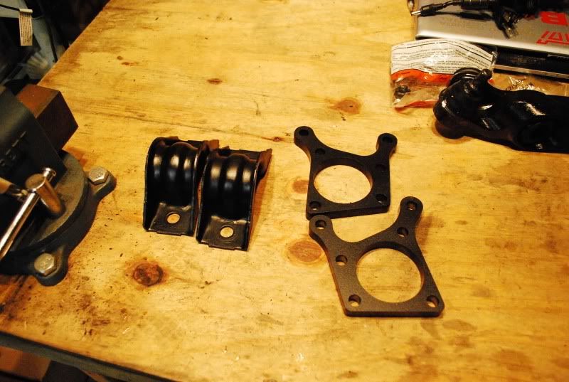

                      Also I straightened out a donor set of front swaybar brackets with a hammer, touched them up with a grinder, then hit them with a wire wheel. They have since had a couple coats of paint and are currently drying along with a set of rear hub spacers.

                              Refinished front swaybar brackets, painted rear hub spacers:
                              Refinished rear trailing links. I'll install the center parts on Mon. or Wed. when I have access to a press again.

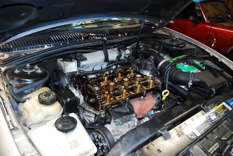

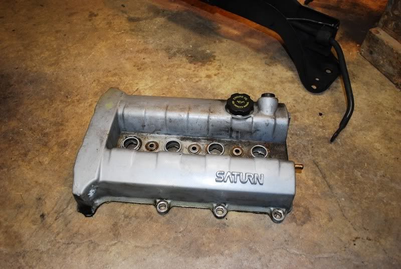

                              I popped off the cam cover because it was leaking. Also some of the paint on it is peeling, so I guess I need to refinish it as well. Top end of the motor passes the visual test... no excessive wear that I can see (whats the procedure for inspecting the chain?)
