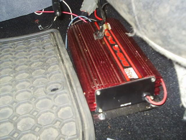

    Msd DIS 2

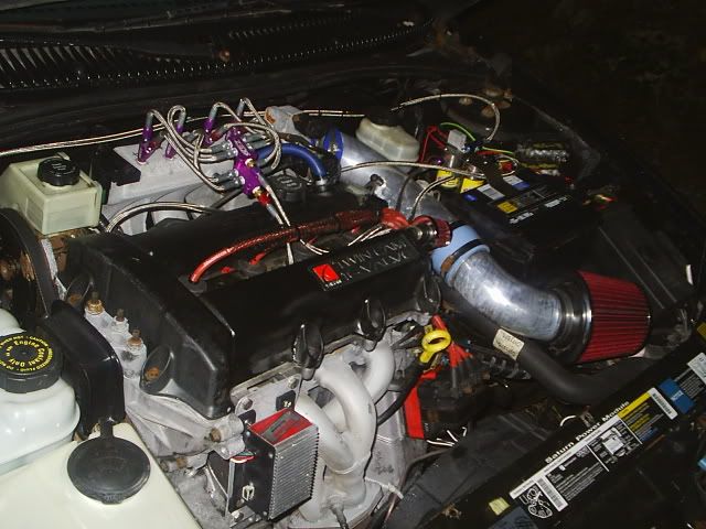

    ZEX 75 shot, Wet, Direct port Nitrous

    Wow that's a killer looking direct port setup. Good job with the times, sounds like she scoots pretty damn well for what it is.
      Re: Starr Auto, SW2 project
      Nice wagon. I almost bought a zex kit like that but got a good deal on a NOS DP kit.

        Always love to see another wagon, not sure on that dp setup though. Looks like the hood sits directly on the lines and I would be worried about a kink or any issues with cutting down flow. Also would be a bit worried about any puddling issues in the intake mani.
          That's what I was thinking when I saw the location of the ports

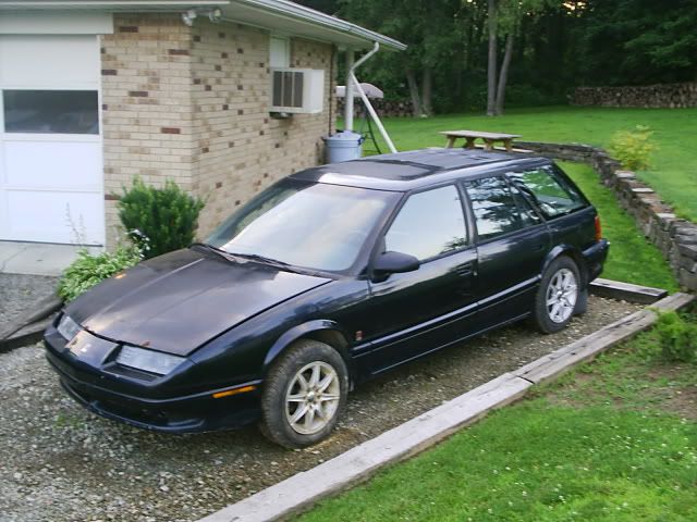

              Yards in Sw PA, just outside of West newton...
              The Hood and lines did come into contact, only when putting the car in reverse, before I installed the poly dogbones, now they dont hit at all, thanks for the comments, etc etc.. .now I'm gona work on getting it looking nice this winter, perhaps a coat of ppg or something shiney... I want bigger rims, but refuse to buy them, so I have to wait till something shows up in the yard. and Id like to lower it alittle... maybe some 215/50/17"s and a 2" drop.
