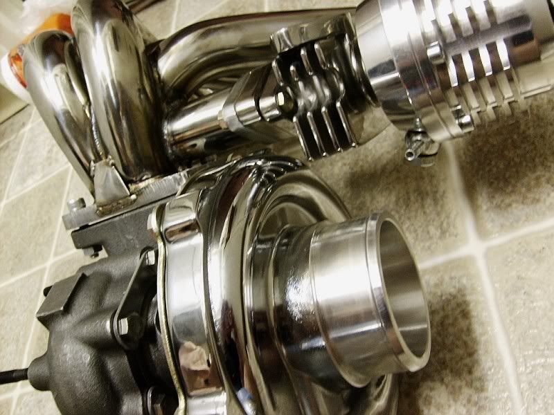

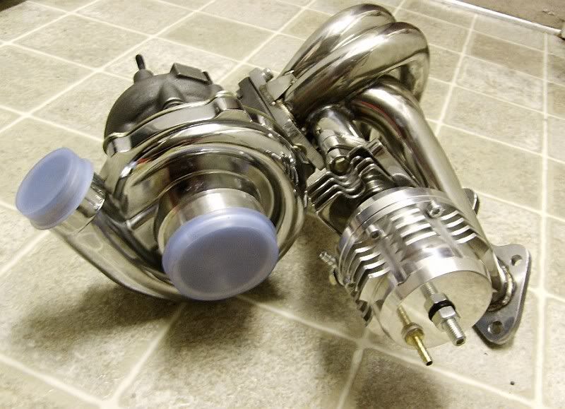

    Turbo setup:
    - New big T3/T4 turbo
    - Modified tubular 1G DSM manifold
    - BEEFY 38mm wastegate (7 psi spring)
    - Atmosphere WG dump pipe
    - Black 2.5" powdercoated intercooler piping
    - TurboXS type S BOV
    - GSI TB
    - CX Racing intercooler
    - Golden Eagle vacuum block
    - Custom 2.5" downpipe
    - OBX needle-valve MBC
    - Intercooler water spray

                Phrases in this thread that CANNOT work together.
                "It will also be done right, with chinese parts."
                - Aerospeed coilovers
                --and--
                luxury
                other than that...id go with a 3" downpipe
                but good luck
                  Re: PlasticPower's 2000 SL2 Turbo build V2
                  god will people give me a break about the chinese parts until i actually test them out?
