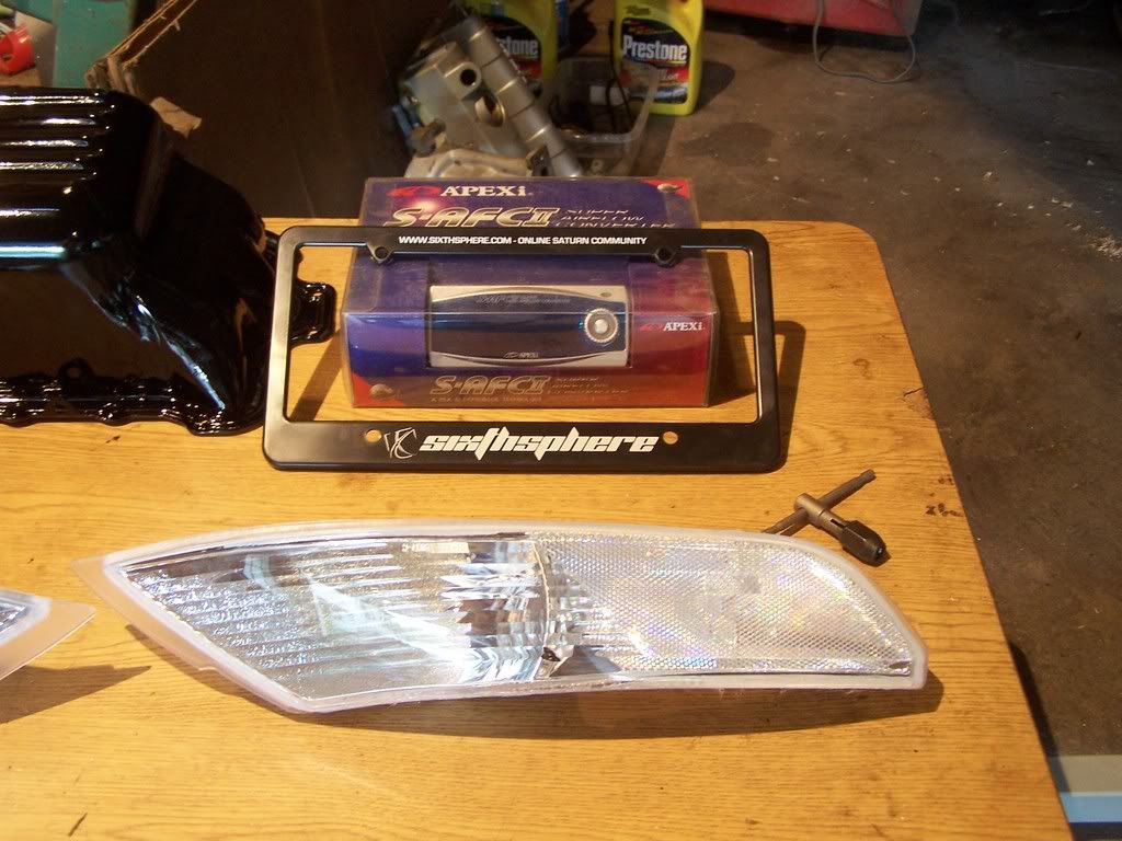

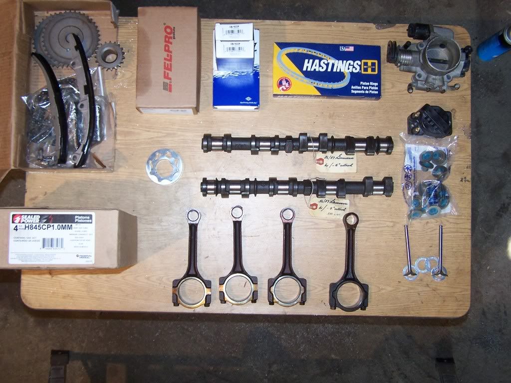

    Heres the build:
    Block bored .040 over
    sealed power pistons cut for 11.5:1 C.R.
    99+rods
    P+P head with hi flow valves
    98 valve springs
    .030 spring shims
    rebuilt lifters
    Ported intake manifold
    SDA manifols spacer
    Geo Storm T.B.

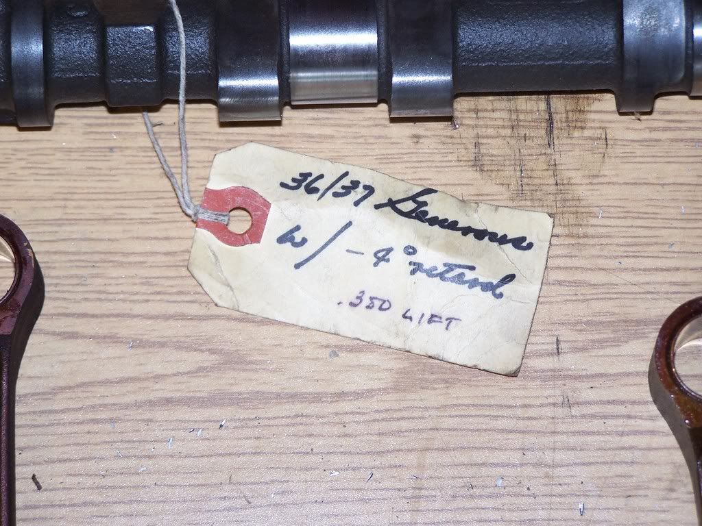

    Trying a set of race cams I picked up off ebay. 237 duration .350 lift -4 degree timing
    Hastings rings
    Clevite bearings
    Saturn high output coils
    SAFC II
    SPS Header
    custom 2.25 exhaust(Need to use the new MIG welder)
    Intrex drop springs
    Clear corners
    I got nothing for that

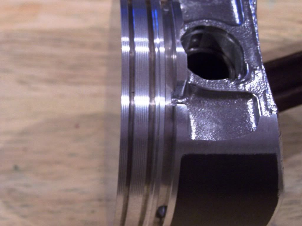

    Pistons got here today. Thanks Tim for your great work. I'll get some pics of the rest of the parts this weekend.

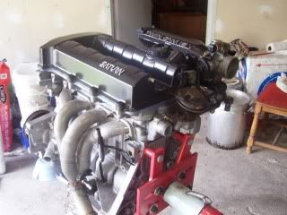

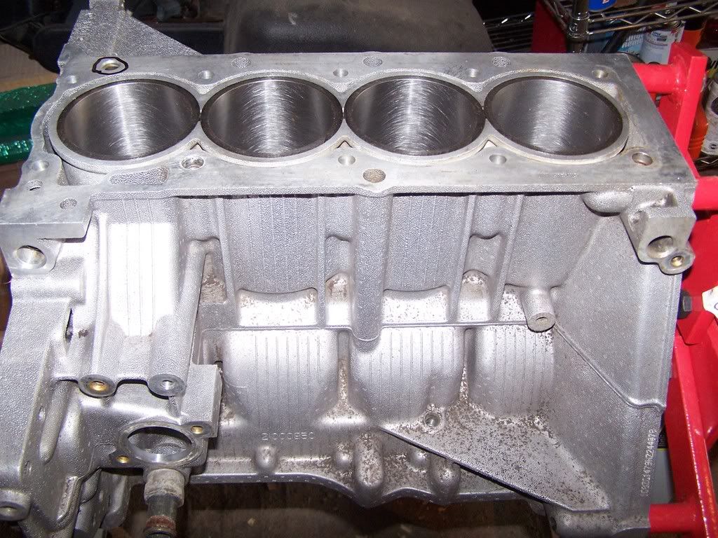

      Got the old engine and transmission out of the car last weekend.....thrown diff pin. Got to find another transmission... off to the junkyard.

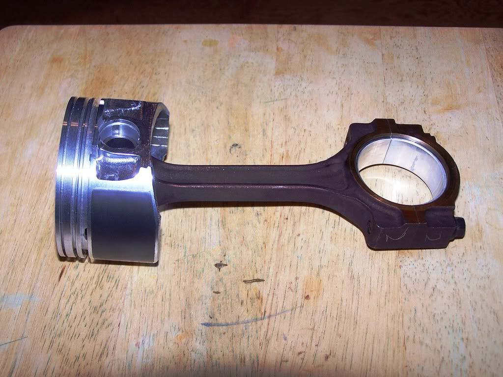

      Started putting the new motor together, all looks good.
      Main oil clearance .0015
      Rod oil clearance .001
      Top ring gaps .014
      mid ring gaps .016
      oil ring gaps .018
      Weight balanced the piston/rod assemblies within .01 grams of each other

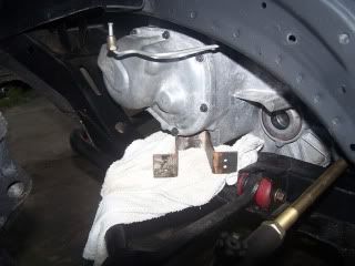

      I am going to do a rear disc conversion and a complete rebuild of ther front end.
      new hard lines all the way from the MC. Dropping the sub frame tommorow to sandblast and paint. Going to try and drop out the rear sub frame and rebuild that while I got the car in the garage.

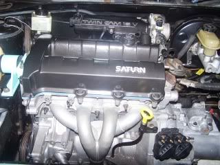

        Been pretty busy getting the rest of the car ready. Dropped in the engine this weekend.
        Static C.R of 13.0:1
        Hole where she belongs
        In the Hole
        Pimped lower mount Ver. 2.0
        This bitch may actually be running before the end of the summer
