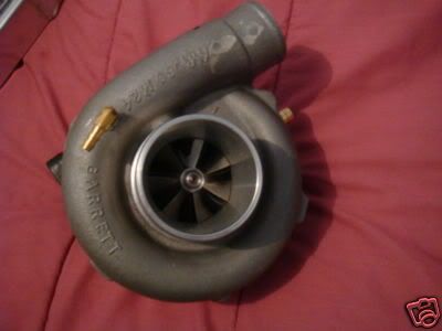

    Okay here's What I've done
    Replaced: Ebay T3/t4 Turbo with a REAL Garrett T3/60-1 Turbo (63 hot /60 compressor)
    yay turbo
    Replaced 38# Injectors with 62# injectors...yay EIC
