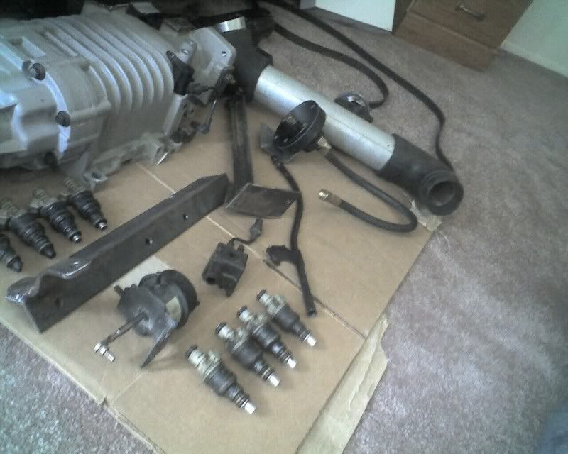

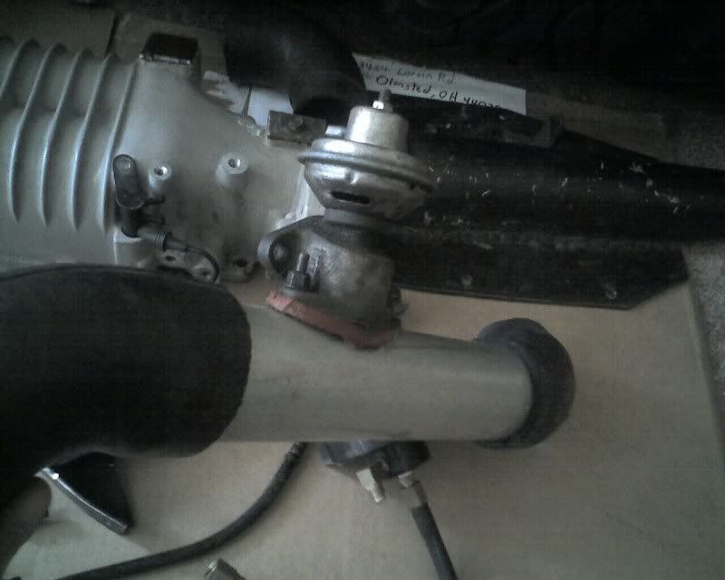

    -Eaton m62 Blower
    -Custom built plenum
    -Custom mounting brackets
    -2.5" piping
    -33lbs/hr injectors
    -2 Bar map
    -MegaSquirt 1 v2.2 controling fuel
    -Boost gauge
    -Pyrometer
    -Oil Pressure gauge
    -Wideband o2 gauge
    -Custom 3.8", 10 psi pulley

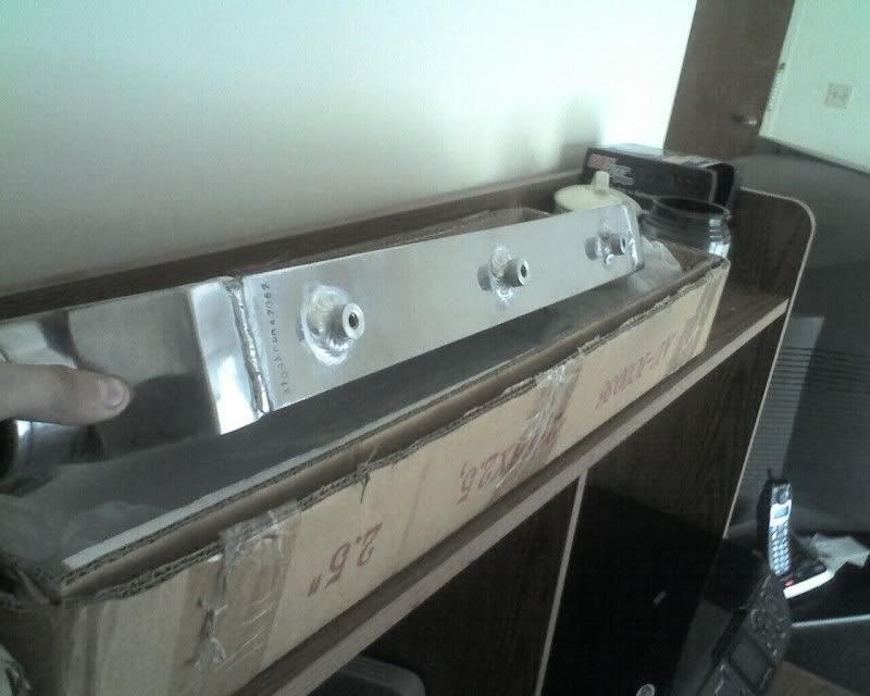

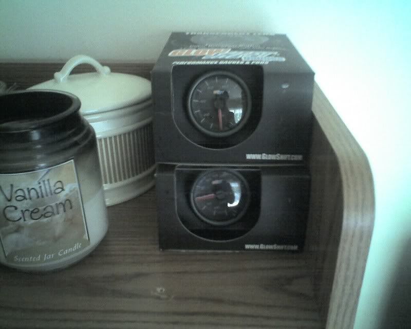

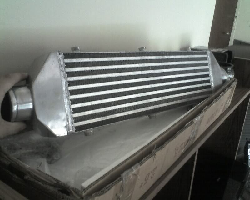

        just ordered the FMIC...ended up going with a 27" x 6" x 3" intercooler with 2.5" inlets and outlets. Also, the Oil Pressure gauge and boost gauge have arrived. I decided to scrap the 2.75" exhaust in favor of a full out 3" due to price and parts availablity. I will be running it catless in the order of Header > Spiral Flow > Glass Pack > over the rear cross member > no muffler > to most likely a nice pacesetter exhaust tip that will blend nicely with the Flat Black paint we are going to paint the car. Paint should most likely be done this weekend and the FMIC should have arrived and be mounted by early next week. once that is done, hpefully, the S/C and all of the mounts and brackets should be here so i can mock it up in the car, measure my clearances so i can order the bends and couplers i am going to need from my buddy mitch (sientin). so yes, i will be running around with an interfooler for a little while but the S/C will be bolted up just not spinning. i say that to make me feel better about being a ricer! while i wait for the bends i should have ordered my megasquirt and be having Joe (daspirate) assemble it. somewhere between now and then ill be recieving my vent pod from Micheal (neons_like_saturns) and be custom fitting my column mounted boost gauge, oil pressure and wideband will be going in the vent pods. i have also decided to scrap the pyrometer at this current time for budget and time reasons, i may add it on later but i dont see exhaust gas temps being a problem. all and all i think things should go well and i still think i should be running boost for the TOtD 08. if not, i will be the biggest ricer there with and interfooler and non spinning blower in the car

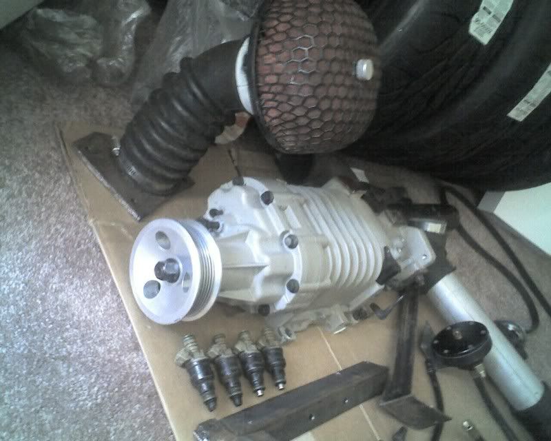

              How come you are having a pulley made for it? IIRC the stock 3.35 from the IRL only puts out 12.5#s. Maybe Im wrong.
              Basically I guess Im asking why are you going to spend extra money to have a pulley made instead of running the extra 2.5 lbs....no hate just curious.

                well the pulley is already built and i bought it already on the blower. it was built by nitrofumesrule. and honestly, i will be happier with that because i would like to be <9 psi after boost lost by the intercooler. i will eventually up the boost, but this first attempt is on a stock build on my daily driver. i would most definately love to experiment with 15 - 20 psi if obtainable before i drop the s/c and go turbo.

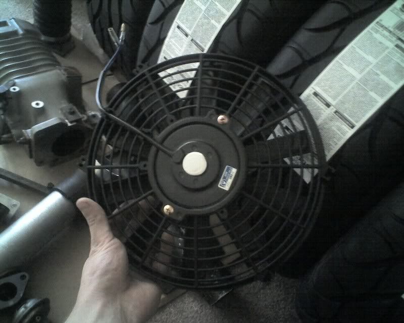

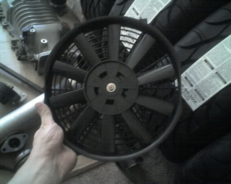

                        parts are looking good.
                          Re: Corey's Blown SC2
                          You'll like that fan. So is this still gonna be done in time?
