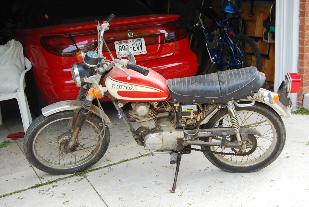

    To make a long story short: My great-uncle has a farm near LaCrosse, WI. He bought this bike new in 1974 for $551.20 (have bill of sale and title!) It's got less than 7,000 original miles. He used it to check fence lines and ride half a mile up and down the hill between his two farms.
    When I was 14, I learned how to ride on this thing, through the cornfields, long before I even drove a car. I told my dad that someday, I would own it!
    That day came nearly 10 years later, in the summer of 2009, when he offered me the title. He's in his late 70's and doesn't ride it anymore. It's been sitting for a year or two due to a broken slide valve in the carb.
    Arriving at home:

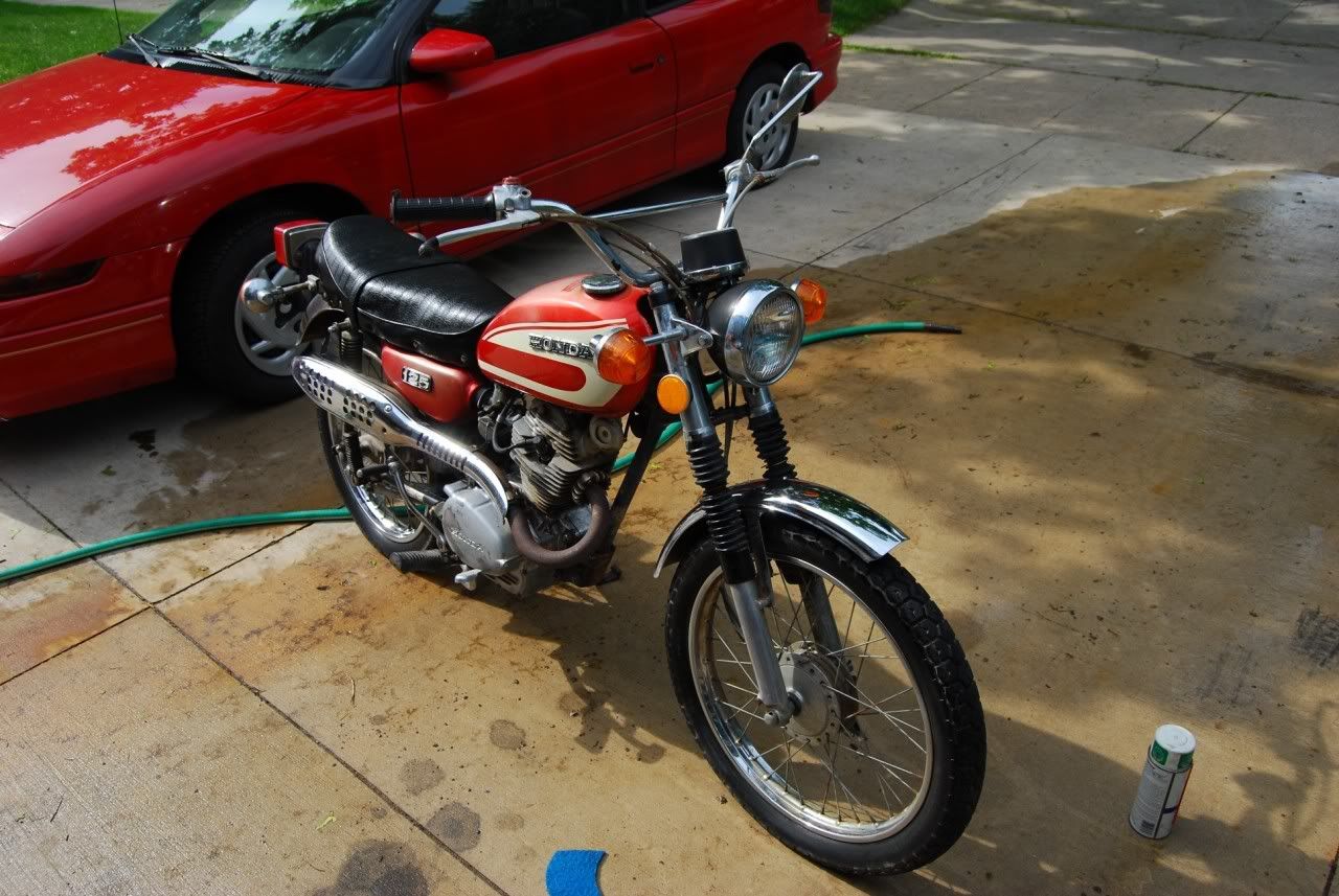

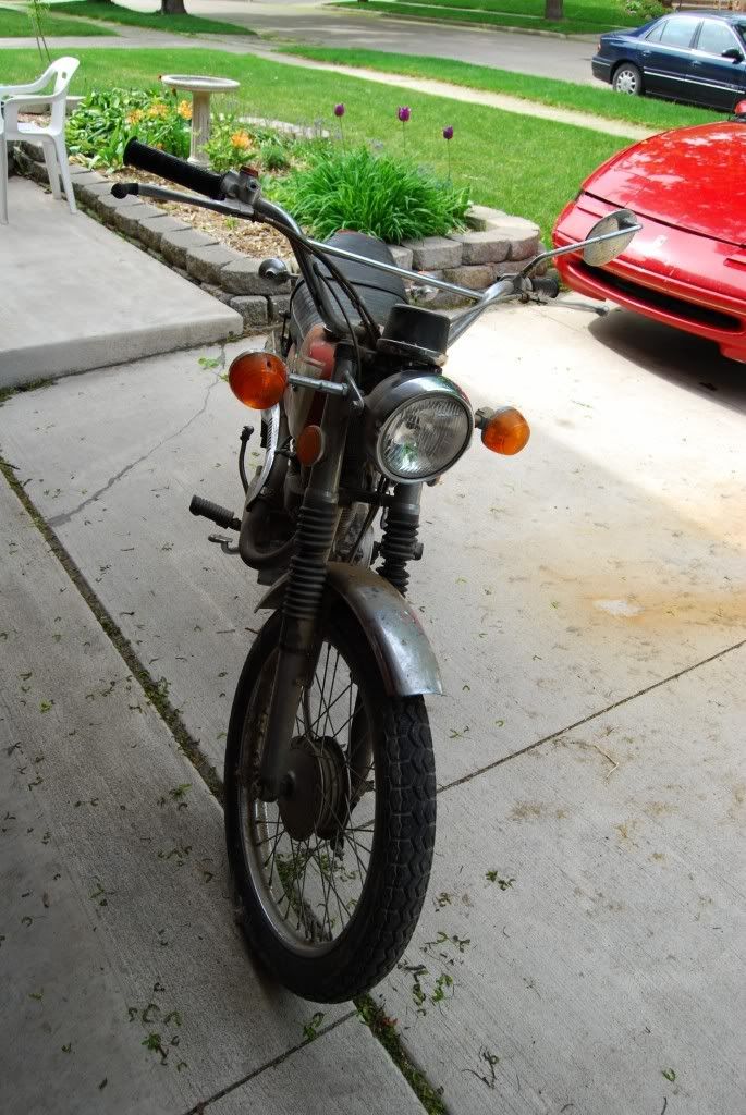

    45 minutes, some elbow grease, and 35 years of farm grime came off.
    It's a 1974 Honda CL125. From what I can tell, these are fairly rare, and parts are hard to find.

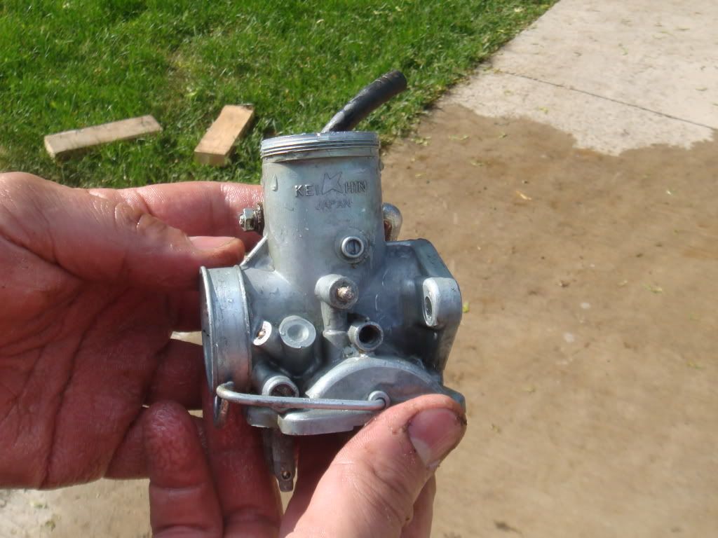

    Been doing a bit of work on this in my free time.

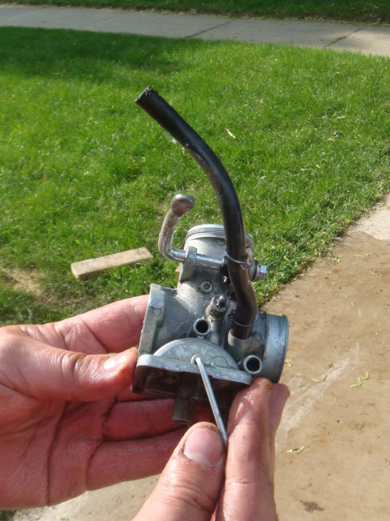

    The carb rebuild kit arrived. Took the carb off the bike and cleaned the bejeesus out of it. No before pictures, but, trust me, it was all brown when I started. I wish I had a parts washer....but I don't...so a toothbrush, carb cleaner, simple green, a screwdriver/pick, and lots of scrubbing will have to suffice.
    (EDIT: Just noticed how motherfucking wrinkly mah hands are. That should give you an idea of how much time I spent on the carb. lol.)
    Rebuilt the carb with all new parts and gaskets. Replaced all the fuel lines with new ones. Should fire right up!

        IT RUNS!
        IT'S LOUD AS HELL!
        Haha.

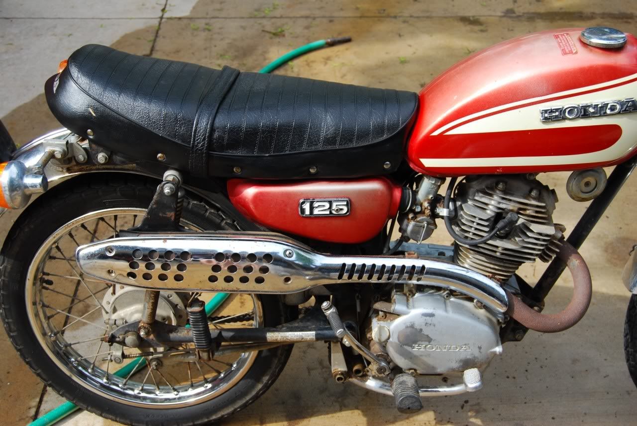

        The muffler is all rotted out and a new one is a couple of hundred bucks...fuck that. It's a single cylinder, definitely no louder than any harley.
        Got tired of trying to kick start it and tried to push start it, before I tried pulling the fuel line...no gas at all. Blew some air backwards into the gas tank and gas pours out. Tried push starting for 10 minutes before I remembered to un-set the kill switch...hahaha. Fired on the second kick after that.
        As it sits, it'll run for 2-3 minutes before whatever is clogging the gas tank floats back to the bottom. I'm going to pull the tank, shake it around with some bearings or a chain inside to break up the rust, and then have a radiator shop reseal it. Should run flawlessly after that!
