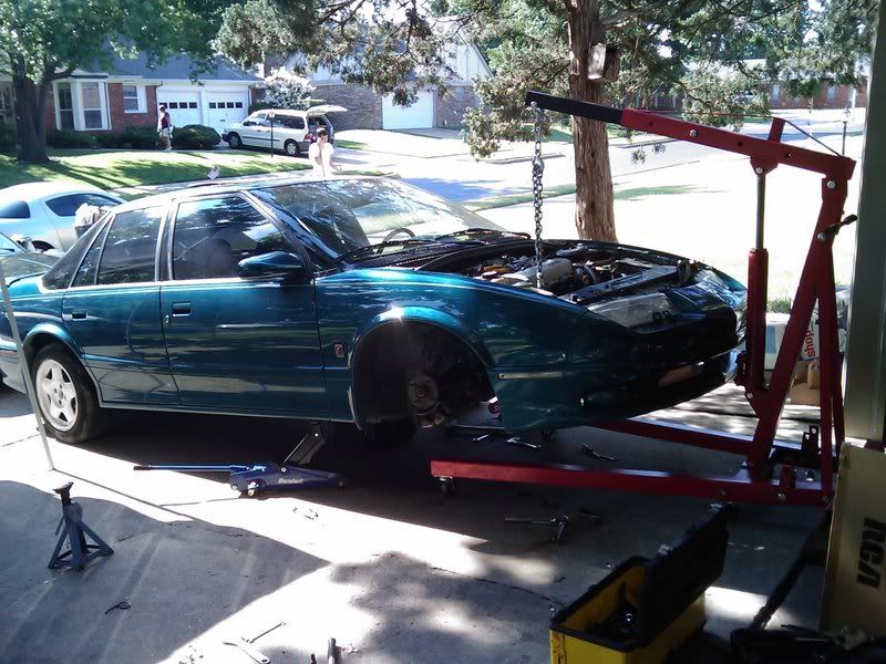

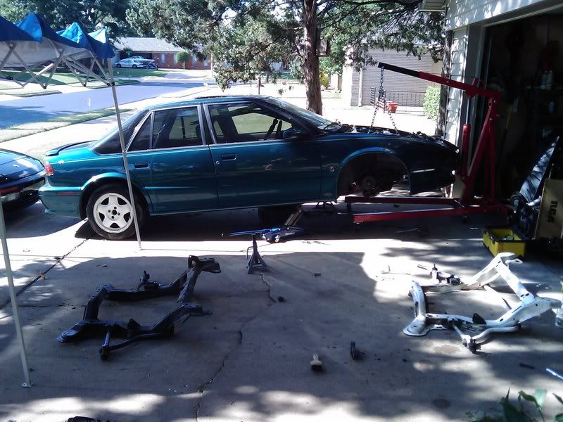

          Almost done getting the front-end fixed up. And just got done fixing my computer. Now both my XP and Win 2000 drives work! As opposed to none lol.

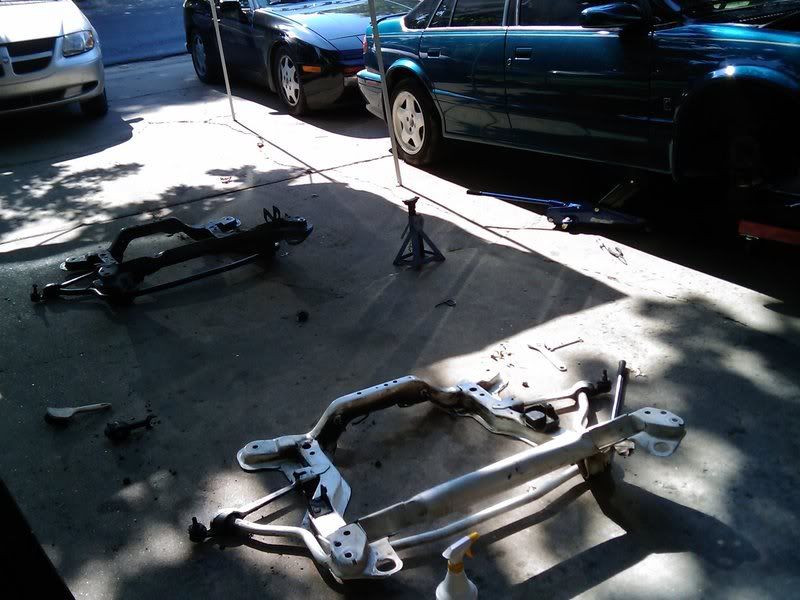

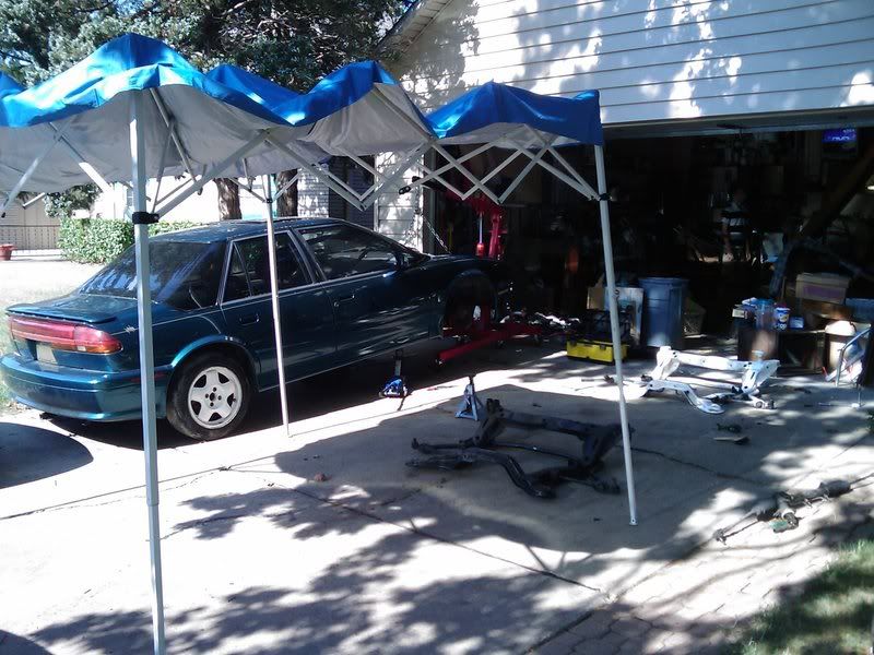

          Put the drop springs on, swapped out the sub-frame. Had to modify the lower rad supports. NOT DIRECT DROP-IN!!!. Not for a 1992 SL. Lower rad supports on the SL sit lower, more recessed than the 1g SC design. At least they did on this one. I can take pics to show.
          Also swapped out the SL rack for an SC rack. Will be getting stainless lines from Tirerack and maybe some higher boiling brake fluid. That'll compliment my brakes for now.
          Need to get the Kumho's swapped from the Old wheels to the new ones... And I need to paint the wheels. Will require stripping them. They are white now. Doesn't look bad IMO, but I wouldn't mind a darker bronze to compliment the darker green of the car.
          Pics will be up soon. Gotta bolt up the suspension and do some wiring.

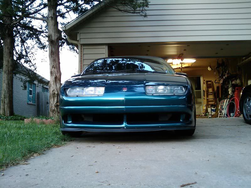

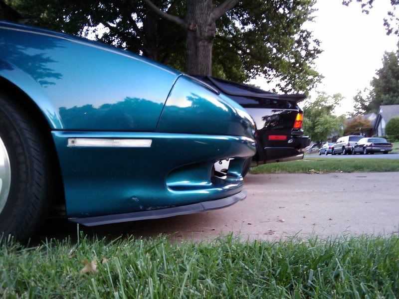

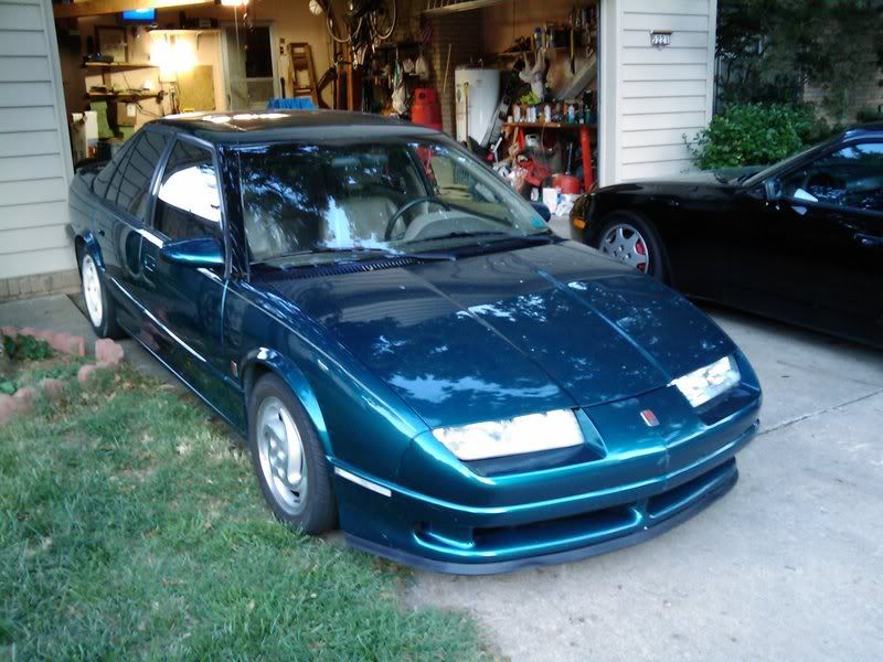

                As you can see, I had a little fun with the front-end there, and put some trim shit on. To be honest, it actually looks kinda cool. I might keep it. If I decide it's gh3y, then all I have to do is yank it off.

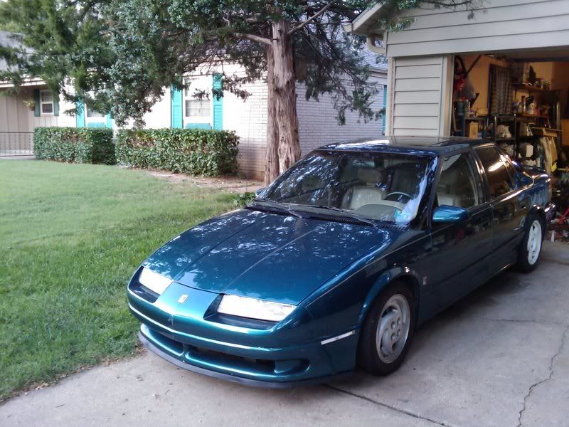

                          NEW/LATE ASS UPDATE!!!
                          Been driving the car daily for about a year straight now. Have new tires on it (all/weather Falkens). Got all the white wheels on the car so everything matches. I'm still planning on cleaning the rims up so I have a polished/painted theme going on.
                          Someone busted my Driver's side mirror off, so I am currently stripping my passenger mirror and a donor, for semi-gloss black, which will match some of the exterior trim that I'm repainting.
                          Fashion lip 1.0 didn't live through the snow. It got pretty torn up (like Kimbo on Christopher Reeve, bad). So I'm gonna go back to Lowe's and get some more garage door trim for a second try. It should work out pretty well!
                          I finally upholstered all the upper trim, and the headliner in Microsued. Some of the adhesive isn't holding so I'm going to go back over it, before I take pictures for you.
                          I promise when I upload pics, you will all love it!
                          Oh, also... I rebuilt the radio harness (after the last break-in) and put a new Pioneer HD head unit in. Hell yes.
