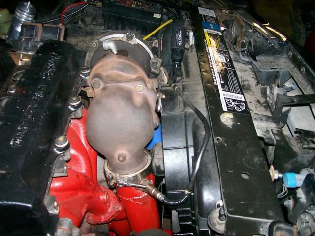

    This is the adapter made specifically for the turbo i have. I mocked it up out of car cause i was waiting to get the blue beast yet.
    Here is how it looks mounted in the car.

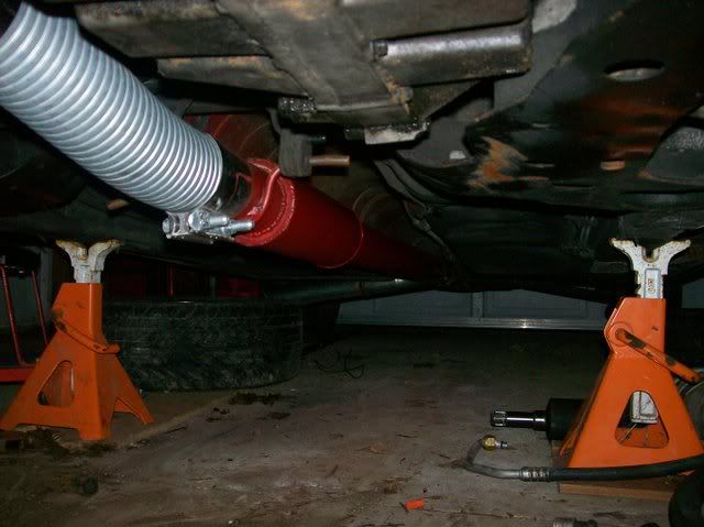

    Got some pics today. This is my intercooler mounted. Can't get a good veiw of it but it is all there.

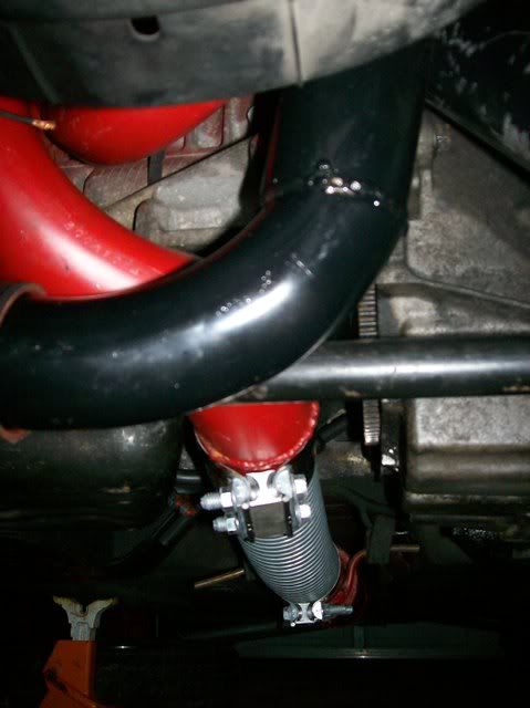

    I know the engine bay looks bad right now, but don't worry it will look worse when it is all done. I still have to fit a battery in there some where! below is also one of the 3" flexpipe and you might be able to see some of the exhaust further back.

        Do you have a brace on your turbo, or is the pipe holding it up?
        88 Quest: Stock bottom end g54b, NJV head, Hurricane MPI, 70 trim, SDS.<br />Neon6: Caged, Gutted, awaiting motor<br />69 Camaro: Small Block
          Re: 1994 Turbo Build
          very creative build
            not bad. +1 to bracing that kneck for the manifold.
              Okay guys i don't know where i was but i haven't kept up on this at all. I have a custom manifold. It is not the greatest thing in the world but it works. It is also not the same as pictured above.
              There how does that look.

                      I think that's Ian's old manifold I almost bought before I bought my whole kit. Looks great.
