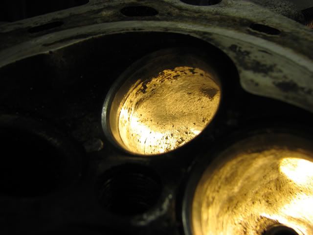

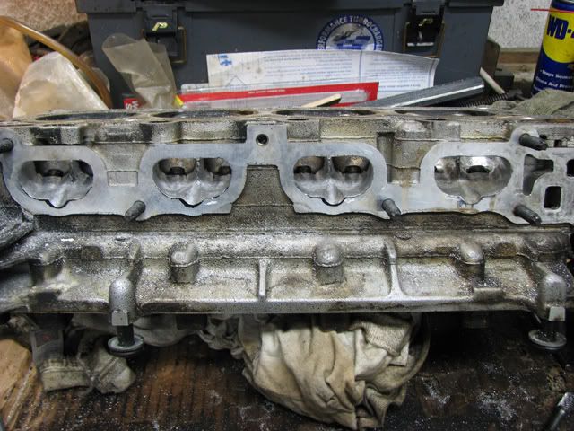

    - Valves

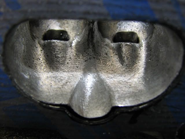

    - Head
    - Head Porting 1
    - Head Porting 2
    - Head Porting 3
    - Head Porting 4
    - Head Porting 5
    - Head Porting 6

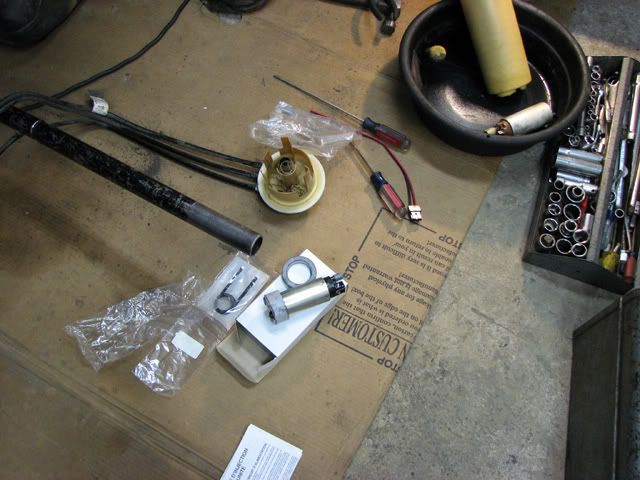

    - Walbro Install 1
    - Walbro Install 2
    - Walbro Install 3
    - Walbro Install 4

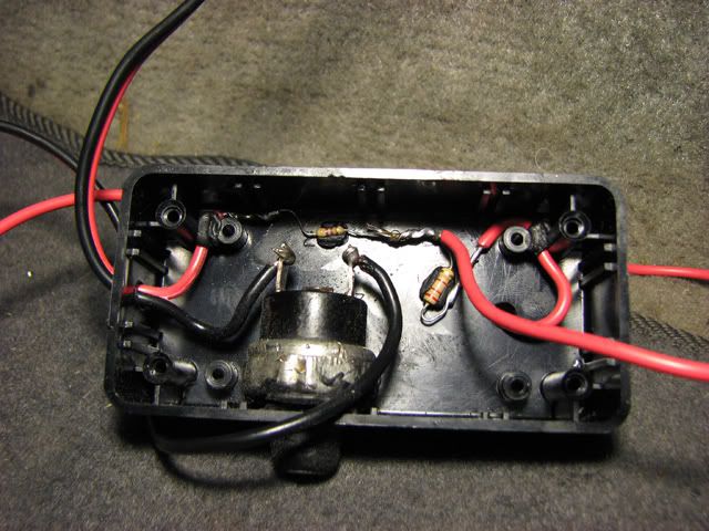

    - DIY Volt Booster that I got flammed for on PR

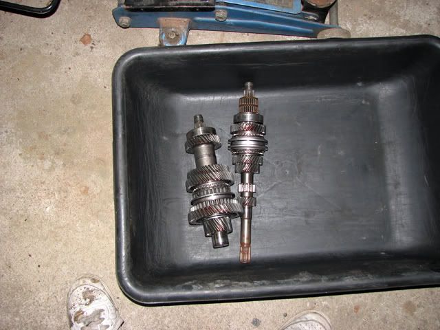

    More Progress:

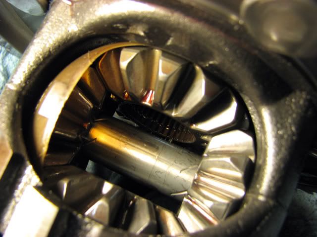

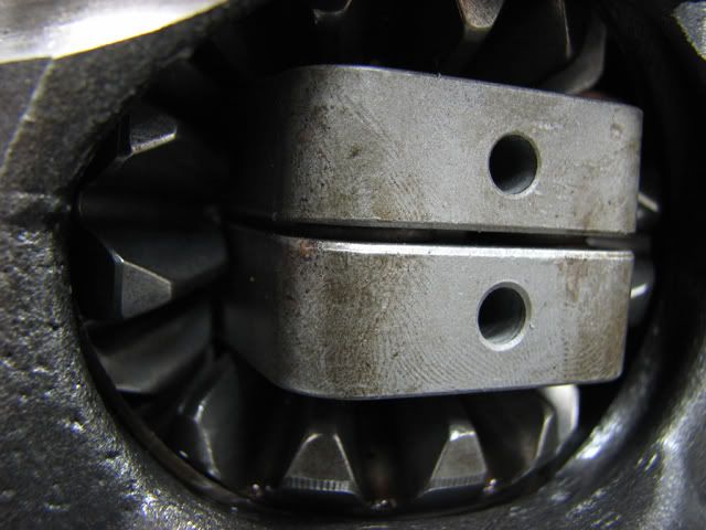

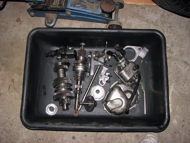

    Well I took the transmission apart today (MP3) with the help of my cousin...and I was kind of dreading how you have to take everything apart to get at the differential. But, after doing it, I realized that it was a real simple process. The tranny seems to be in very good condition. The pin, spider gears, and roll pin all look nice. I'm starting to think that even if this car had 176k miles on it, that the previous owner took very good care of it. Next comes the PG and welding of the diff pin.
    Transmission Disassembly 1
    Transmission Disassembly 2
    Transmission Disassembly 3
    Transmission Disassembly 4
    Transmission Disassembly 5
    Transmission Disassembly 6

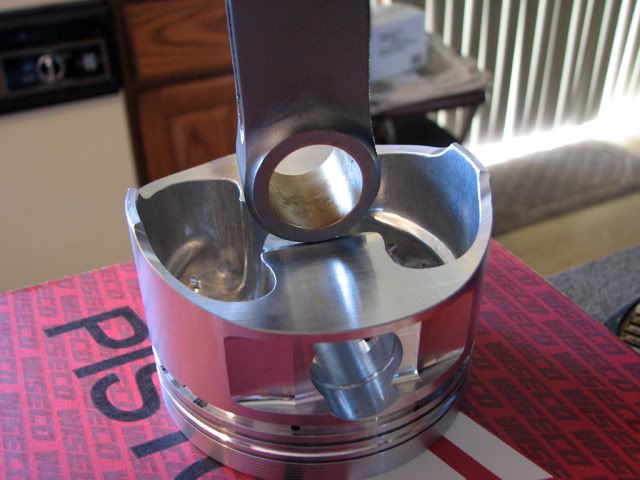

      Well, today I brought everything for the turbo project to the machine shop. The guy is a long time friend of my dad and I know that he does quality work. I hope that it doesn't take too long lol. I really want to get this project done.
      List of things that he's doing:
      Balancing
      Bearings
      Re-surfacing Flywheel
      Honing Block for more clearance for forged pistons
      Machining Rods so they fit into pistons (sides, tops, and boring out bushing a couple thousanths)

          Re: Scott's 1993 Boosted SL2
          You're going to have a hell of a time getting that trans back together.
          Good progress though.
            Originally posted by JRSTANGE
            awesome!
            Thanks
            Thanks. It shouldn't be to hard...I have my FSMs if I forget anything lol.

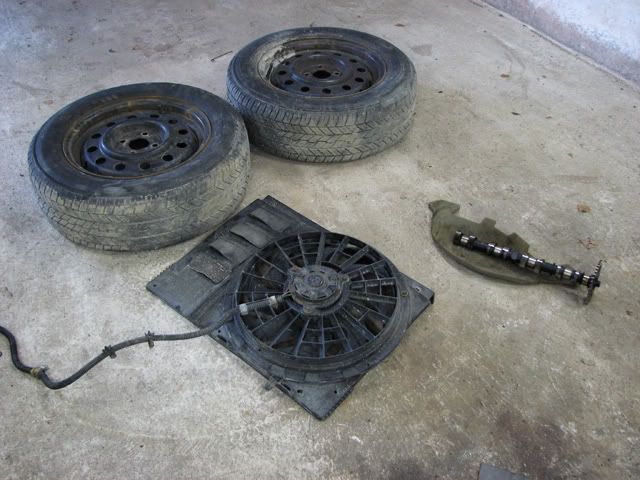

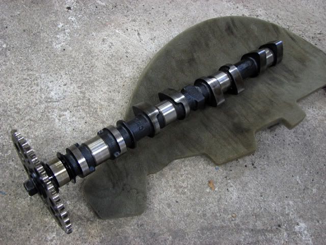

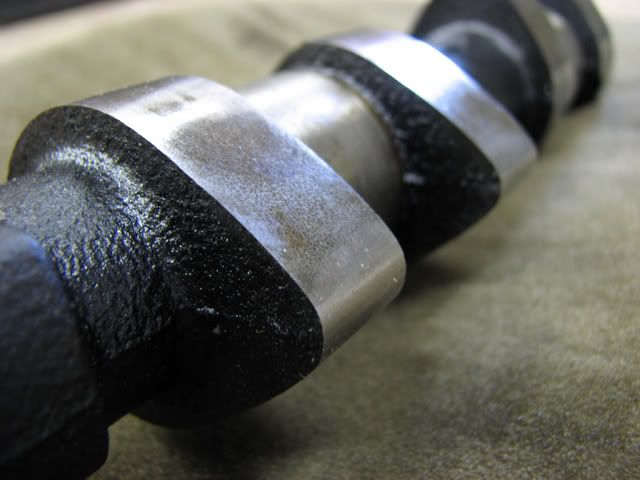

              Got some more goodies today from the boneyard. Intake cam from a 95 wagon, fan/shroud from a Volvo 940 (not sure if this will work yet), and two steel rims for my slicks (with some decent tires mounted on them already). Also ordered an oil pump and .030 shims from SDA [img]{SMILIES_PATH}/smile.gif[/img].
              Boneyard Run
              Intake Cam 1
              Intake Cam 2

                2 intake cams and a stock intake? 25 psi? good luck.
                2005 Legacy GT
                2004 Vue V6 AWD
                1995 SL1
                  Lol yeahhh buddy! . We shall see how everything holds up lol.

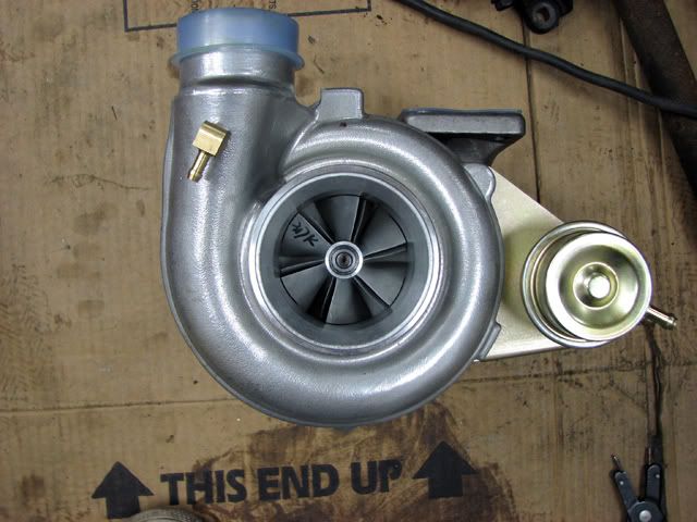

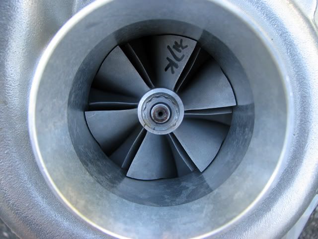

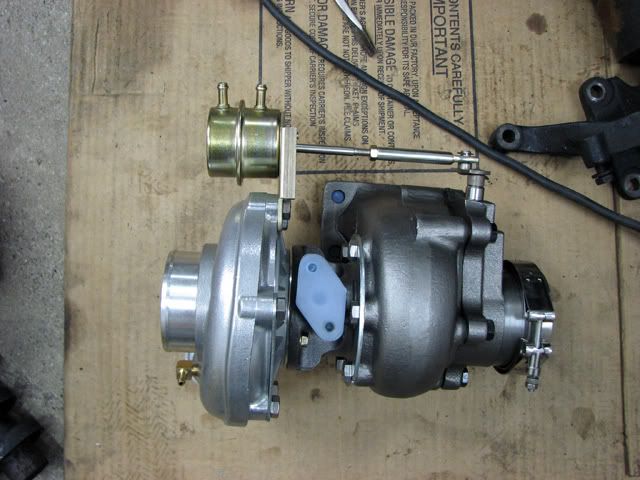

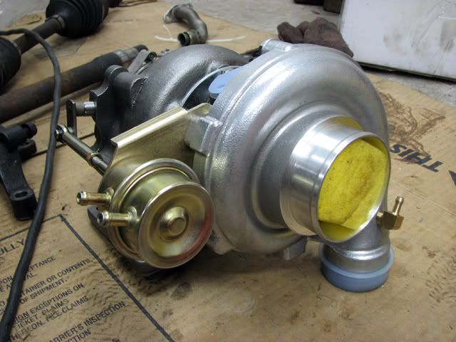

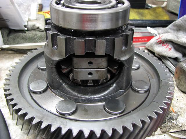

                    A little more progress tonight: Got the Phantom Grip installed, and checked my wastegate. It seems to hold up to around 25-30 PSI so I'm excited [img]{SMILIES_PATH}/smile.gif[/img]! My dad will be welding the diff on Saturday.
                    Pics of Progress and Turbo:
                    Phantom Grip 1
                    Phantom Grip 2
                    T04E 1
                    T04E 2
                    T04E 3

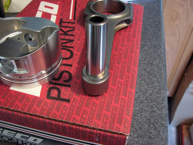

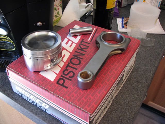

                      it the angle of the picture, or do the rods not fit into the piston?
                      Otherwise, the progress looks good.
                      Tristan
                      1997 SC Turbo
                      1999 F-250 Powerstroke SD
                      1999 Cavalier RS
                        No it's not the angle of the pic, you are correct. I had the machine shop take some material off of the top of the rods (because due to the way that the pistons are made: the strength of the piston is where some material would have had to be removed). Ricesucks!!! told me that he had to get some material removed from this same job number (00711-2736, I think) from Wiseco. I'm not sure why these pistons are made this way? But, the machine shop called me this morning and I'm going to grab all the stuff in a little bit. I should have some new pics up shortly.
                          wow, internal wg with a boost reference port for say a ebc. interesting.
