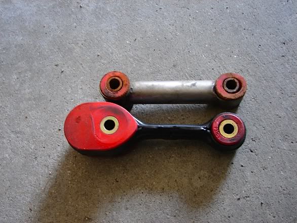

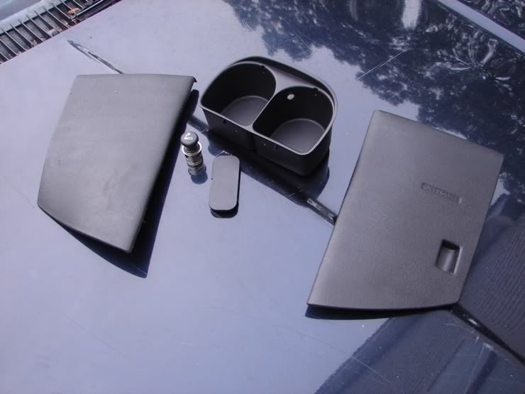

            Little Things: Dogbones (03.25.10)

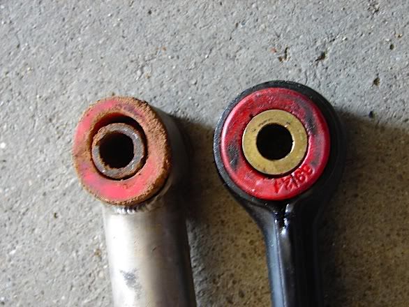

            Today I randomly decided to finally swap out the Twistec mounts for the Summit/OEM mounts I had leftover from the SL2. Despite the horror stories I've heard about Twistec products I was still shocked at what I pulled out. After getting everything squared away I took the car out for a quick spin; even in just firing her up and letting her idle there was a huge difference!

              Lucky you. Both my twistec mounts where fuuuuuuuuuucked up. The lower one was just slightly worse than yours in the second pic. But the upper was trashed.

                  lol, explains the limited damage to the POS. My first one broke >2 months of being on the car, the second > 6 months. Fail.

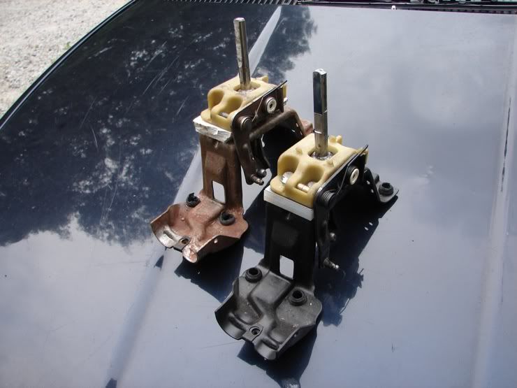

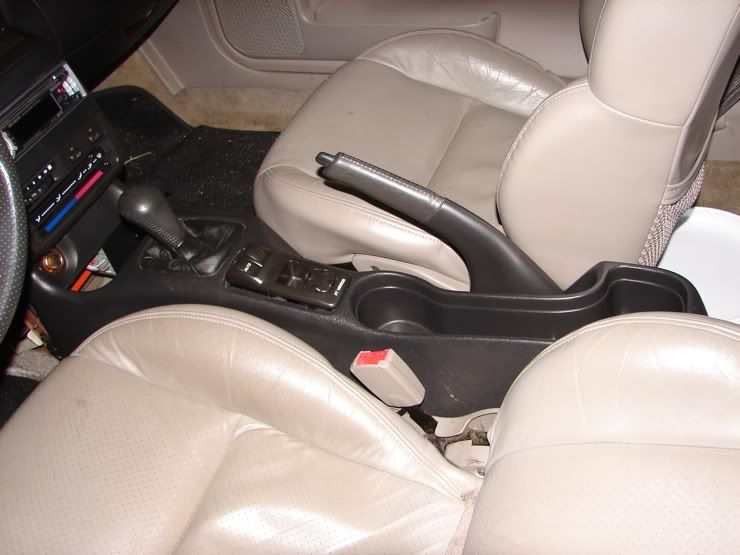

                            I came across a lot of early pictures from when I first got working on the car. I'll start with the interior. When I first got the car the interior was in decent enough shape though it was missing some things (other things were broken) and in dire need of a thorough cleaning. The center console didn't fit properly and as a result the forward tray and kick panels weren't in place. It wasn't until the car started going hard into first gear that I discovered a questionably built short throw shifter. It had a raised pivot point but without the extended cable pivot points. The piece used to raise the main pivot was too tall for the console to sit over, hence the loose fit. So I sacrificed the short throw shifter I had built for the SL2 (also with intention of building a nicer one for the SL2) and swapped that in. With a proper shifter I was able to put a lot of things back together. Elsewhere I replaced the pieces that make up the center vents (broken and distorted from the previous owners routing of the SAFC wiring), the cigarette lighter (not sure why, I don't smoke), and the face/knobs for the climate control. Upon reassembly I re-routed the SAFC wiring for proper fit of the trim.

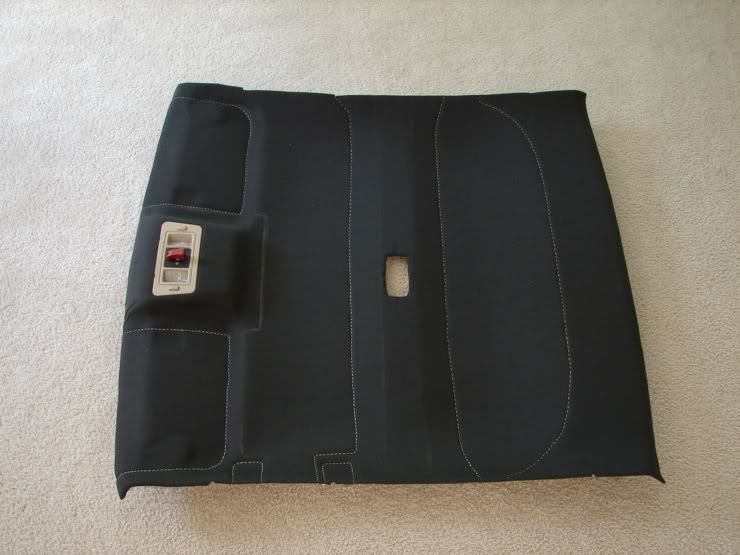

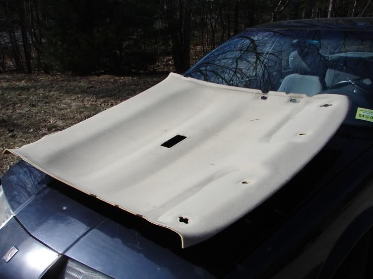

                            More recently I got around to recovering things overhead. The headliner was dirty, torn, and sagging and recovering it would also give me an opportunity to some OEM map lights. I tried hunting for an actual 1G SC2 sunroof headliner to recover but ended up grafting a map light section (saved from "Daily 1") into my existing headliner. This was accomplished by feathering the edges of my graft piece into the headliner surround then cutting out the area for the map light cluster to sit in. When all was done I prepped the headliner and covered it in a charcoal padded material with spray adhesive. Feeling a little creative I had some of the contours of the headliner contrast stitched with a tan thread to match the interior.

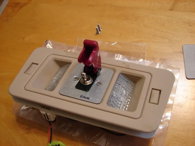

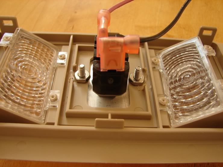

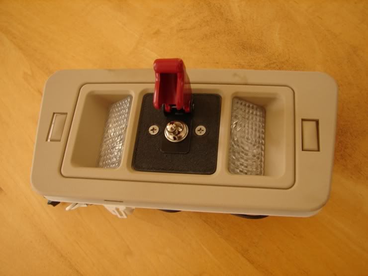

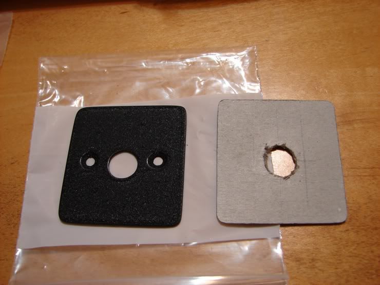

                            With the map light cluster I had an empty spot where the sunroof toggle switch used to reside. After some debating I deemed it a good spot to mount a manual fan switch. I first created a template in cardboard to get an accurate outline and layout the holes for the switch and mounting hardware. For the final piece I dug up some scrap sheet aluminum to transfer the template onto. After test fitting things and tailoring the piece for proper fitment I prepped the plate for a few coats of a black wrinkle finish. I had to do a little trimming on the backside of the map light cluster to have clearance for my the hardware. I installed the plate with countersunk stainless steel screws. For the fan switch wiring Dad helped me pin out and tap into the wiring from beneath the under-hood fuse box. I ran the wiring up the A-pillar (secured with some painters tape) and connected it to the switch with some flag terminals. For the map lights I simply spliced into the wiring for the dome light. The switch and toggle cover are from McMastercarr.

                            The map lights/fan switch and headliner I just recently installed. I am still in the process of finishing the sun visors so pictures of everything will come after those are installed. Other un-pictured alterations include a much nicer SAFC mount, another gauge cluster with painted needles (the trip-odometer quit on the original cluster), and a new head unit.
