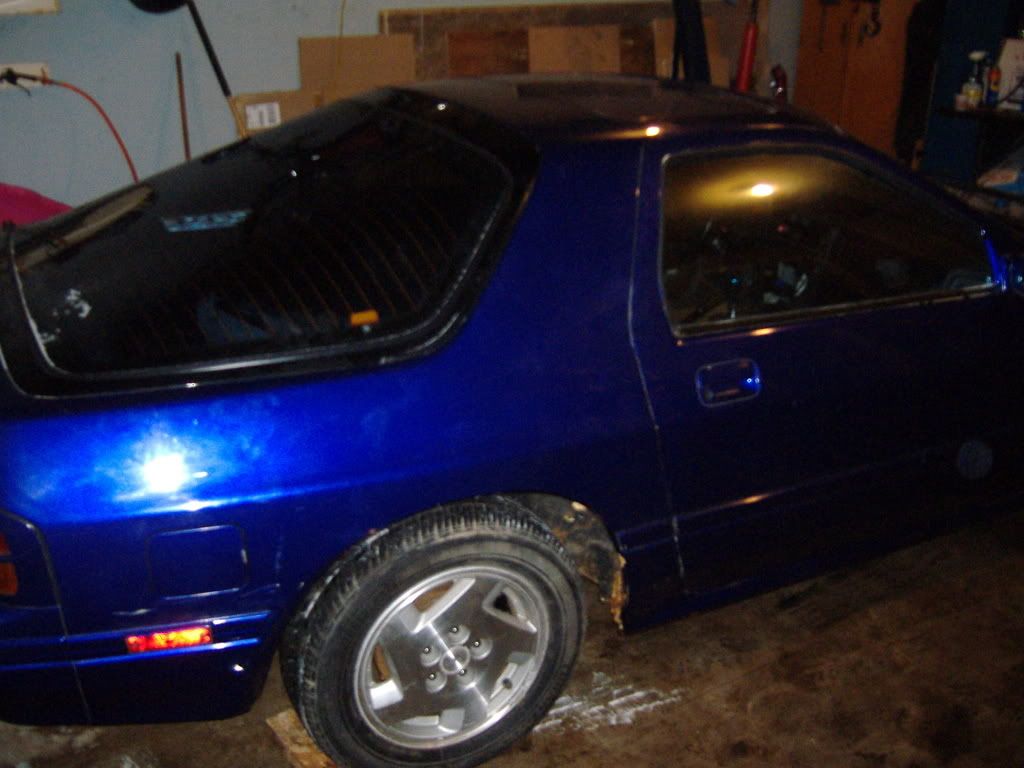

    Here's the car as it sits now. I've made a ton of progress since it got into this garage.
    The pictures kinda suck...my garage is dark and the flash overexposes them...the car is cleaner than what the pictures seem.

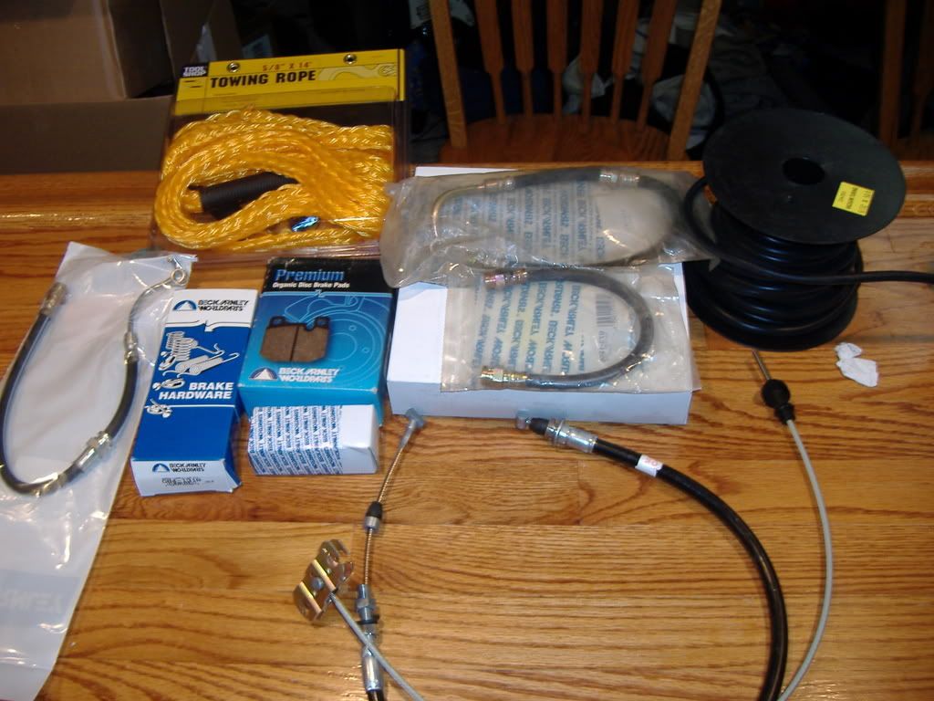

                Parts are showing up!
                There's one part for my Saturn in this photo, can you spot it?
