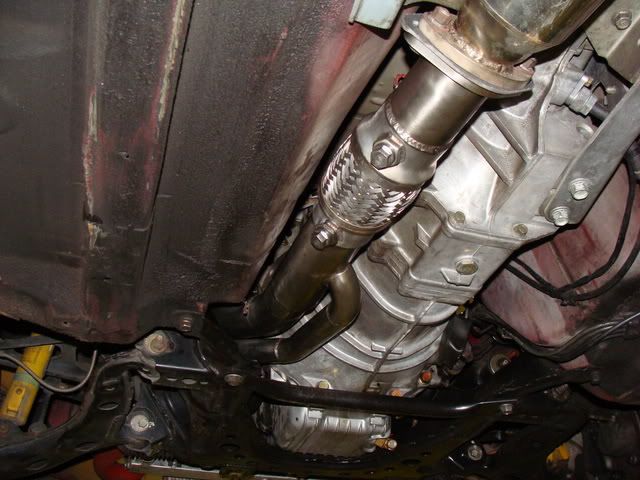

        Finally installed the new downpipe Saturday, this is about the best pic for now.
        Full boost is right there, and the car is definitely pulling stronger now over the previous DP. Had some boost issues with it after install, but it seems to have fixed itself. Only problem I have now is that the WBo2 bungs are on the lower half of the pipe instead of the upper half, but I'm working with the vendor now to get that resolved, and they are being great about it!

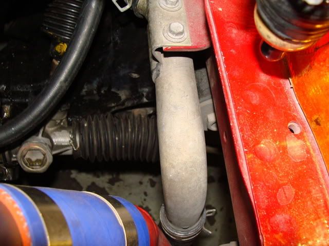

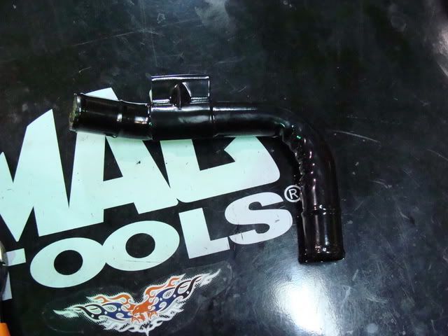

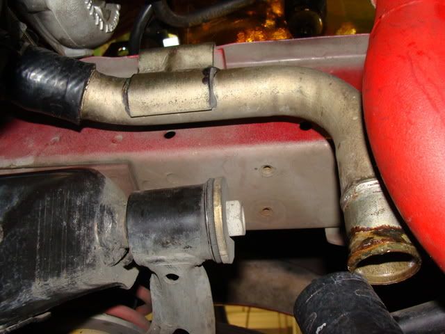

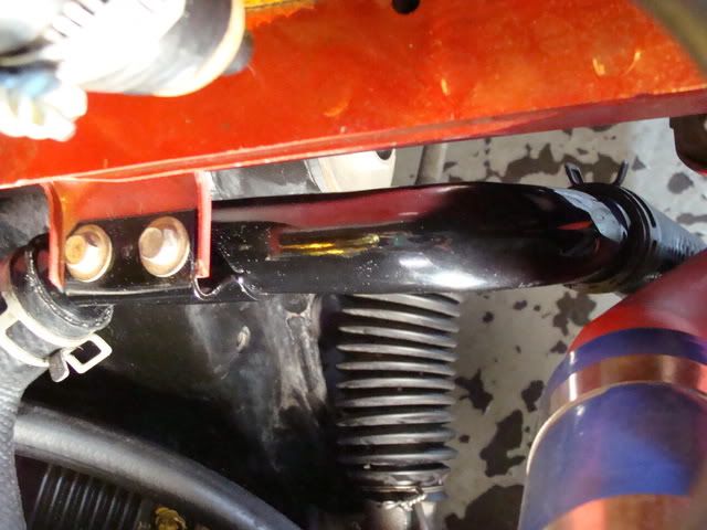

          Found out that my boost issues mentioned in the post above were caused by the wastegate flapper getting stuck on the divider inside the collector. So the whole downpipe is getting replaced. I'm upset about that to say the least.
          Anyway, do you ever have one of those things about your car that is so small and minute that it shouldn't matter, but you see it, and want to do something about it? Well, my engine bay eyesore has been the hard coolant tube that runs right near the exhaust manifold. Looks like this:
          I've hated it. Well, I ran across someone selling this powdercoated tube:
          So I bought it and I installed it.
          Much cleaner. Now on to find the next thing. lol

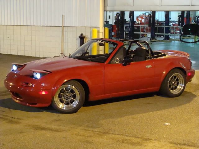

                So not really any news but one of my friend's stole my digital and took pictures and videos of me driving. There is only one video that came out somewhat clear, but all you can hear is the loud ass S2000 he's in and I don't think it was that great of a video.
                Evidently this is what I look like when I'm racing and passing someone who I don't know is taking my picture.
                And about 1 second later...

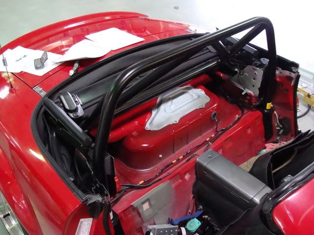

                  Re: RotorNutFD3S' 1995 Turbo Miata

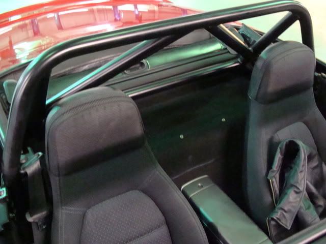

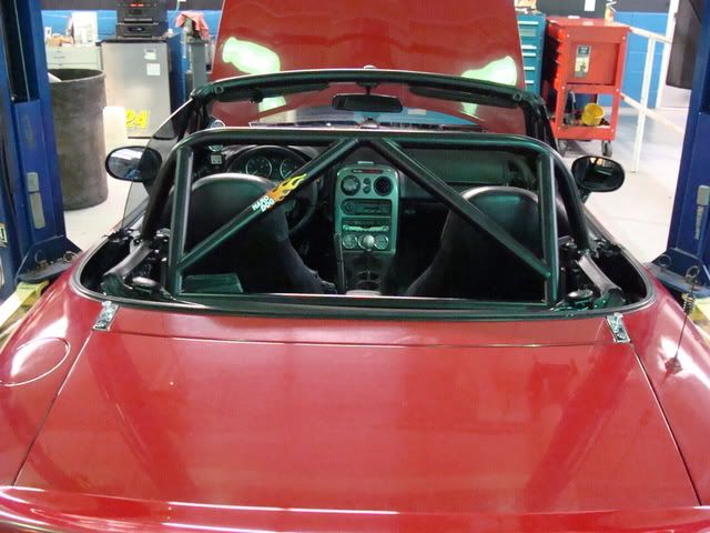

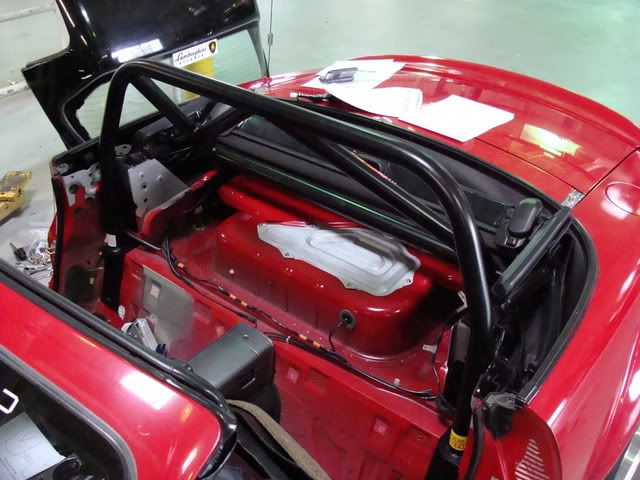

                  Now I know why shops charge so much to install these things! It's very time consuming, and not exactly the easiest thing to do. But it's not extremely difficult either.
                  Here's some of the pictures I took along the way. I wasn't going for quality or clarity, just wanted to document the process.
                  Ok... So this has to go in there somehow.
                  Well, I'll just rip everything out behind the seats except the soft top.
                  Cut some metal away, shimmy the bar past some wiring harnesses, and hey, it fits!
                  There was a lot of time between the last shots and this one:
                  Definitely like this much better!
