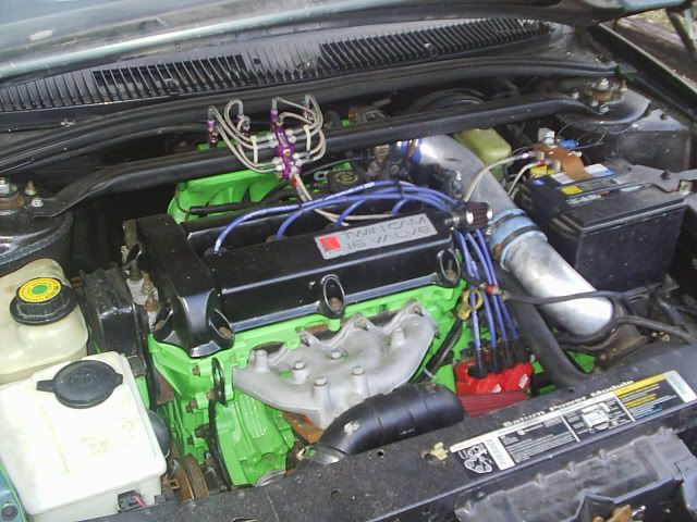

  • The green wagon runs...
    its a 95 SW2
    low mileage 02 engine
    forged rods
    balanced
    dual intake cams
    valve spring shims
    pretty heavy port and polish
    95 intake manifold
    geo storm tbi
    ZEX direct port n20 on a window switch 3200 to 6800 rpms
    fidanza aluminum flywheel
    act 6 puck
    Aem uego wbo2 sensor
    random cheapy boost gauge
    Megasquirt 3.0 (for fuel only)
    Msd Dis 2 + coils and adaptors
    Accel 300+ wires
    Ngk V-power plugs
    DSM exhaust manifold
    85 volvo garret (airesearch) turbo internal wastegate (8psi??)
    99 regal supercharged injectors
    Mp3 swap
    No A/c
    Some random DSM intercooler (kinda ghetto, but its mounted solid)
    Volvo radiator
    cut/removed front cross member
    EBC slotted/x-drilled rotors
    volvo BOV
    body kit.

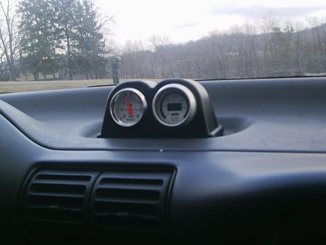

    Gauges.
    Engine.

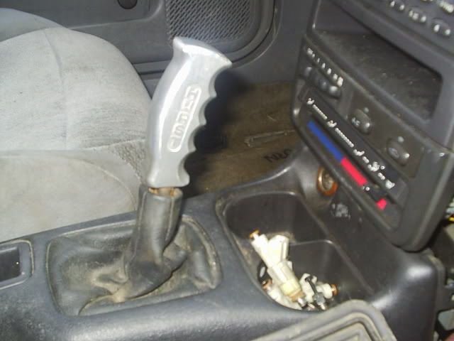

    Shifter.
    Now that its running, (need to work out a small bug, it goes lean for a second right before full boost) I have a few odds and ends to sort out, like finishing the exhaust, changeing the interior over to black carpet and black leather sc seats, some body work,(better body kit fitment and some filling here and there, and a DSM hood scoop to clear the nitrous ports alittle more.) some painting (Ion- sublime lime green, with a black hood and black roof,)
    Some decaling (small neon green biohazard symbols on the rear quarter panels. and a thick black pinstrip above the body line. need to sandblast my 17" wheels from the blue wagon and paint them, either black or bronze and replace the 15's that are on there now, and then I'm going to work on some sterio instalation

      Again, can you explain why you have the nitrous plumbed like that? With a turbo, I'd bet a single fogger would be plenty.
          Why? Cause I like it there, It worked on my other wagon, I already had the DP setup, and its pretty.. [img]{SMILIES_PATH}/smile.gif[/img]

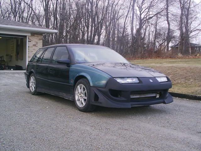

                    looking good with all the hybrid parts. What color are you planning to paint it?
                      Re: The green wagon runs...
                      body will be ...
                      GM Sublime Green Metallic
                      SKU: GM-46U/WA915K
                      This is an actual color of your vehicle. More details...
                      Color Code: 46U/WA915K
                      Color Description: 03 Saturn Ion Sublime Green Metallic
                      Its a bright neonish metalic green color.
                      And the Hood, Roof and Wheels will be high gloss, base/clear Black
                      <br /><br /> 95 sl2 dd<br /><br /> 95 sw2 -&gt; turbo/n20 project (normal bolt ons, forged rods, fidanza, dsm manifold, airesearch turbo, Zex wet dp, msd dis2, and MS<br /><br /> 03 l-200 -&gt; the wifes car (I'm not allowed to even have a key)<br /><br />[quote author="plastic torpedo"] Damn, that nitrous &quot;octopus&quot; looks intimidating!<br />A shot of anti-lag FTMFW!!!![/quote]
                        Progress is slow... trying to finish it.. got the body kit all mounted up solid, and started roughing in the body work, where the seams meet, its not exact, and I want it to at least be close, not 1/4" gap on one side, and no gap on the other, also, have noticed that the body kit is alil wavy, but, its to be expected, oh well, I'll straighten it out eventually.
