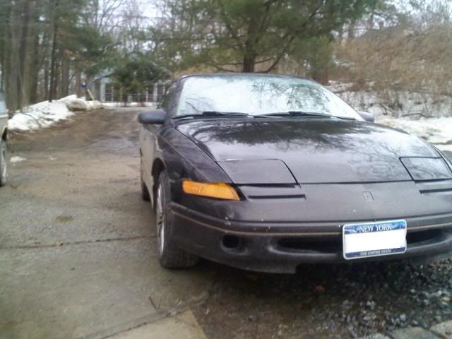

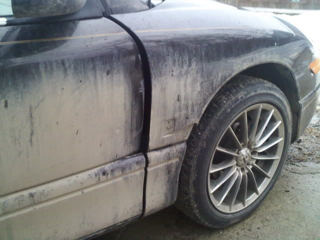

                        Re: Xylaphobe's 1995 Sc2
                        Pictures of winter grime, and passenger side damage as well as passenger side headlight damage, the hinge is bent, still operates, but its crooked.
                        -Walker - 2006 Volvo V70R
                        1995 SC2 - Killing me slowly -

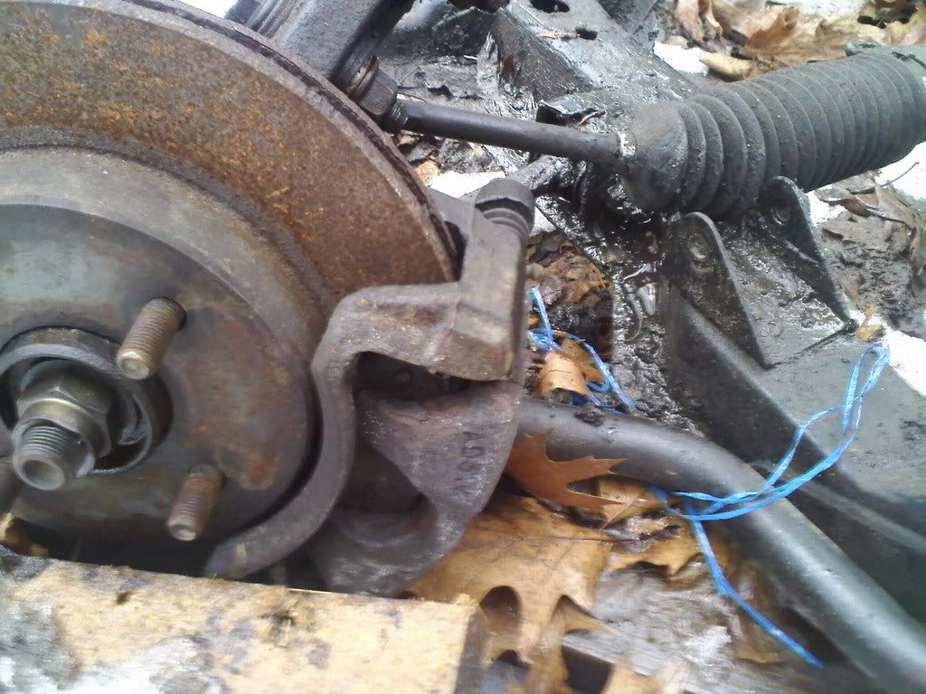

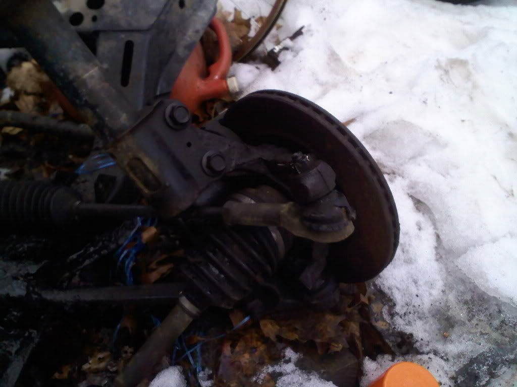

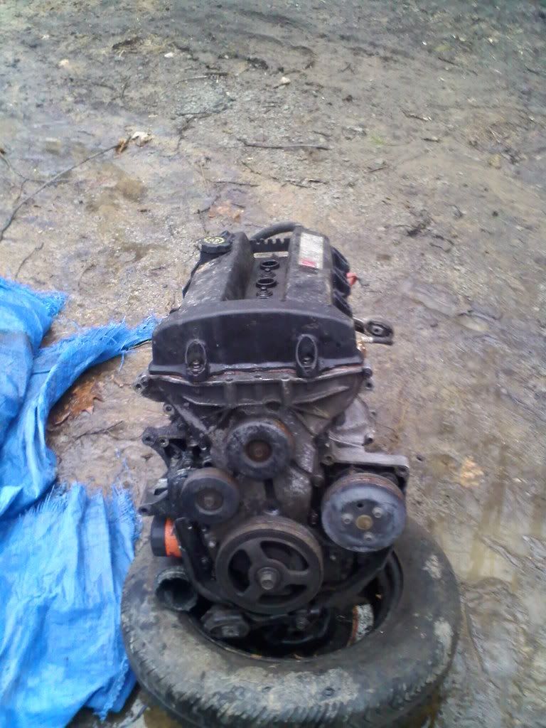

                            I have a donor front cradle that I got from a friend's friend, not 100% complete and unknown but supposedly low millage. I'm totally rebuilding it so its not going to be a big deal because its getting bored out and decked so all the surfaces will be fresh.
                            What I'm going to use:
                            Block
                            Crank
                            Head
                            Cams
                            Oil Pan
                            Water Pump
                            Valve Springs
                            Lifters (inspect)
                            The water pump was replaced shortly before it was pulled so I'll take a look at it and likely reuse it.
                            I'm going to swap to a twin intake cams from my current motor but I want to have as little down time with my car as possible. So I think I'll, remove the nub/tab, build it with normal and swap it later unless its a real bitch swapping them while their in.
                            as far as valve springs could I get away with buying shims or just spring for new ... springs?
                            I'll probably scrap the autotragic, I don't know its history and wouldn't want to sell it to anyone. Anyone know how these fair as far as weight for scrap?

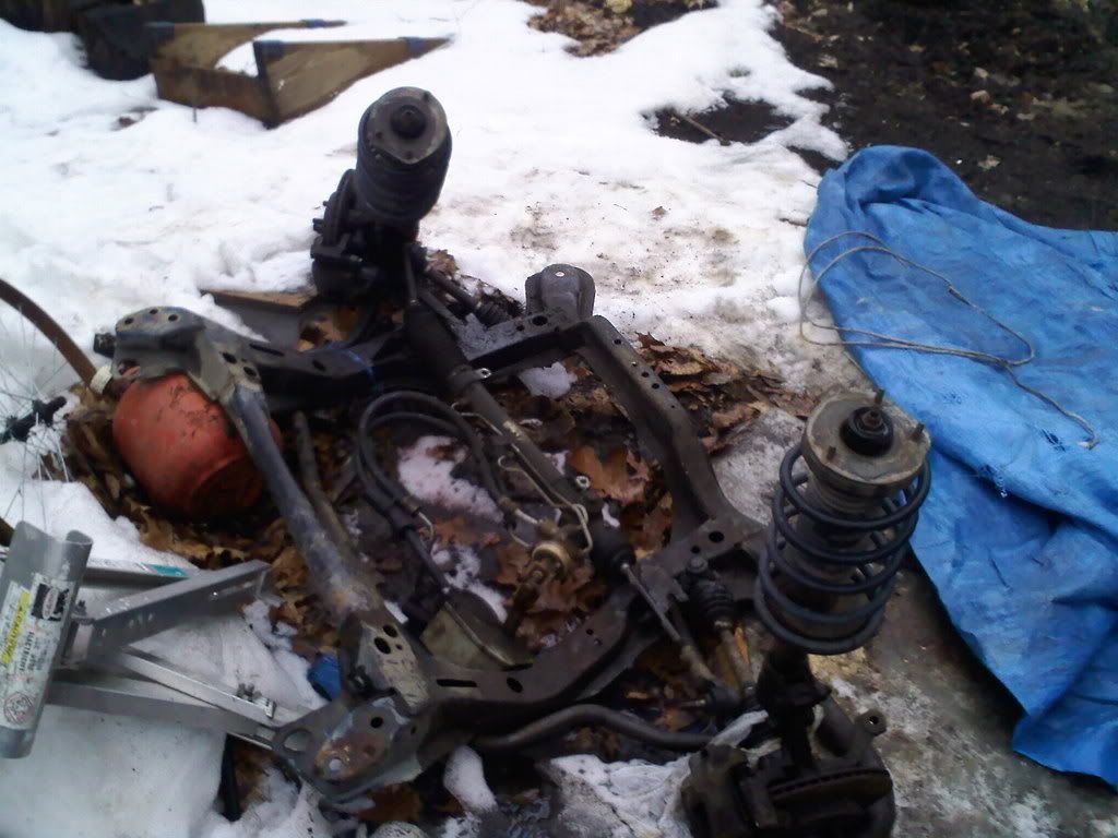

                            With the motor and auto I also got a front subframe.
                            If I wanted to remove my power steering could I just loop the lines from the pump to create a semi manual rack?
                            The hub and LCA look decent no major damage, I'll probably clean them up, paint em, and swap them for mine.
                            The axles were torn apart when the front subframe was dropped so theres a lot of grease on some of the stuff.
