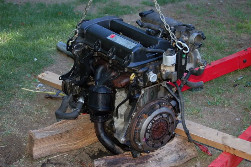

    Aquired was a 96 SC2 with a blown motor, after many days of work to pull a motor and trans from a SL2 to put into this car, it now runs. List of mods will include;

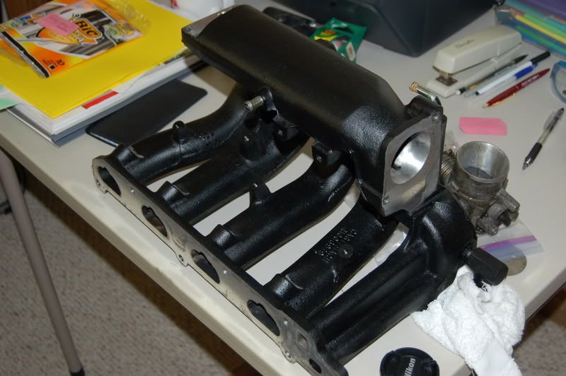

    P&P Throttle Body w/Knife edged plate
    Manifold Mouth matched to TB

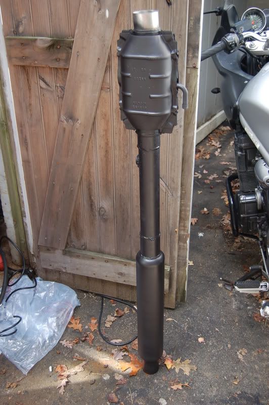

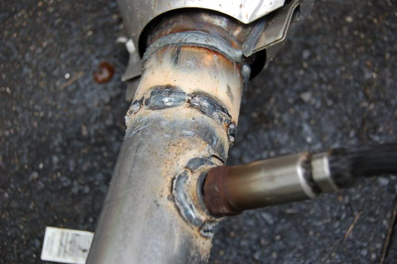

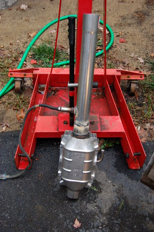

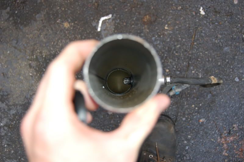

    Exhaust parts have started to arrive, so let the welding begin!
    not the greatest welds, but its sealed, now i need to find my damn wire brush.

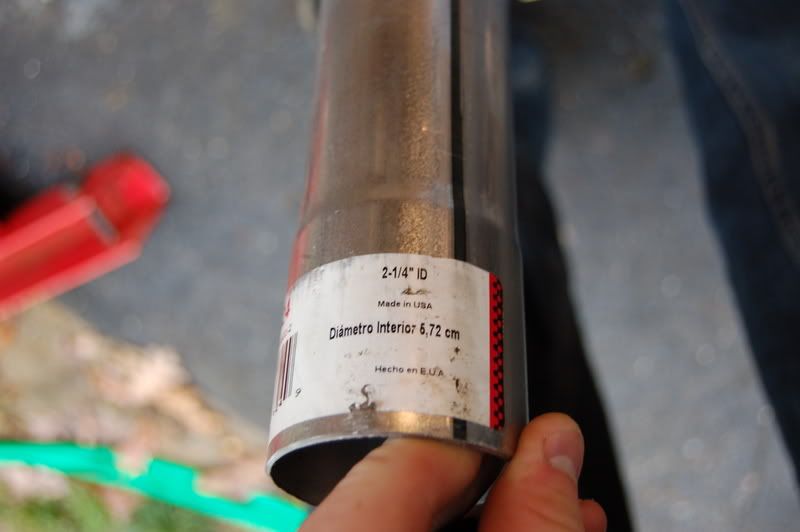

    2 1/4" gotta cut that expanded end off
    vroom vroom lol

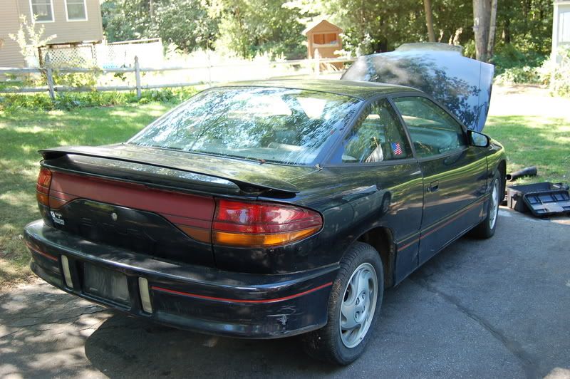

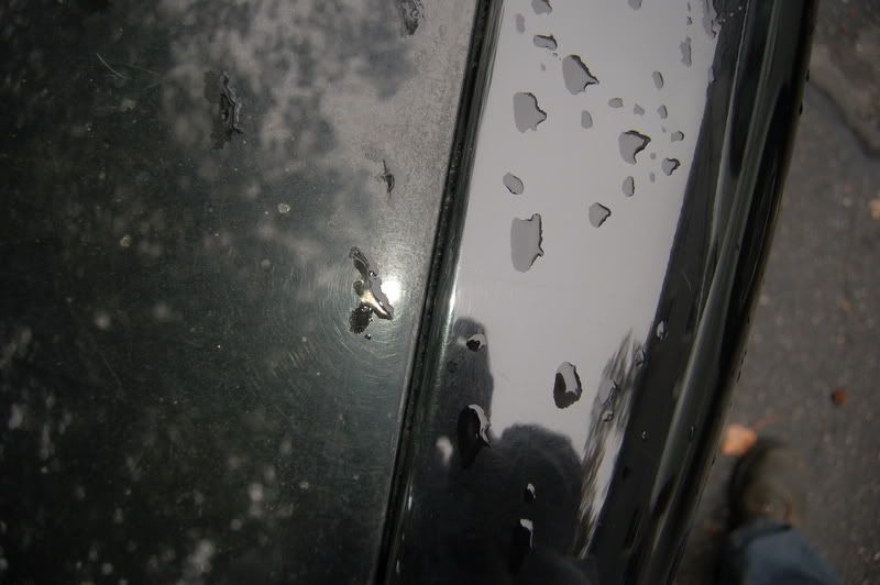

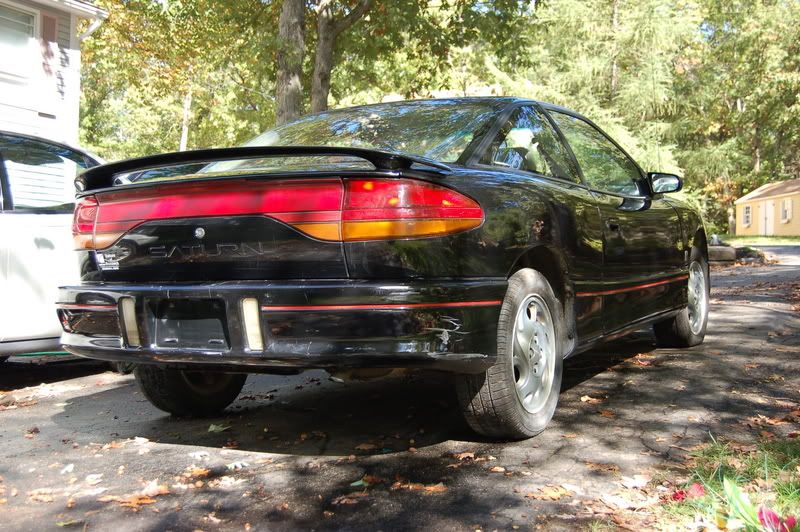

    Also started to clean up teh car, and see what a Mother's clay bar kit would do, left uncleaned, right claybar and wax.
    [color=red]-Tyler[/color]<br /><br />2005 Chevy Trailblazer<br />1999 Saturn SL2<br />2002 Suzuki Bandit 1200

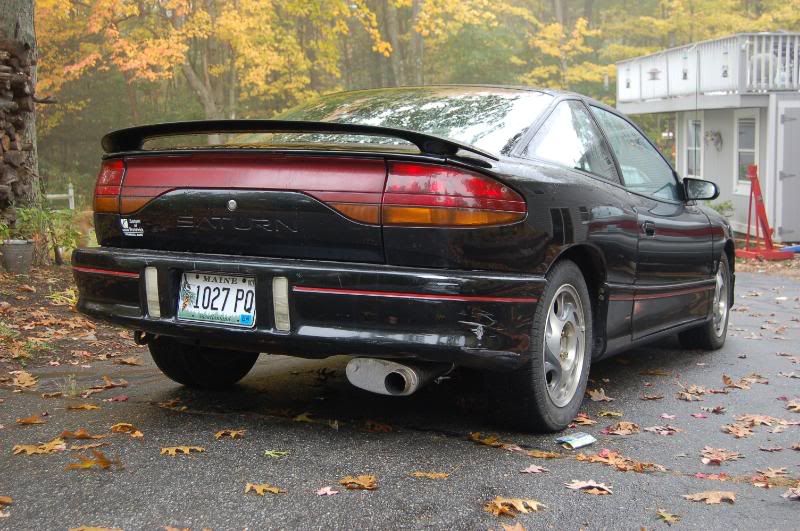

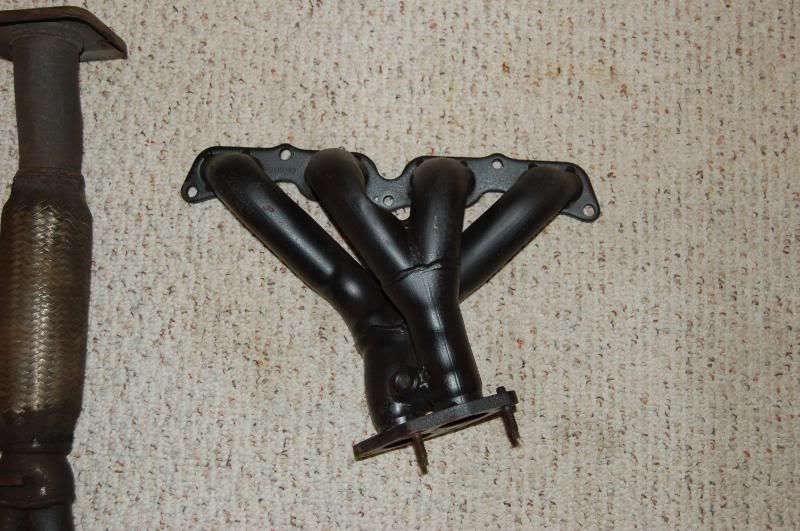

      Important part of the exhaust finished for now, waiting on 92 header to finish my part of teh exhaust then off the the shop to have the bends done. It will all be high temp painted to help make the piping last longer than it did on my 99 SL2. Not to mention it'll look a bit cleaner.

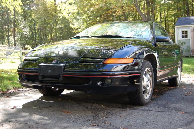

      After a good cleaning, clay bar and waxin' looks good!

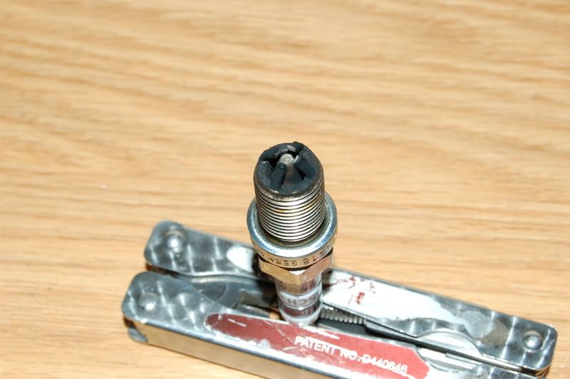

        as i was giving the car a good look over, i pulled the plugs and found this crap
        What is this shit, whoever invented this plugs should be shot, these things are so effin shitty its not even funny.
        so as always, i upgraded to

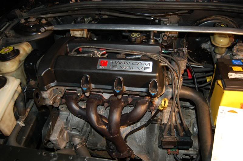

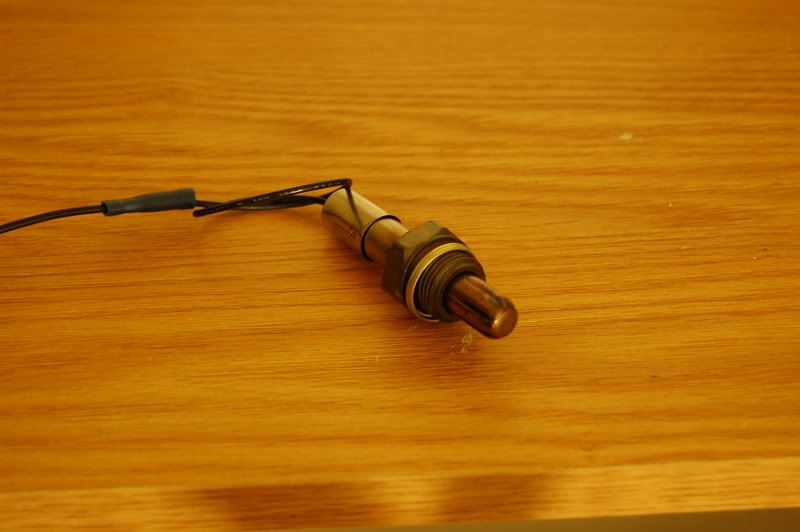

        my o2 sensor also showed up today for the 92 header

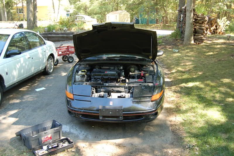

        the car is up on jackstands tonight just waiting for the 92 header to show up tomorrow.
          Good and bad on this update, apparently i was sent the wrong o2 sensor, so im gonna have to figure something out for that, i was hoping to have it on the road in a few days, maybe there will be some universals at napa or whatnot. some update pics

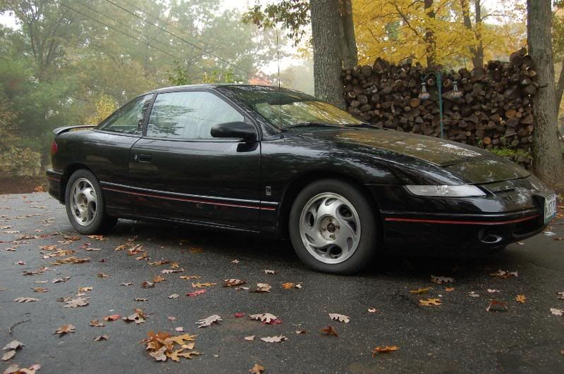

            Done! well mostly, i need a rear hub and two tires and its inspectable now

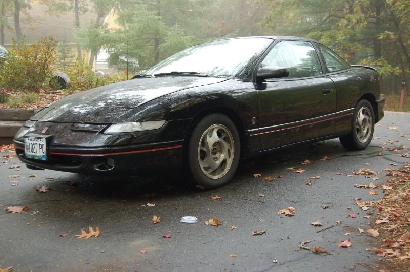

                here's the pictures as promised
                playing with some filters
                semi siloutte

                  Upcoming plans, rebuilt motor with .040" over bore, head P&P'd and decked .040", p&p'd manifold, geo tb, and havent decided on the twin intake cam mod or buy the sda cams. Just want to get some more power out of the dd before i call it outs for a little while, while i get some school stuff situated.
