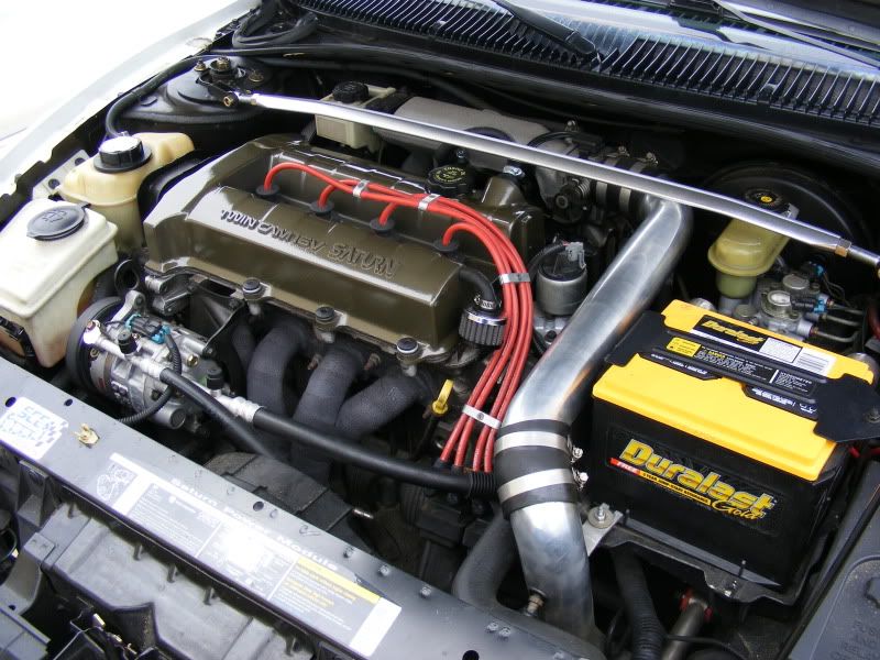

    So I retired the Saturn back in November and picked this up (the black one below). I got it because the Saturn was getting up there in Miles and was starting to be a little more trouble then it was worth. I just didn't enjoy the hit or miss reliability, raspy buzz, lack of a stereo, or neck jarring, bump stop punishing ride anymore.

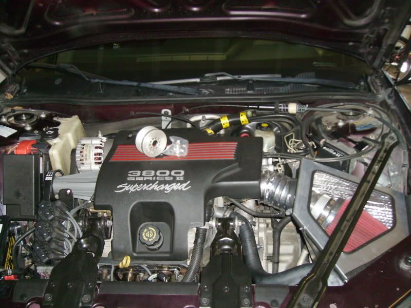

    JMP Fender well intake

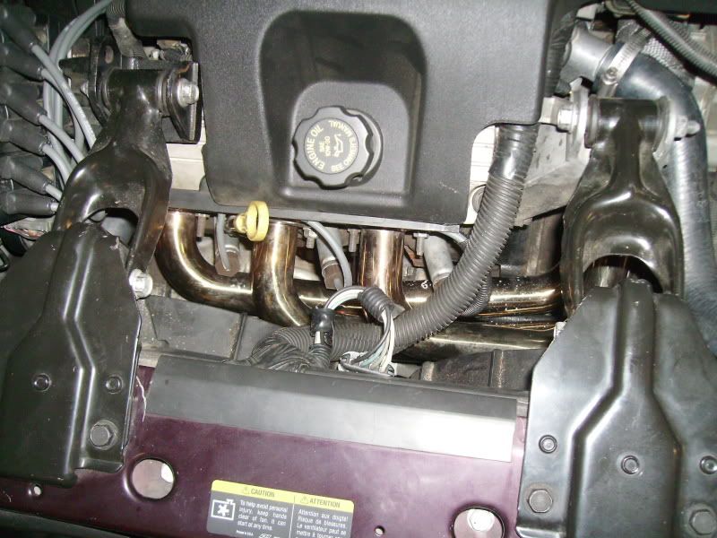

    ZZ Performance stainless 3" downpipe
    ZZ Performance stainless front Power Log. It looks kind of like a cross between a header and a log turbo manifold, headers are over kill and not really needed until you get to the 12's hence the "plog"

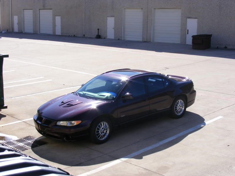

    New OEM style 17" star/diamond cut wheels in Black/Machined finish with the new 235 Hankook Ventus HRII tires that the dealer put on. The chrome stock wheels were peeling and leaking, and the Hankooks are actually pretty decent.
    Completely repainted, thanks mild OCD.
    Needs to be cleaned.
    Intake starts here.
    And stops here.
    The "plog"
