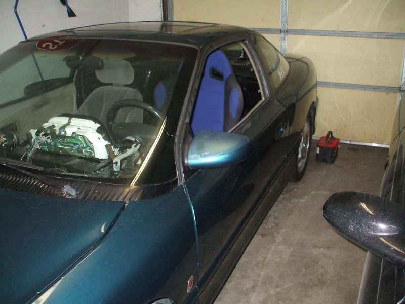

    this is the car

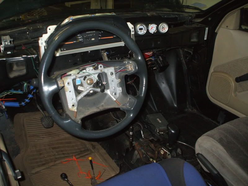

    mostly stock with a shit ton of useless crap removed
    and an ms2v3 running the entire car(well everything that remains lol)

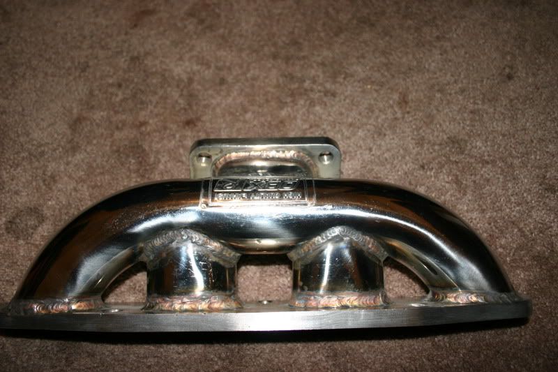

    some of the turbo parts....

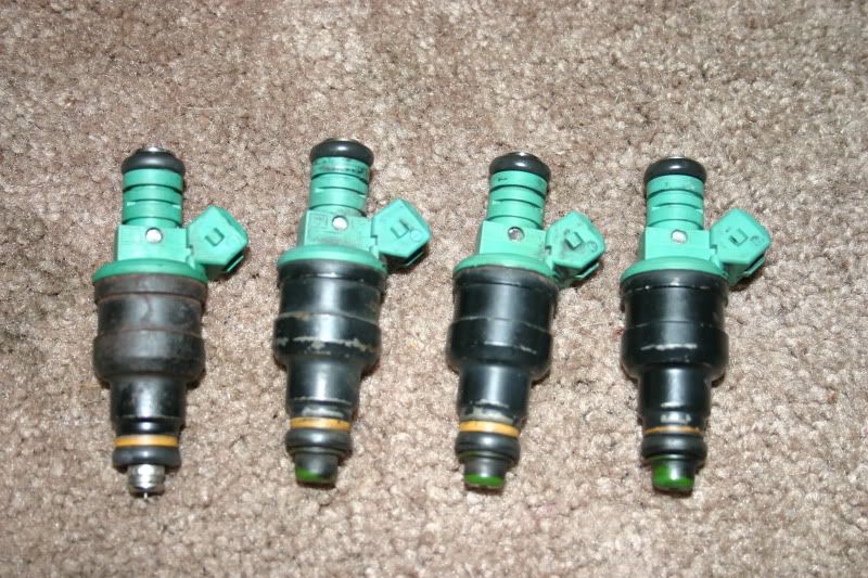

    32lb volvo injectors

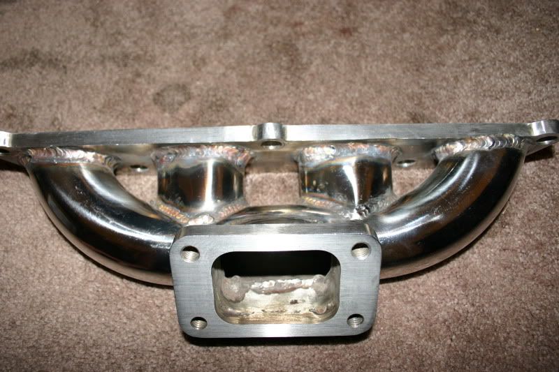

    obx turbo manifold

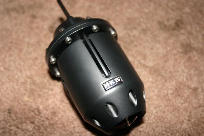

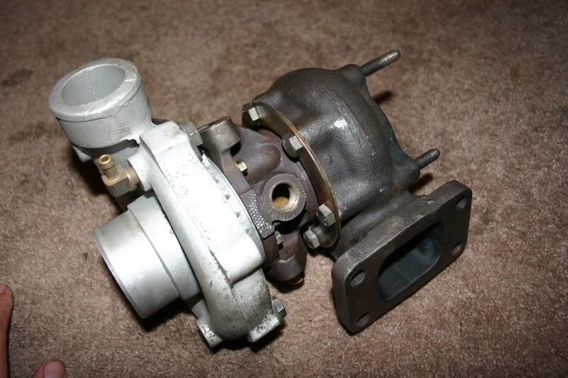

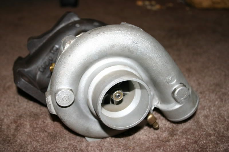

    Saab t3
    HKS blow off valve

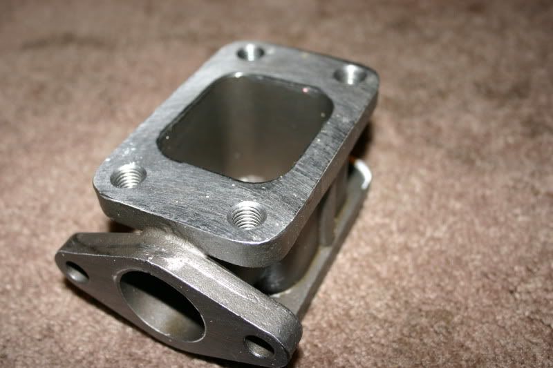

    i dont know if this will fit or not

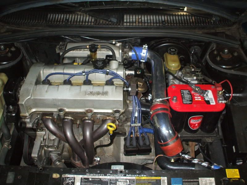

    intercooler mounted....
    and covered.....

      it won't fit. obx and the wastegate adapter with the turbo pushes it to far out and it g into the radiotor. i am using an obx. i cut a hole over port one and weld the flange that comes with the wastegate. mine is still sitting in my garage

          i will be mounting my turbo backwards of what yours is
            Re: jts749's sc2 +turbo
            the turbo will hit the block
              wait i took a sec look at your turbo and you are using a smaller turbo then i am so it might fit
                you were right, it barely hits
                like 5mm from fitting
                well looks like ill be running internal wastegate for a while
                and it probaby is smaller, im not going for a whole lot of power here. Its a garrett t3 .48 turbine .42 compressor from a saab
                  you don't know anyone that can weld the wastegate flange onto the manifold?
                    well ive got a tig welder, but not alot of practice
                    i guess i could give it a try, ill have to go out and buy some stainless tig rods
                      think this will help direct air into the intercooler?
                      welded pipe into oil pan
                        good
                          You aren't going to need to worry about the intercooler getting cold air. It's now blocking your radiator. I would worry about directing air to it. Other than that, it's looking pretty good man. Keep with the updating.
                            looking pretty good. Keep going.
                              its a tube & fin so it shouldnt block airflow too much, plus the car runs really cold all the time
