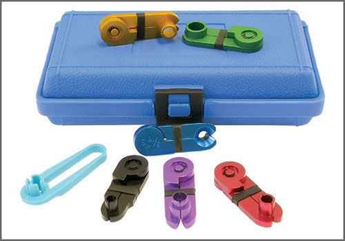

    but i cant get the fuel hose off the fuel rail... haynes says it should bring a plastic tool to slide under from the replacement filter. But i have not seen anything else except the actual filter.

    well if its the plastic lines, you should be able to squeez the little tabs and it should pull right off...lemme try to find a pic. You shouldnt need the tool for the plastic one, but the metals ones. yes
      On my car, one of the fuel lines had the squeeze tabs, but the other line had the click lock type thing. Yes, you need that tool to unhook it. The tool looks like this:

          ive bought the filters for the metal lines from vato zone and it came with the little plastic clip to release the line, if it didnt vato zone has a cheap kit that will work for a couple bucks...is yours a metal or plastic line>?

              no i got it from advance and it didnt come with it, and to make it better i got the wrong size [img]{SMILIES_PATH}/icon_mad.gif[/img]

                      Yeah you gotta get that stupid little tool. When i replaced mine it didt come with the tool either and i had to goto 3 different parts stores to get the damn thing.
                        lol yea finally got it done.... got it in like 10 minutes after i took it out...
