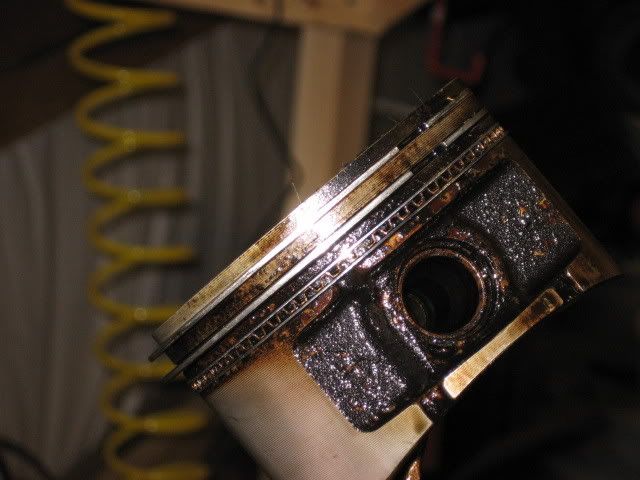

            i have some pics now.
              ok...the rings were coked & the ring gaps were aligned as in the pic above - yeah, that'll allow a bit of oil consumption.
              While you have it apart, drill some oil drain back holes in the oil control groove. Take a look at a forged piston and try to copy the locations for those....that'll cut down on the coking of the rings.
                well, i already cleaned the pistons and put them back in. they wernt allined like that. i had moved them around. i dont want to sound like an idiot, but what does coking mean?
                  coking is burning oil deposites. That's what adheres the rings to the pistons, and plugs up control ring.
                    I hope you got the cylinders honed and got some new rings. Old rings dont really like to be re-used.
