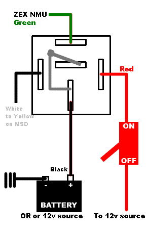

    So during my nitrous install from hell, I encountered an issue.
    Upon connecting my nitrous kit like the diagram provided to me, my car stalls when the arming switch is turned on. The car will just completely die out...then go into some kind of limp mode
    The thing is, this time...the car did not come out of limp mode! So right now I'm stuck with the fuckin car that feels like its riding on 3 cylinders. I'm pretty sure this is ignition related but I have no idea what to check. I've already changed the plugs back to stock, I even tried simply disconnected the battery. No luck, I can't really take this car to the dealer without tearing it apart so I wanna know what else you guys think I can check.
    Right now I'm getting a blinking CEL and it feels like its misfiring pretty bad. What else should I take a look at?
    Makes me just wanna fuckin rip this shit out and never touch this car again [img]{SMILIES_PATH}/icon_twisted.gif[/img]
    [img width=461 height=118]http://i44.tinypic.com/2likitg.png[/img]

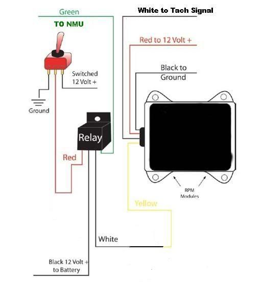

        I just went to AutoZone and I'm throwing a random multiple cylinder misfire code and a TPS code. So I know its definitely related to my nitrous wiring...which I don't understand how this is possible in the first place. How can nitrous wiring between the relay, window switch and NMU effect your cars performance. the only thing that is even touching any existing wiring would be the TPS. Everything else, other than power wires are completely independent of the cars wiring.
        this is currently how I have the Zex kit wired in...
        the only difference is that with the relay I have, it comes with a wiring harness and the white & red wires are swapped.
        so what all should I be checking here, I've already changed plugs, the ignition module appears to be on securely. Don't know what else to look at...

          I have removed all nitrous wiring from the car and it is still misfiring. What could I have possibly damaged due to my wiring?
