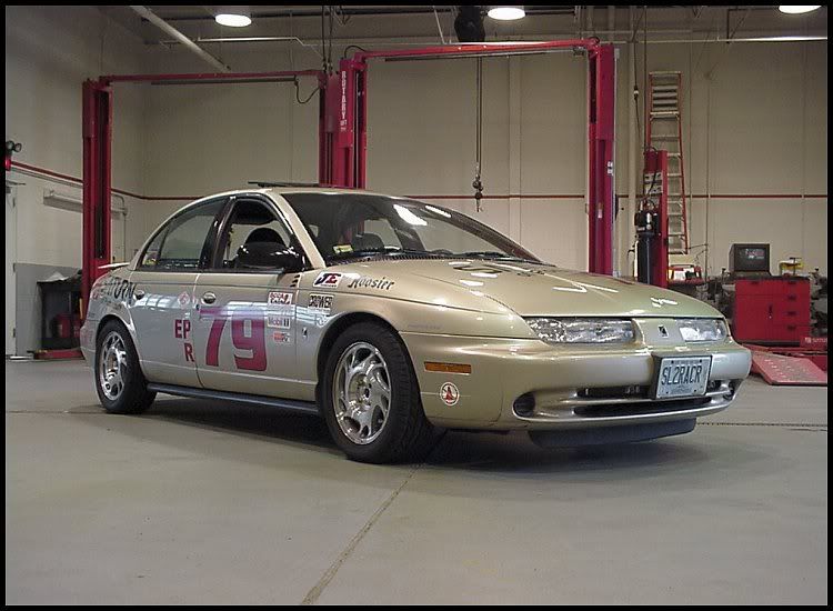

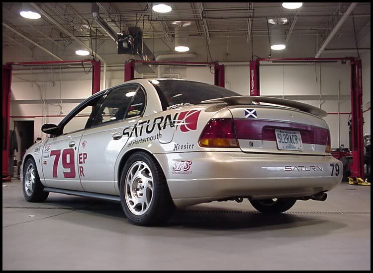

    And the race car in its prime for those curious:
    1.
    2.
    I'm more or less interested in just getting it up and running...
