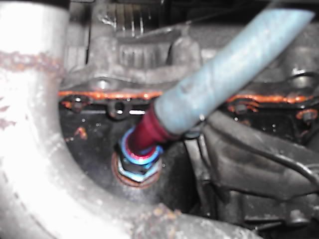

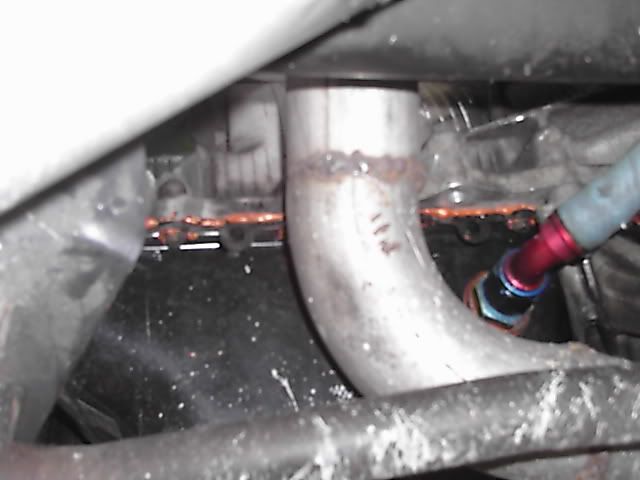

              only posting this cause i just took these pictures yesterday for someone on tsn and this shows a decent height for the drain.
