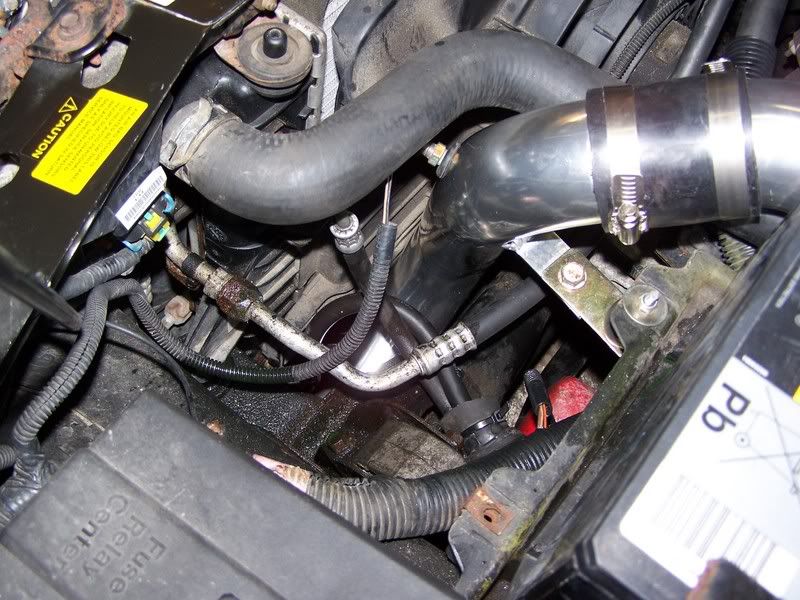

    welp...got a CP CAI for my b-day 3 days after xmas....my dad didnt realize it wont work on an auto....
    so we made it work....

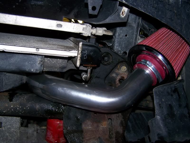

    you can see that instead of going past the crossmember on the engine side...we routed it over to the cooling fan side..you can see where we extended the braket to the battery tray as well

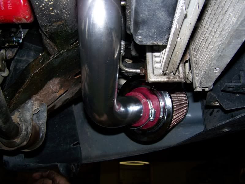

    this is where it comes down
    this is looking straight up at it

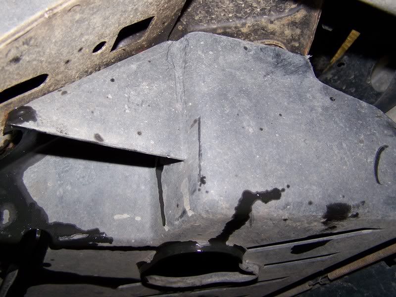

    this is the passenger side of the splash shield(what its suppsed to look like)

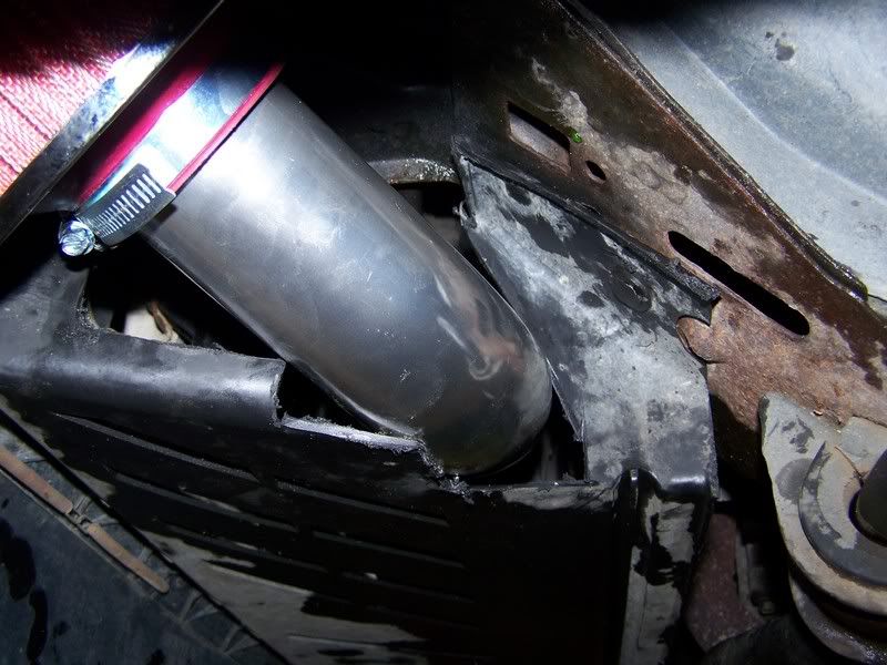

    and this is how much i had to cut away

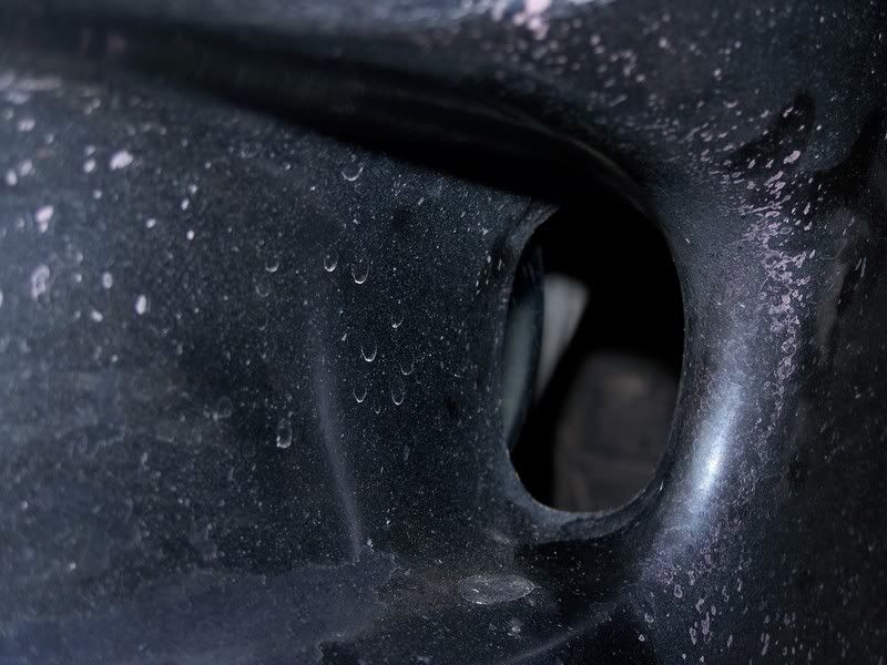

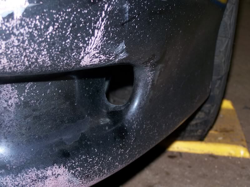

    and this is pretty much where it gets fresh air from...you can barely see the filter in the second shot
    after we cut away enuf stuff to make room i made a sheild so its basicly protected from the spray from the wheel...
    so yeah....fun with intakes
    *EDIT*....it should be of note that i have a 95 and newer style frame cradle..radiator...and cooling fan....and yes it makes a difference...if it wasnt for that it probly wouldnt have worked

      yeah but i made it wrk with a legit saturn one...lol...and there was n hacking or cutting...so on the off chance i get a stick....it will be a direct transfer

                trust me it does.....im gonna get a bypass valve when i get more cash and make a better sheild for it
