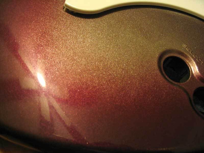

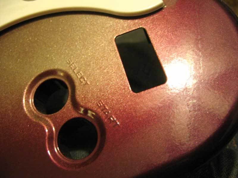

                      you can use dupicolor and have a good turnout. I have a perfect example too. normally you'll get an orange peel texture to a clear coat. especially bad with rattle can but it can be remedied with color sanding. thats where you take a high grit sandpaper like 1500-2000. 1000 if you have really bad orange peel and have plenty of clear to work with. then you buff it and polish it out.
                      Here is a guitar hero controller I was working on. same clear coat just the first picture is before the color sanding and polishing.
