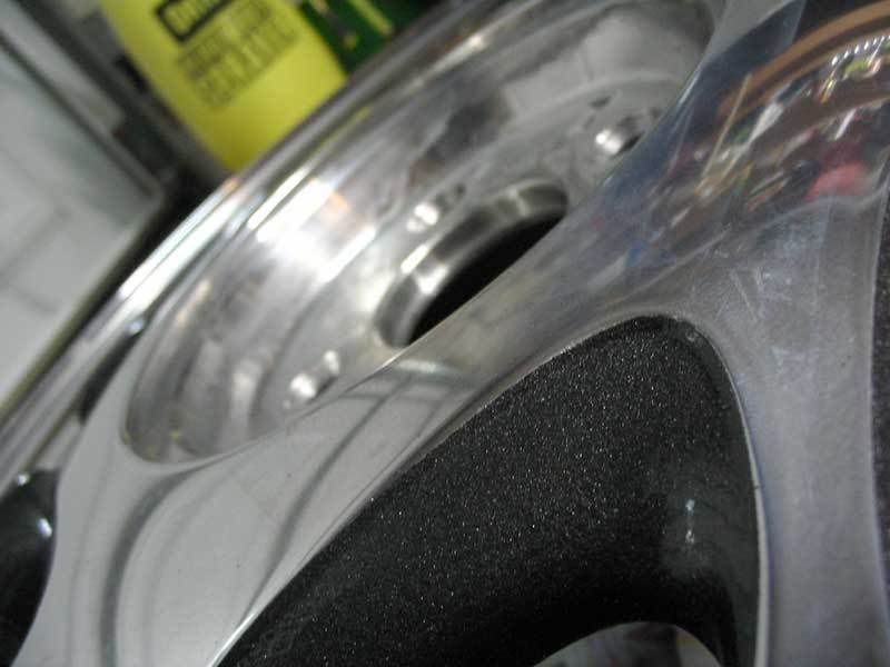

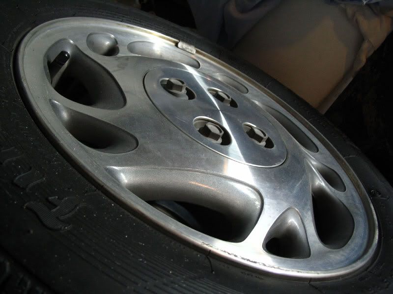

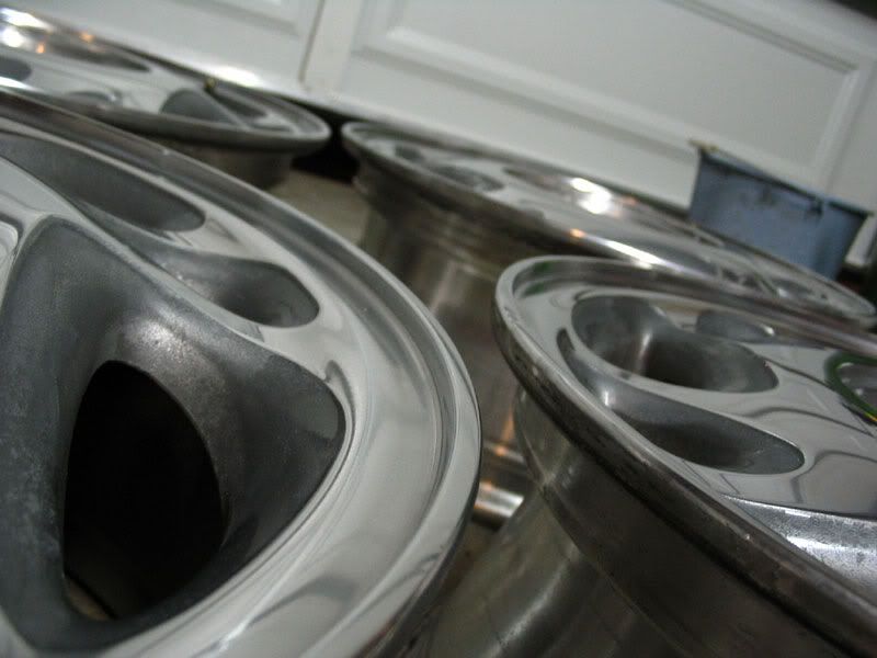

    This is a simple but time comsuming DIY wheel polishing project that I did with my saturn. Just took some stock aluminum alloys, stripped the paint on them, sanded out the factory swirl texture with 600 and then 800 on a d/a, wet sanded with 1000, 1500, and 2000, then polished them with mother's power ball and aluminum polish, hand polished with mother's aluminum/mag polish, and finished it off with mother's billet polish. Then I painted the holes with a base coat of black and a light mist of a dark charcoal metallic. The project took me about a week spending an hour or two per day to finish and turned out fantastic.
    stock finish:

    fully polished:

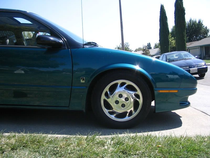

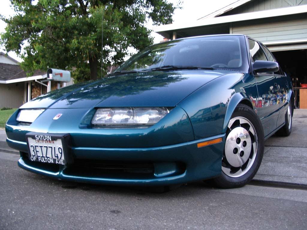

    mounted:

                            I've gotta say, looking at that picture... your car looks mint!
